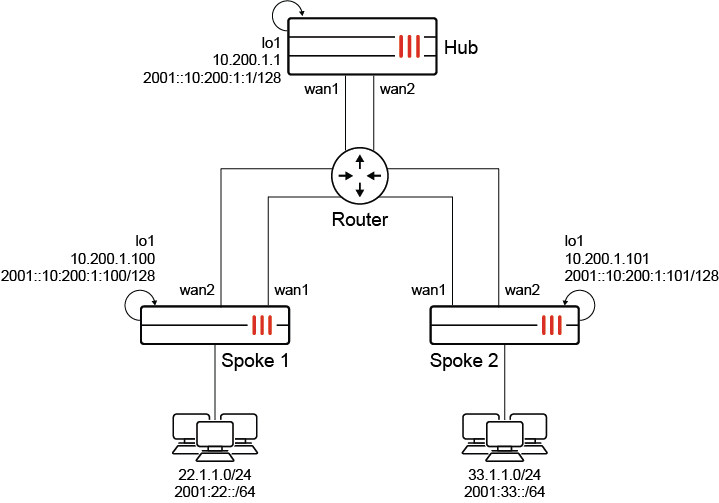

Example
This example configuration contains the following structure:
Use SD-WAN member 1 (via ISP1) and its dynamic shortcuts for Financial Department traffic.
Use SD-WAN member 2 (via ISP2) and its dynamic shortcuts for Engineering Department traffic.
Internal subnets of Spoke 1:
IPv4: 22.1.1.0/24
IPv6: 2001:22::/64
Internal subnets of Spoke 2:
IPv4: 33.1.1.0/24
Financial Department: 33.1.1.1 to 33.1.1.100
Engineering Department: 33.1.1.101 to 33.1.1.200
IPv6: 2001:33::/64
Financial Department: 2001:33::1 to 2001:33::100
Engineering Department: 2001:33::101 to 2001:33::200

Because route reflection has been disabled in this example, initially, Spoke 1 will not know the local subnet of Spoke 2, and Spoke 2 will not know the local subnet of Spoke 1. Therefore, for traffic routing, summary routes are configured on the hub as blackhole routes and then advertised to the spokes using BGP.
For example, for traffic from the local subnet of Spoke 2 destined for the local subnet of Spoke 1:
- For the IPv4 case, the summary route 22.0.0.0/8, which includes the local subnet of Spoke 1 (22.1.1.0/24), is advertised to Spoke 2. When Spoke 2 sends traffic destined for 22.1.1.0/24 to the Hub, the Hub forwards this traffic to Spoke 1 since they are BGP neighbors.
- For the IPv6 case, the summary route 2001:22::/32, which includes the local subnet of Spoke 1 (2001:22::/64), is advertised to Spoke 2. When Spoke 2 sends traffic destined for 2001:22::/64 to the Hub, the Hub forwards this traffic to Spoke 1 since they are BGP neighbors.
