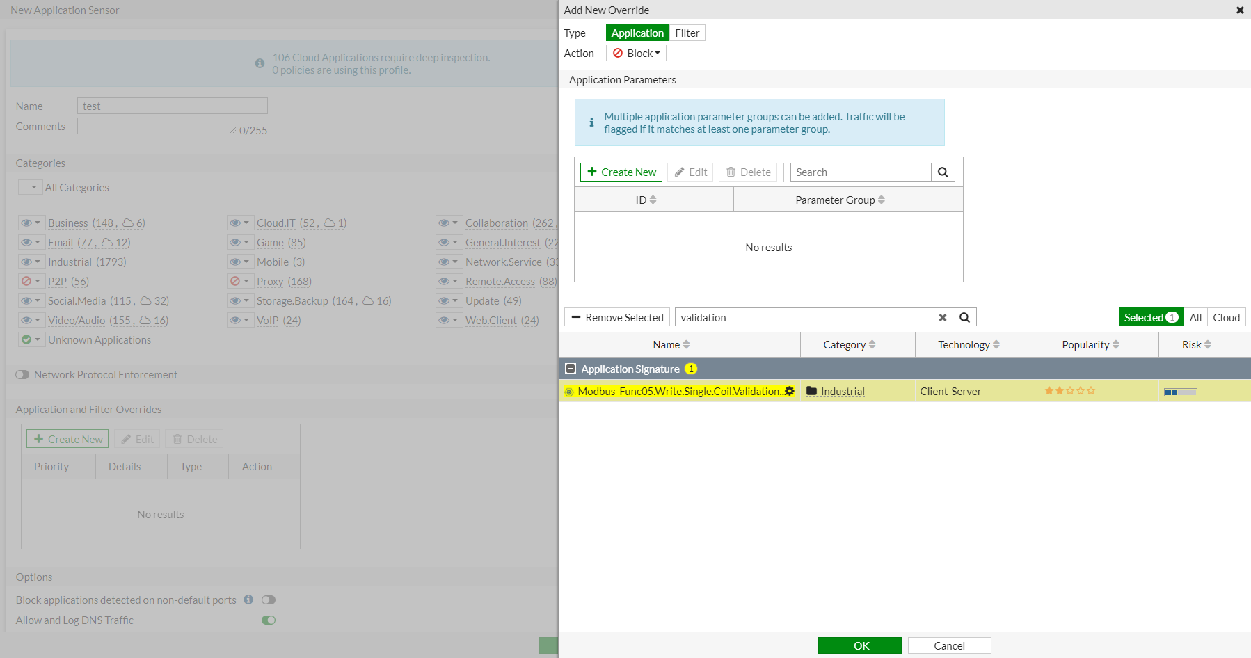

To configure an application sensor with multiple parameters in the GUI:
- Go to Security Profiles > Application Control and click Create New, or edit an existing sensor.

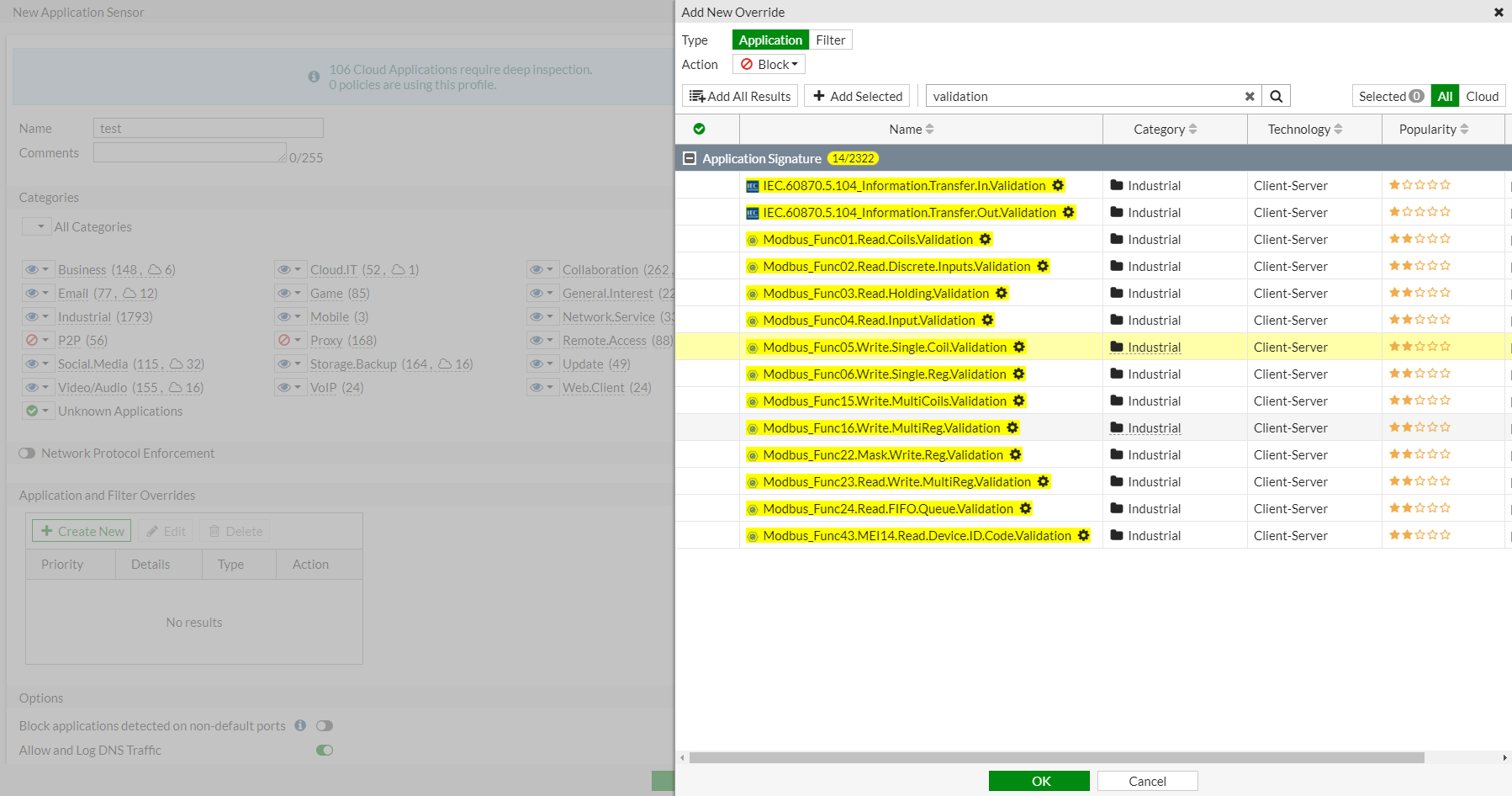

- In the Application and Filter Overrides table, click Create New.
- Search for Modbus_Func05.Write.Single.Coil.Validation and press
Enter. A gear icon beside the signature name indicates it has configurable application parameters. - In the search results, select Modbus_Func05.Write.Single.Coil.Validation and click Add Selected.

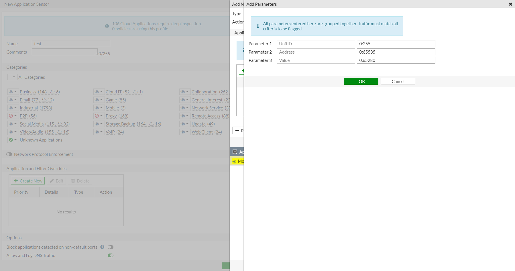

- Click the Selected tab. In the Application Parameters section, click Create New.
- Edit the parameter values as needed.
- Click OK.
