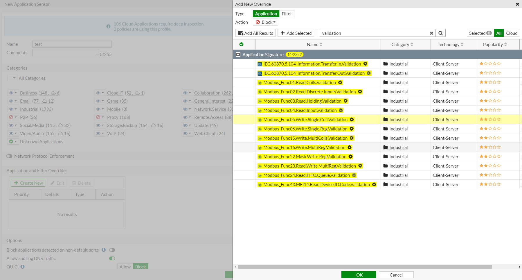

Go to Security Profiles > Application Control and click Create New, or edit an existing sensor.
In the Application and Filter Overrides table, click Create New.
Search for Modbus_Func05.Write.Single.Coil.Validation and press
Enter. A gear icon beside the signature name indicates it has configurable application parameters. -
In the search results, select Modbus_Func05.Write.Single.Coil.Validation and click Add Selected.

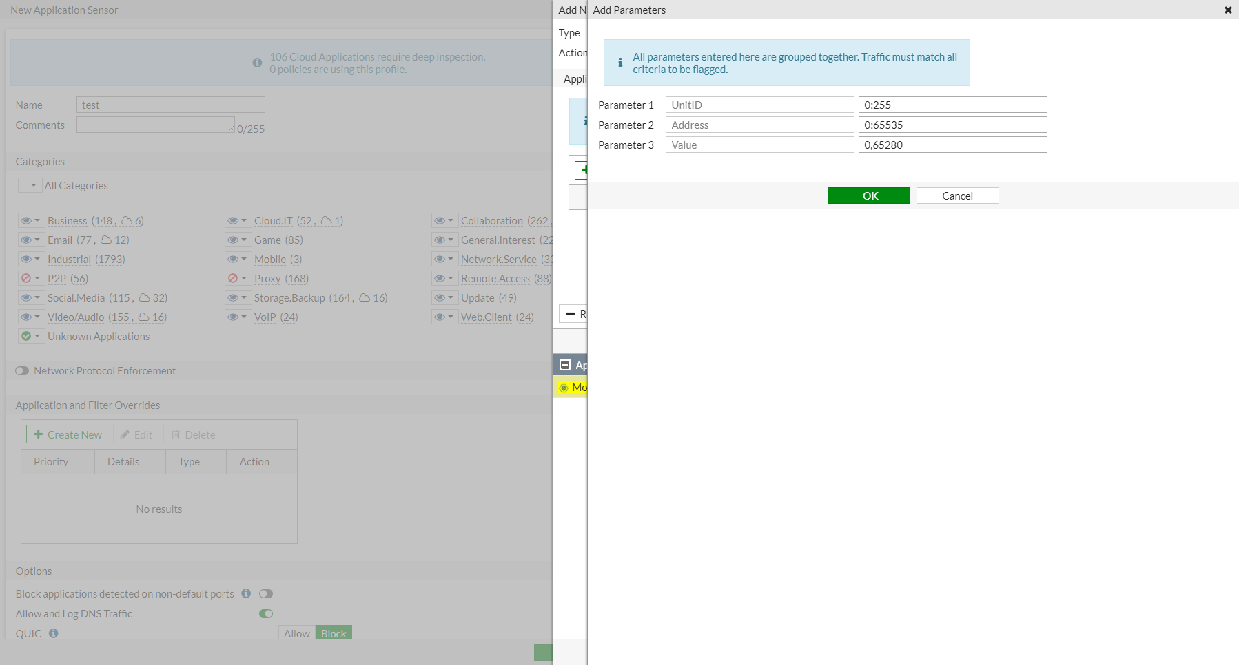

Click the Selected tab. In the Application Parameters section, click Create New.
Edit the parameter values as needed.
Click OK.
