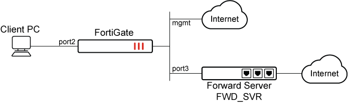

In the following example, a forward server is applied to the FortiGate in an explicit proxy policy. An interface that is not in the policy, such as port3, can be specified to forward traffic.
Without this feature, the FortiGate would have to forward traffic through the management interface which is the destination interface of the policy.
This example uses the following topology:

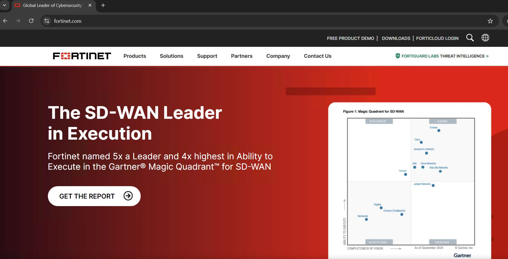

  4. Access a website in the browser, such as www.fortinet.com.

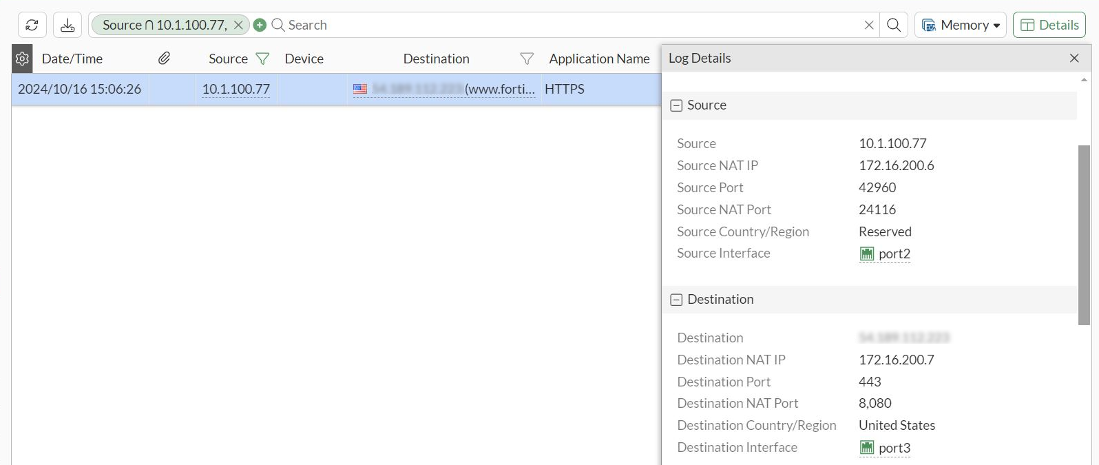

  5. Go to Log & Report > Forward Traffic and review the traffic log. The Destination Interface is port3 instead of the management interface.
