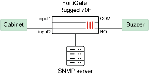

In this example, a FortiGate Rugged 70F is configured to monitor the open/close status of a cabinet door, and the output is connected to a buzzer. An automation stitch and SNMP trap are also configured.
When the status of the cabinet door changes from open to closed or closed to open, FortiGate triggers the buzzer, automation stitch, and SNMP trap. A system event is also logged when SNMP traps are sent.

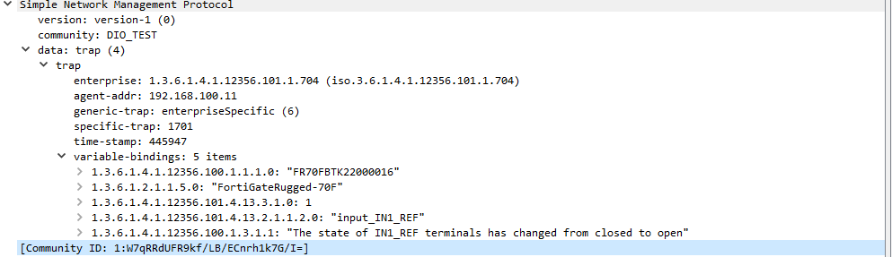

When the cabinet door being monitored by the DIO module opens unexpectedly, it triggers an SNMP event:
It also triggers a system log:
9: date=2024-11-18 time=17:26:13 eventtime=1731979573581176380 tz="-0800" logid="0100022907" type="event" subtype="system" level="notice" vd="root" logdesc="Digital-IO input state change" connector="input_IN1_REF" mode="default" state="open" msg="The state of IN1_REF terminals has changed from closed to open"
