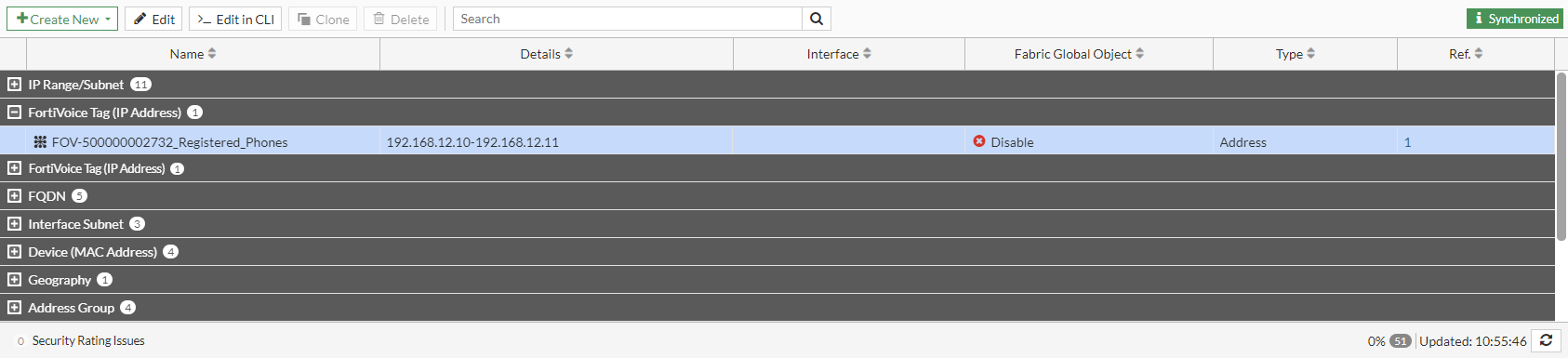

Go to Policy & Objects > Addresses to view the newly created dynamic firewall address objects:
Expand the FortiVoice Tag (IP Address) section.
There is one entry, FOV-500000002732_Registered_Phones, which matches 192.168.12.10 to 192.168.12.11.

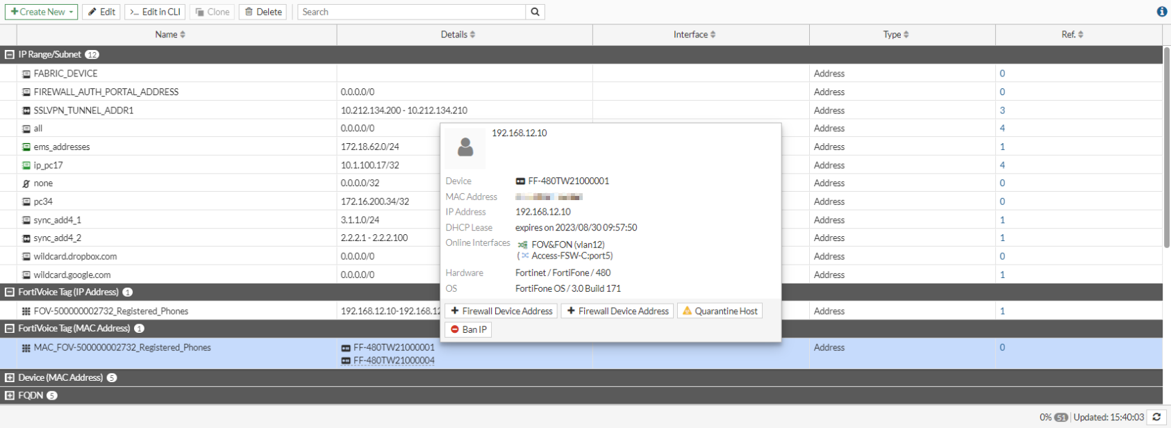

Expand the FortiVoice Tag (MAC Address) section. There is one entry, MAC_FOV-500000002732_Registered_Phones, which matches two devices. Hover over the device serial number to view the tooltip that contains the MAC address and additional information.

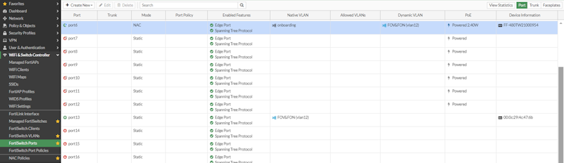

Enable NAC mode on the desired FortiSwitch ports (port6 in this example):
Go to WiFi & Switch Controller > FortiSwitch Ports.
Select port6, then right-click and set the Mode to NAC.

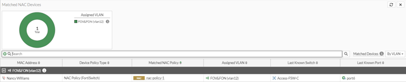

Generate traffic from the FortiFone.
Once the NAC policy is matched, go to WiFi & Switch Controller > NAC Policies to view the device matched to the policy.
FortiFone is also shown on Dashboards > Assets & Identities in the Matched NAC Devices widget.
Go to WiFi & Switch Controller > FortiSwitch Ports and locate the port that the FortiFone is connected to. The port has been dynamically assigned vlan12.
