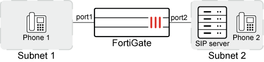

In this example, Phone 1 is in Subnet 1, and the SIP server and Phone 2 are in Subnet 2. All SIP signaling messages and RTP/RTCP packets go through the SIP server. The RTP/RTCP ports on Phone 1 are configured as 17078/17079.
The FortiGate administrator wants to use NAT for the port 17078/17079 to 30000/30001. If Phone 1 and Phone 2 are registered to the SIP server, and they establish a call session between them through the FortiGate and the SIP server, then the RTP/RTCP ports 17078/17079 of Phone 1 will be translated to ports 30000/30001. All RTP/RTCP packets going out of port2 have source ports of 30000/30001, and all RTP/RTCP packets going into port2 also have destination ports of 30000/30001.
