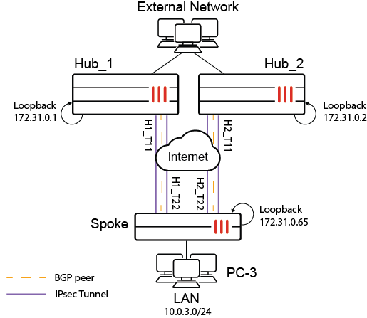

In the following example, the spoke FortiGate has four tunnels: two tunnels to Hub_1 and two tunnels to Hub_2. The spoke has two BGP neighbors: one to Hub_1 and one to Hub-2. BGP neighbors are established on loopback IPs.
The SD-WAN neighbor plus route-map-out-preferableconfiguration is deployed on the spoke to achieve the following:
- If any tunnel to Hub_1 or Hub_2 is in SLA, the preferable route map will be applied on the BGP neighbor to Hub_1 or Hub_2.
- If both tunnels to Hub_1 or Hub_2 are out of SLA, the default route map will be applied on the BGP neighbor to Hub_1 or Hub_2.
The preferable route map and default route map are used to set different custom BGP communities as the spoke advertises its LAN routes to the hub. Each hub can translate communities into different BGP MED or AS prepends and signal them to the external peers to manipulate inbound traffic, thereby routing traffic to the spoke only when the SLAs are met on at least one of two VPN overlays. In this example, community string 10:1 signals to the neighbor that SLAs are met, and 10:2 signals that SLAs are not met.
