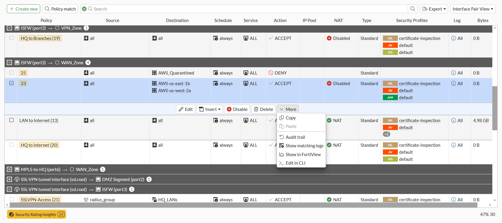

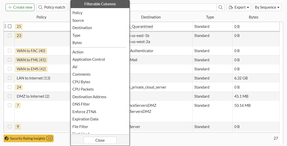

Configurations in the GUI
Firewall policies can be created in the GUI by configuring the necessary parameters.

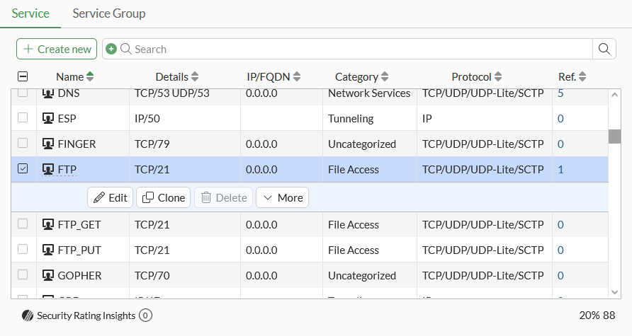

Service
The services chosen represent the TCP/IP suite port numbers that will most commonly be used to transport the named protocols or groups of protocols. This is different than Application Control which looks more closely at the packets to determine the actual protocol used to create them.
A case where either side can initiate the communication, like between two internal interfaces on the FortiGate unit, would be a more likely situation to require a policy for each direction.

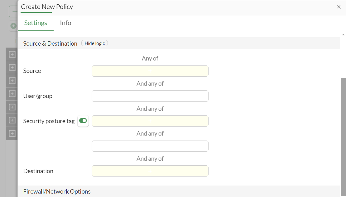

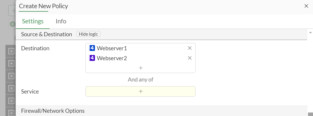

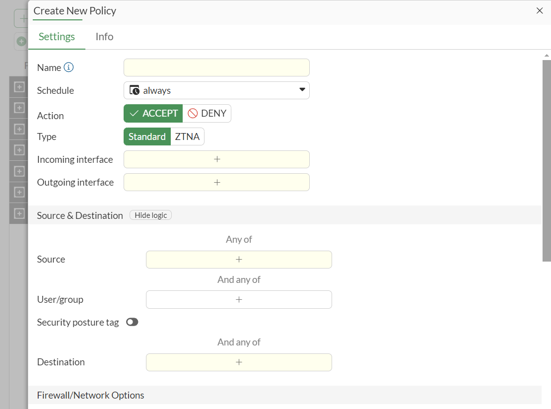

Displaying logic between firewall policy objects in the GUI
The FortiOS GUI can display the logical AND relationship in firewall policies between source and destination objects, including security posture tags when enabled, to help you configure firewall policies.
To display the logic in firewall policies in the GUI:
  1. Go to Policy & Objects > Firewall Policy, and click Create New. The Create New Policy pane opens.
  2. In the Source & Destination section, click Show Logic.
    • The labels Any of and And any of appear to clarify how the objects are used to match traffic. The And any of label indicates a logical AND relationship between the objects.

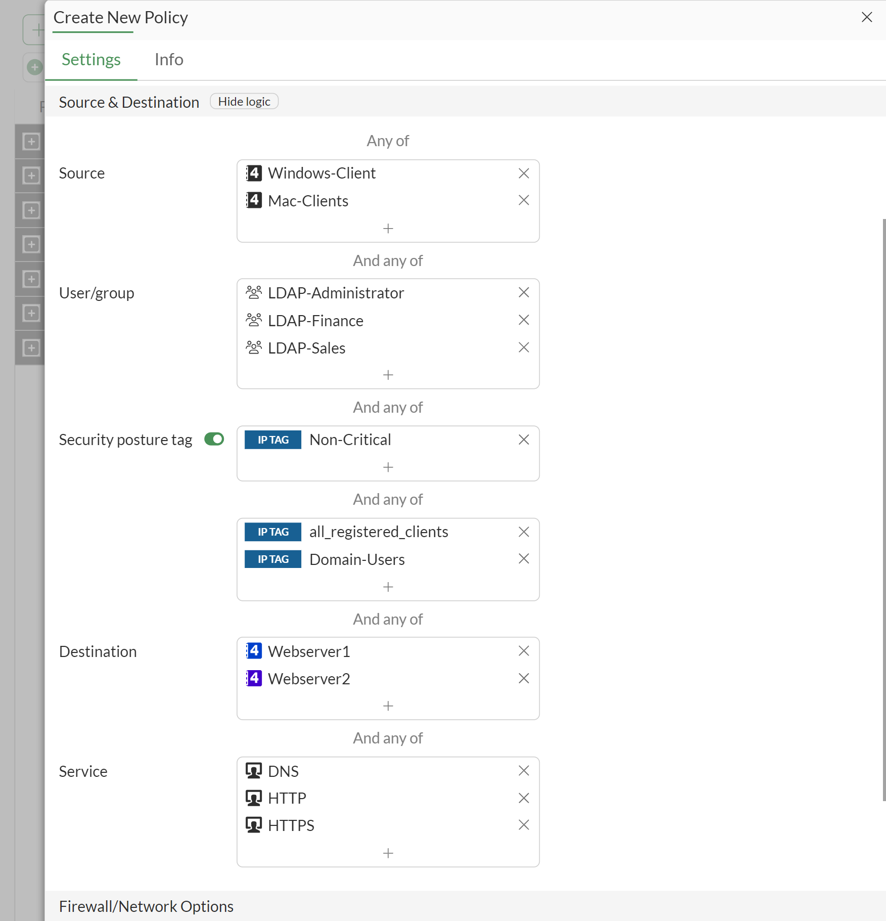

  3. Enable Security posture tag:
    • The labels And any of appear, indicating a logical AND relationship between the two security posture tag objects.
    • The first security posture tag group is required when Security posture tag is enabled and is considered the primary tag group.
    • A second security posture tag group is optional when Security posture tag is enabled and is considered the secondary tag group.
    • Within each of the tag groups, there is a logical OR relationship between the tags when multiple tags are used.
  4. In the Destination list, select one or more destinations to display And any of between the Destination and Service fields.
Following is the logic of using the mandatory and optional fields in the Source & Destination section, based on the following configurations:
Traffic must match all criteria below:
  • Any Source: either Windows-Client OR Mac-Clients
  • Any User/group: either LDAP-Administrator, LDAP-Finance, OR LDAP-Sales
  • The primary Security posture tag: Non-Critical
  • Any secondary security posture tags: either all_registered_clients OR Domain-Users
  • Any Destination: either Webserver1 OR Webserver2
  • Any Service: Either DNS, HTTP, OR HTTPS

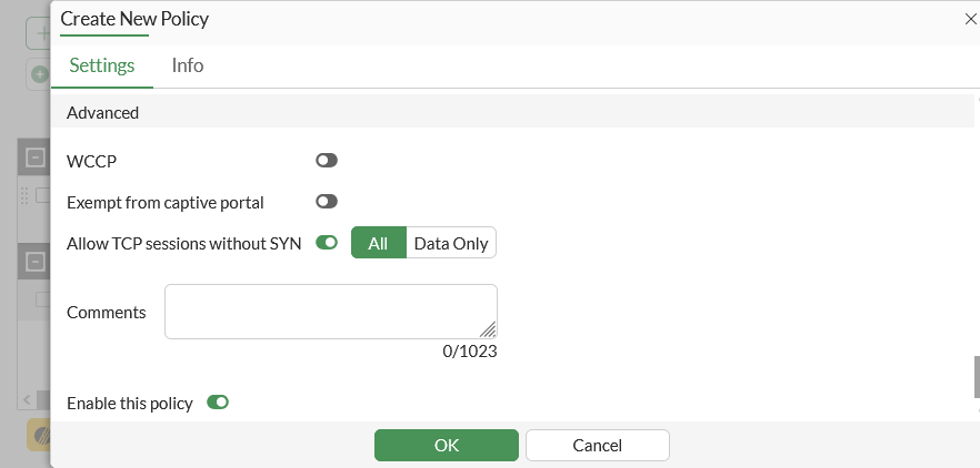

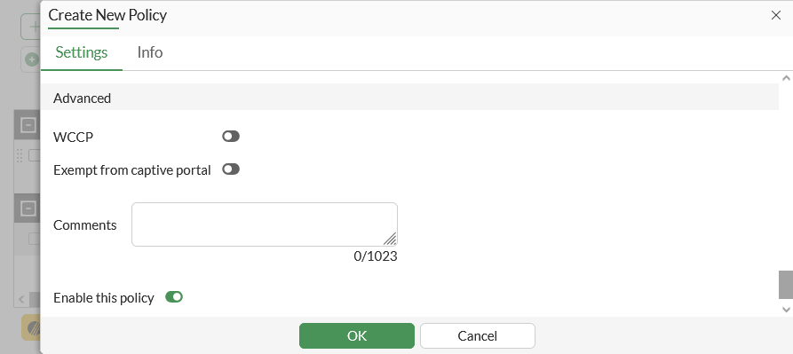

Enabling advanced policy options in the GUI
Advanced policy options can be enabled so that you can configure the options in the GUI.
To enable advanced policy options:
config system settings
    set gui-advanced-policy enable
Advanced policy options are now available when creating or editing a policy in the GUI:
To enable configuring TCP sessions without SYN:
    set tcp-session-without-syn enable
TCP sessions without SYN can now be configured when creating or editing a policy in the GUI:

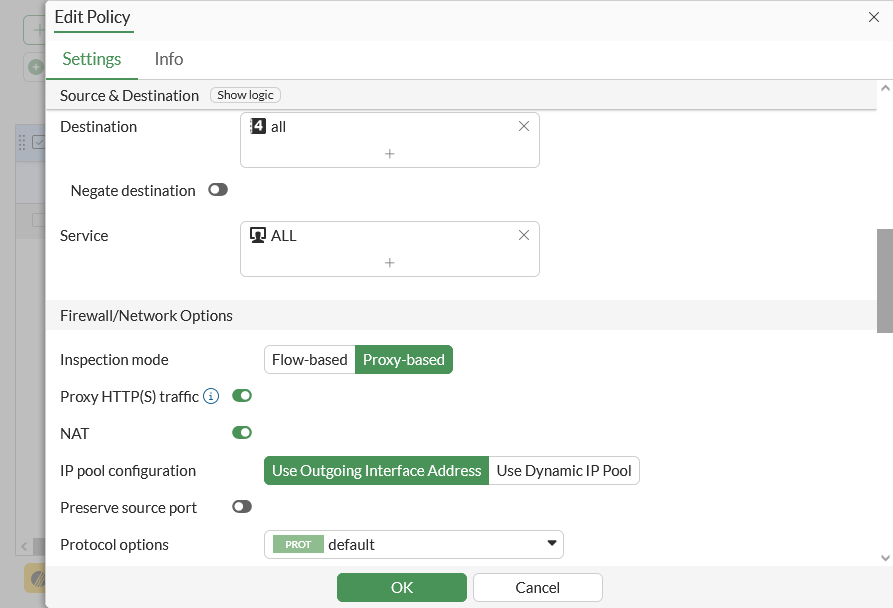

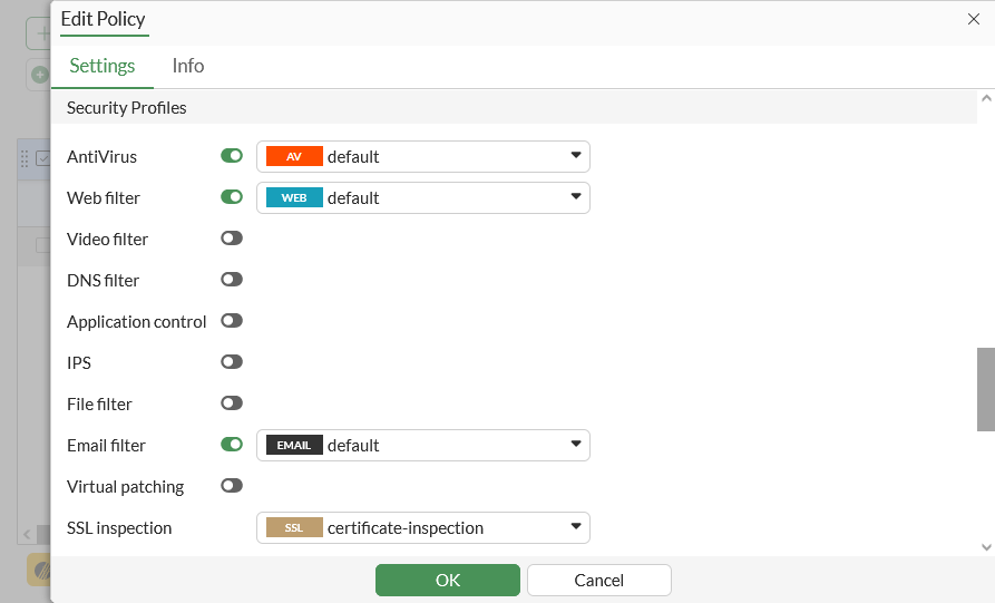

Inspection mode per policy
When configuring a firewall policy, you can select a Flow-based or Proxy-basedInspection Mode. The default setting is Flow-based.
To configure inspection mode in a policy:
  2. Create a new policy, or edit an existing policy.
  3. Configure the policy as needed.
    1. If you change the Inspection Mode to Proxy-based, the Proxy HTTP(S) traffic option displays.
    2. In the Security Profiles section, if no security profiles are enabled, the default SSL Inspection is no-inspection. If you enable any security profile, the SSL Inspection should be changed certificate-inspection, deep-inspection, or a custom inspection profile.
To see the inspection mode changes using the CLI:
config firewall policy
        set srcintf "wan2"
        set dstintf "wan1"
        set srcaddr "all"
        set dstaddr "all"
        set service "ALL"
        set inspection-mode proxy
        set nat enable
To see the HTTP and SSH policy redirect settings when inspection mode is set to proxy using the CLI:
        set srcintf "wan2"
        set dstintf "wan1"
        set srcaddr "all"
        set dstaddr "all"
        set service "ALL"
        set http-policy-redirect enable
        set ssh-policy-redirect enable
        set nat enable
To see the default SSL-SSH policy set to no inspection using the CLI:
       show fu | grep ssl-ssh-profile
        set ssl-ssh-profile "no-inspection"

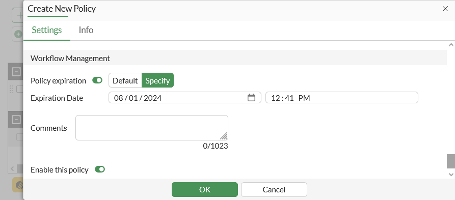

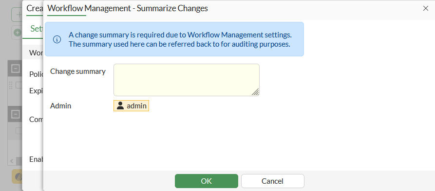

Add Policy change summary and Policy expiration to Workflow Management
Two options, Policy change summary and Policy expiration, are included in Workflow Management. Policy change summary enforces an audit trail for changes to firewall policies. Policy expiration allows administrators to set a date for the firewall policy to be disabled.
There are three states for the Policy change summary:
  • Disable: users will not be prompted to add a summary when editing a policy.
  • Required: the Policy change summary will be enabled and will require users to add a summary when editing or creating a firewall policy.
  • Optional: the Policy change summary will be enabled but users can leave the summary empty, if preferred, when editing or creating a firewall policy.
There are three states for Policy expiration:
  • Disable: the firewall policy will not expire. This is the default setting for Policy expiration.
  • Default: the firewall policy will expire after the default number of days.
  • Specify: the firewall policy will expire at a set date and time.
The default value for Policy expiration is 30 days. This number can be changed in the CLI or in System > Settings in the GUI to any value between zero and 365 days. If the default value is set to zero, the Default state will disable the Policy expiration.
To configure the firewall policy change summary and default expiration in the GUI:
  1. Go to System > Feature Visibility.
  2. Enable Workflow Management.
  3. Click Apply.
  4. Go to System > Settings.
  5. In the Workflow Management section, set Policy change summary to Required. Policies expire by default is enabled by default with an Expire after value of 30.
  6. Click Apply.
To configure firewall policy expiration in the GUI:
  2. Name the policy and configure the necessary parameters.
  3. Set Policy expiration to Specify.
  4. Select the date and time for the policy to expire from the Expiration date fields.
  5. Click OK. The Workflow Management - Summarize Changes pane opens.
  6. In the Change summary field, enter details about the changes made to the policy. These details can be referred to later for auditing purposes.
  7. Click OK.

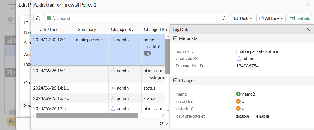

Policy change summaries are used to track changes made to a firewall policy. The Audit Trail allow users to review the policy change summaries, including the date and time of the change and which user made the change.
The Audit Trail is only supported by FortiGate models with disk logging.
To review the audit trail in the GUI:
  2. Select the policy you want to review and click Edit.
  3. In the right-side banner (or on the Info tab if shown), click Audit Trail. The Audit trail for Firewall Policy pane opens and displays the policy change summaries for the selected policy.
  4. Select an entry to review the details of the change made.
  5. When you are done reviewing the Audit Trail, click Close.
  6. Click Cancel to exit the Edit Policy page.
Configurations in the CLI
Firewall policies can be created in the CLI by configuring the necessary parameters. See Configurations in the GUI for more information on the various parameters.

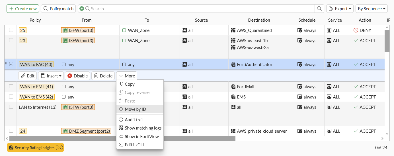

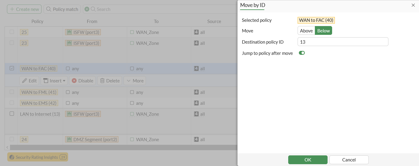

Policy views
In Policy & Objects policy list pages, there are three policy views: Interface Pair View, Sequence Grouping View, and By Sequence. For large policy tables (thousands of policies), the By Sequence view will load the fastest.
Interface Pair View displays the policies in the order that they are checked for matching traffic, grouped by the pairs of incoming and outgoing interfaces in collapsible sections. The Interface Pair View can be used when a policy is configured with multiple interfaces. Right-click on any pair name and click Expand All or Collapse All to expand or collapse all of the pairs.
When a policy is inserted, the Incoming and Outgoing interfaces are automatically filled in, and you can confirm the location of the new policy in the right-side gutter before clicking OK to insert the policy.
When a single policy is selected, an inline menu opens below the row. The More dropdown menu includes the same expanded list of options that are available in the right-click menu. When multiple policies are selected, the top menu bar changes to show buttons that are applicable to the multiple selections and you can click View selected to show only the selected policies on the page.
By Sequence displays policies in the order that they are checked for matching traffic without any grouping.
Policies can then be moved by their policy ID before or after another specified policy ID.
Moving policies by ID is only available when viewing the Firewall Policy page in By Sequence or Sequence Grouping View.
To move a policy by policy ID:
  2. Select the policy you want to move.
  3. Select More > Move by ID.
    The Move by ID pane is displayed.
  4. Define the new location of the policy:
    1. Select whether the policy should be moved Above or Below the policy ID you will define in the next step.
    2. In the Destination policy ID field, enter the ID of the destination policy or select it from the dropdown menu.
  5. If you do not want to automatically view the new location of the policy, disable Jump to policy after move. This feature is enabled by default.
  6. Click OK.
    If Workflow Management is enabled in System > Feature Visibility, the Workflow Management - Summarize Changes pane is displayed. Enter a Change summary then click OK to continue.
    The policy will be moved to the new location.

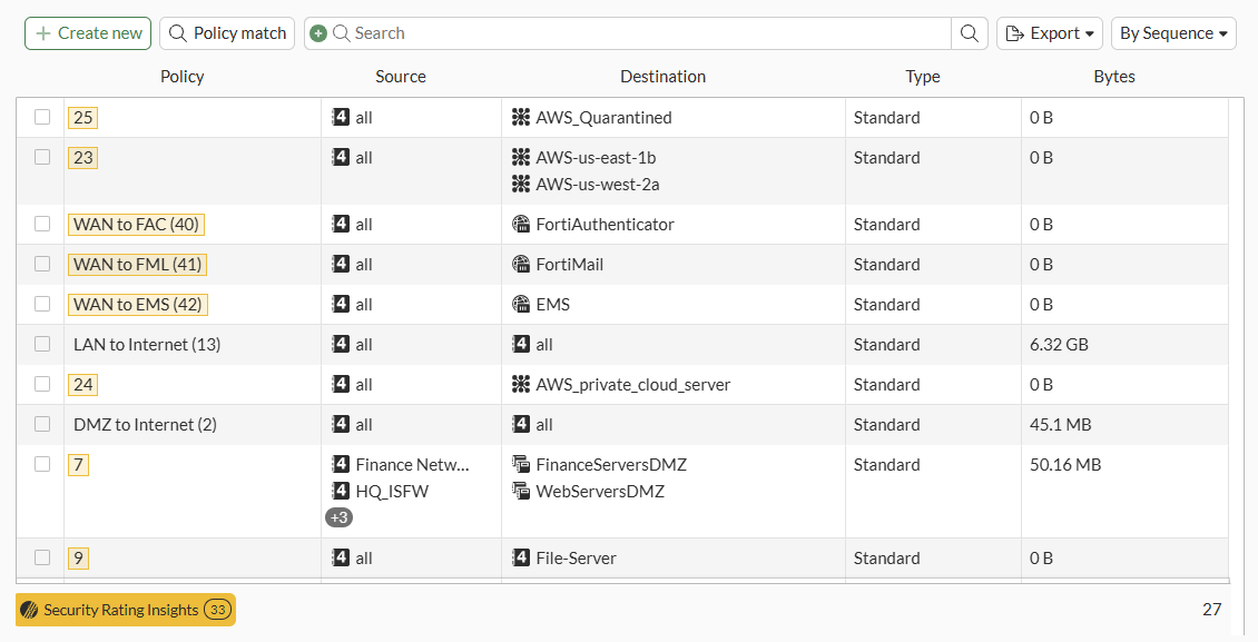

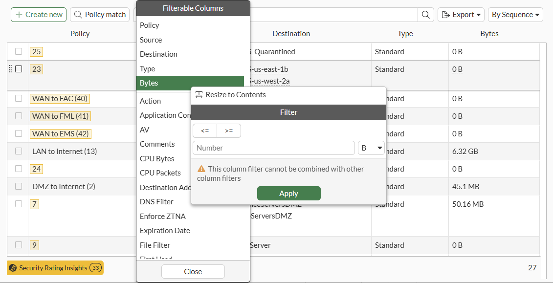

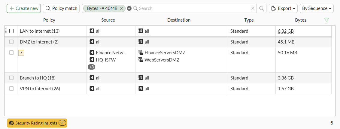

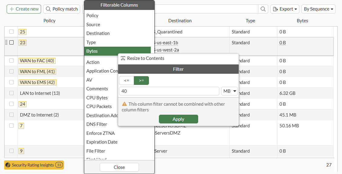

Filtering on policy list statistics
Statistics filtering on mutable policy lists allows users to refine policies based on key metrics such as Bytes, Packets, Hit Count, and Last Used. Statistics filters have been implemented in the Firewall Policy, SSL Inspection & Authentication Policy, and Security Policy pages. However, the available filters differ depending on the page.
This provides more precise control for identifying high-impact or frequently used policies, improving efficiency in policy management and troubleshooting.
The following example demonstrates filtering the firewall policies table so that only policies with traffic greater than or equal to 40 MB are displayed.
To filter the policy list based on policy statistics:
  2. In the Search field, select the +. The Filterable Columns list is displayed.
  3. Select Bytes. A filter definitions dialog is displayed.
  4. Define the filter parameters:
    1. Select >= to define the parameter range.
    2. Enter 40 into the value field.
    3. Select the unit dropdown list and select MB.
  5. Click Apply. The filter parameters will be applied to the table.

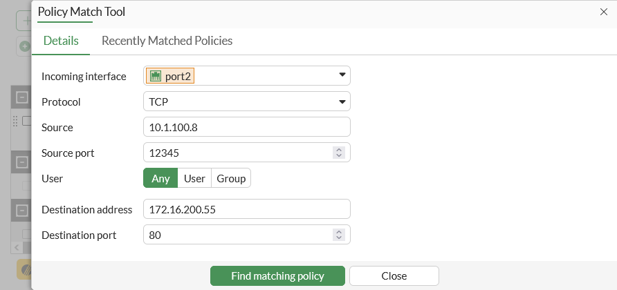

Policy match
Firewall policy match is based on the Source_interfaces/Protocol/Source_Address/Destination_Address that matches the source-port and dst-port of the protocol. Use this tool to find out which policy matches specific traffic from a number of policies. After completing the match, the matching firewall policy is highlighted on the policy list page.
The Policy match tool has the following requirements:
  • Transparent mode does not support policy match function.
  • When executing the policy match, you need to confirm whether the relevant route required for the policy work already exists.
Sample configuration
This example uses the TCP protocol to show how policy match works:
  1. On a Policy & Objects policy list page, click Policy match and enter the traffic parameters.
  2. Click Find matching policy to display the policy match results.

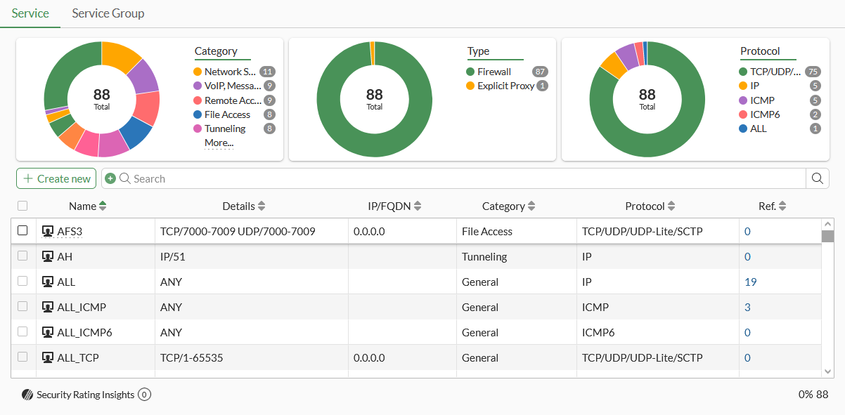

Services
Services represent typical traffic types and application packets that pass through the FortiGate. Services include the service protocol type (TCP, UDP, ICMP, and so on), address, category, and logical destination port. Services can then be applied in a firewall policy to represent the TCP/IP suite port numbers that will most commonly be used to transport the named protocols or groups of protocols. Likewise, security profiles use service definitions to match session types.
The following services are available:
Predefined services
Firewall policies can be configured with default, predefined services that have been created for common traffic types. Predefined services can be edited, cloned, and deleted from the Policy & Objects > Services list. Cloning a services allows you to create a copy of the service parameters and edit it to create a similar service while still maintaining the existing service.

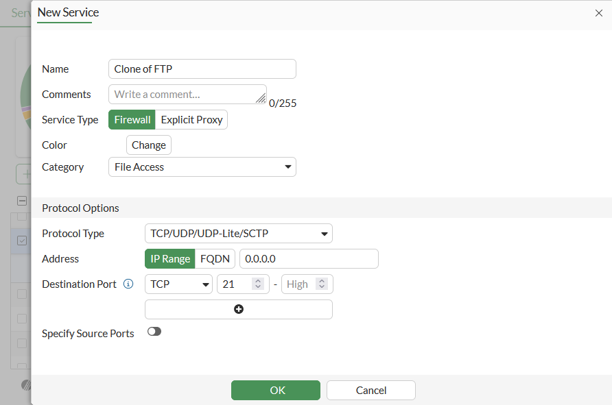

To clone a service:
  1. Go to Policy & Objects > Services.
  2. Go to the Services tab.
  3. Select the service you want to clone.
  4. Click Clone. The New Service page is displayed.
  5. Edit the service details as needed.
  6. Click OK.

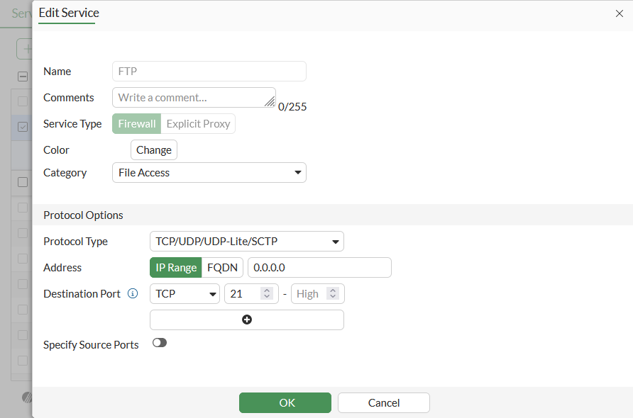

To edit a service:
  2. Go to the Services tab and select the service that you need to edit.
  3. Click Edit. The Edit Service page is displayed.
  4. Edit the service details as needed.
  5. Click OK.

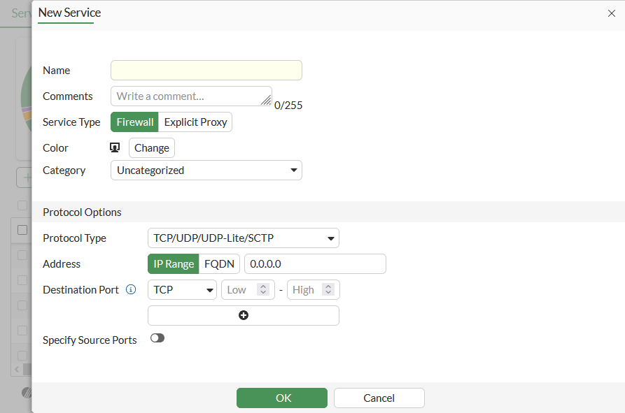

Custom services
You can create new, customized services in the Policy & Objects > Services page and the CLI. When creating a custom service, the ports, IP addresses, and protocols must be known for proper configuration. Once a service has been created, it must be applied to a firewall policy to take effect.
Custom services can also be created while configuring a new firewall policy.
To configure a custom service in the GUI:
  2. Go to the Services tab and click Create new.
  3. Configure the service parameters as needed.
  4. Click OK.
Custom services can be configured in the CLI for TCP/UDP/UDP-Lite/SCTP, ICMP, ICMP6, and IP protocols. Service parameters are dependent on the protocol type. See config firewall service custom in the CLI Reference guide for more information.
To configure a custom service in the CLI:
    edit <name>
        set protocol TCP/UDP/UDP-Lite/SCTP
        set tcp-portrange <destination port range>
        set udp-portrange <destination port range>
        set udplite-portrange <destination port range>
        set sctp-portrange <destination port range>

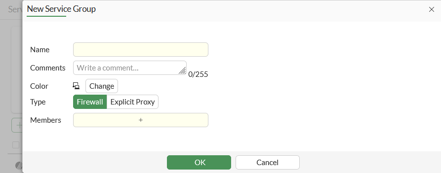

Service groups
Service groups are a collection of services and other service groups, allowing multiple services to be applied in a firewall policy at once.
Service groups can be cloned and edited in the Service Groups tab using the same process as services. See Predefined services.
To configure a service group in the GUI:
  2. Go to the Service Groups tab and click Create new. The New Service Group page is displayed.
  3. Enter the Name of the group.
  4. (Optional) Enter a comment and select a color for the service group.
  5. Select the group type.
  6. Click the Members field and select the services and service groups to include in the group.
  7. Click OK.
To configure a service group in the CLI:
config firewall service group
    edit <name>
        set fabric-object {enable | disable}
        set member <service name1>, <service name2>
        set proxy {enable | disable}
        set srcintf "wan2"
        set dstintf "wan1"
        set srcaddr "all"
        set dstaddr "all"
        set service "ALL"
        set nat enable
        set srcintf "wan2"
        set dstintf "wan1"
        set srcaddr "all"
        set dstaddr "all"
        set service "ALL"
        set nat enable
  7. Click OK.

When the global anti-replay option is disabled, the FortiGate does not check TCP flags in packets. The per policy anti-replay option overrides the global setting. This allows you to control whether or not TCP flags are checked per policy.
To enable the anti-replay option so TCP flags are checked using the CLI:
        set name "policyid-1"
        set srcintf "wan2"
        set dstintf "wan1"
        set srcaddr "all"
        set dstaddr "all"
        set service "ALL"
        set anti-replay enable
        set logtraffic all
        set nat enable

Hardware acceleration is supported on select FortiGate devices and is enabled by default on all firewall policies to ensure optimal performance when processing network traffic traversing the FortiGate. See the Hardware Acceleration Reference Manual for details.
Typically, hardware acceleration on a specific firewall policy is disabled for one of two purposes:
  • To allow CLI commands such as the packet sniffer and debug flow to display all traffic matching the policy since traffic offloaded by SPU hardware on a FortiGate device is not visible by those CLI tools.
  • To troubleshoot any possible issues arising by using hardware acceleration.
To disable hardware acceleration in an IPv4 firewall policy:
        set auto-asic-offload disable
To disable hardware acceleration in an IPv6 firewall policy:
config firewall policy6

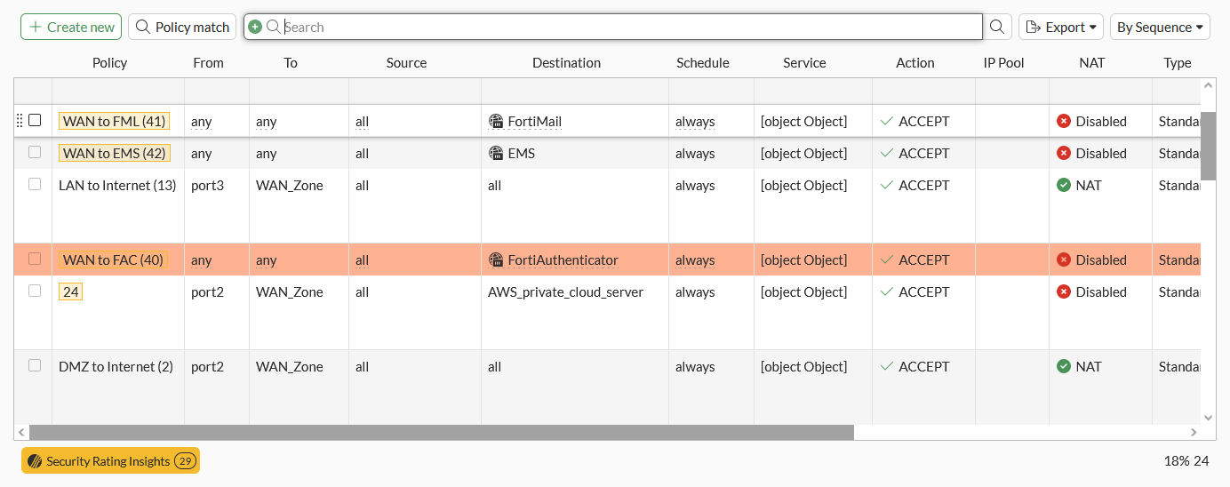

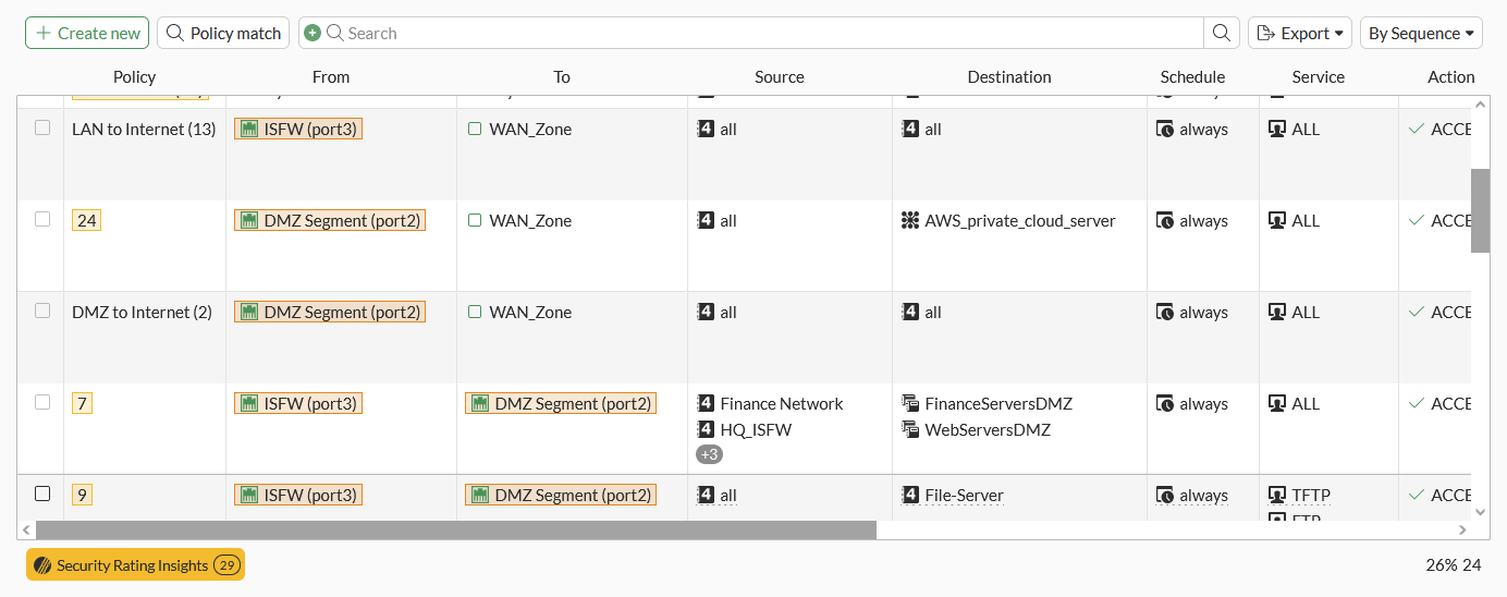

  6. Click OK.
Policy match
Services
Predefined services
To clone a service:
  6. Click OK.
To edit a service:
  5. Click OK.
Custom services
  4. Click OK.

Service groups
    edit <name>
