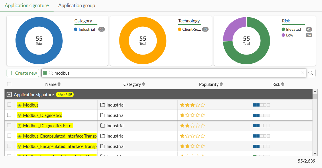

Modbus application control signatures are listed on Security Profiles > Application Signatures. Search for Modbus to see the Modbus signatures, such as Modbus_Diagnostics and Modbus_Read.Coils.
