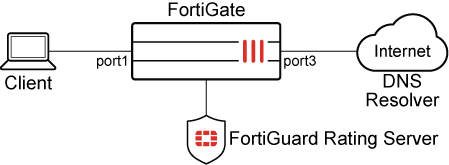

In the following examples, the FortiGate inspects DNS queries made over DoT and DoH to a Cloudflare DNS server. The DNS filter profile blocks the education category.

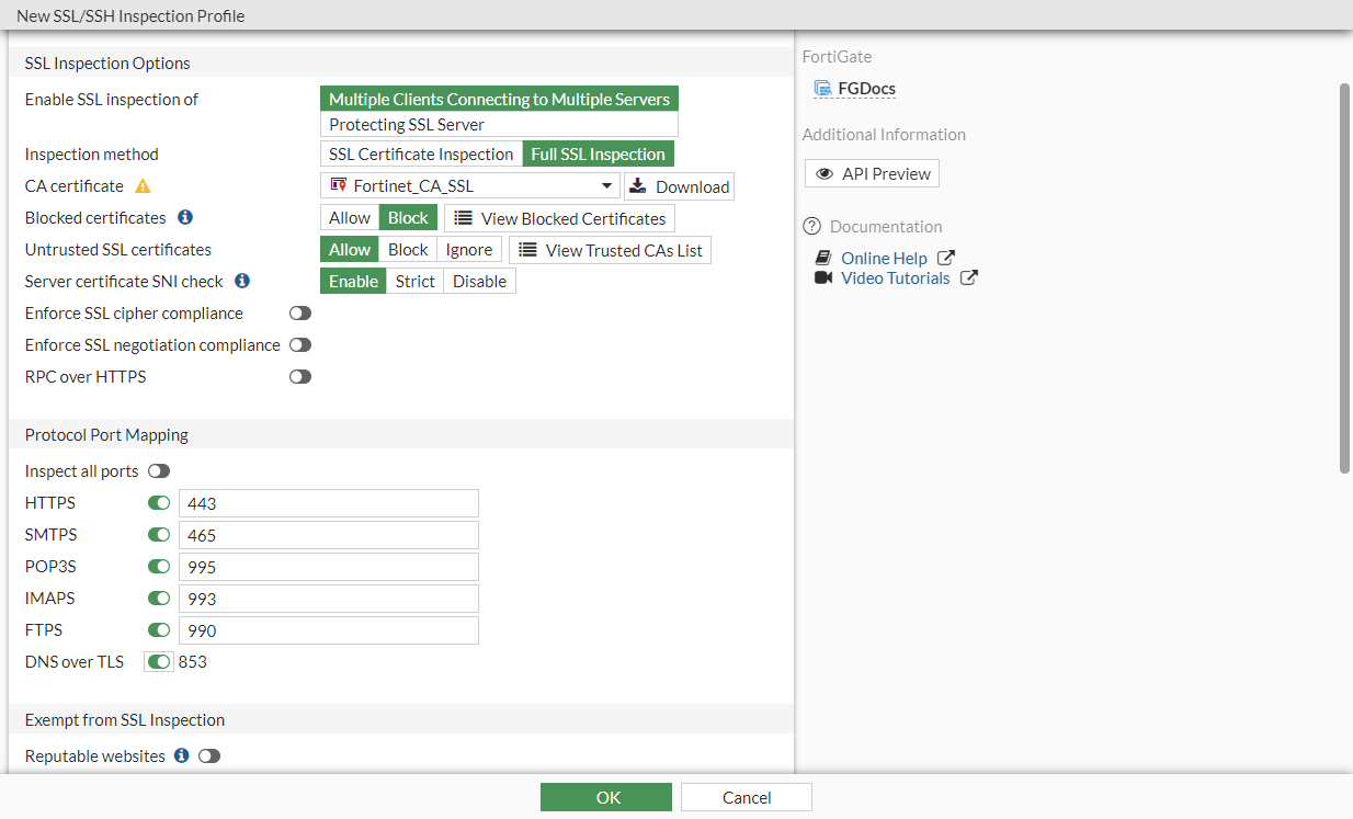

To configure DNS inspection of DoT and DoH queries in the GUI:
  1. Configure the SSL-SSH profile:
    1. Go to Security Profiles > SSL/SSH Inspection and click Create New.
    2. Set Inspection method to Full SSL Inspection. DoT and DoH can only be inspected using doing deep inspection.
    3. In the Protocol Port Mapping section, enable DNS over TLS.
    4. Configure the other settings as needed.
    5. Click OK.

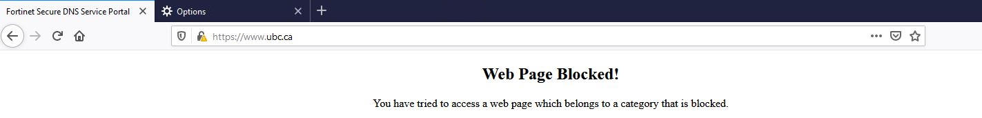

To query DNS over HTTPS:
  1. In your browser, enable DNS over HTTPS.
  2. Go to www.ubc.ca. The website is redirected to the block page.
    5. Click OK.
