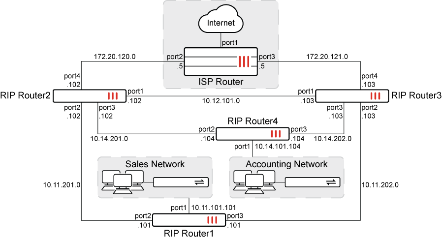

Basic RIP example
In this example, a medium-sized network is configured using RIPv2.
Two core routers, RIP Router2 and RIP Router3, connect to the ISP router for two redundant paths to the internet.
Two other routers, RIP Router1 and RIP Router4, connect to the two core routers and to different local networks.
The ISP router is using RIP for its connections to the core routers, and redistributes its default route to the network - that is, default route injection is enabled.
The ISP router uses NAT and has a static route to the internet. None of the other routers use NAT or static routes.
All of the FortiGate routers are configured as shown, using netmask 255.255.255.0. Firewall policies have been configured to allow the required traffic to flow across the interfaces.

After configuring each router, you can check the status of the connections by viewing the RIP database, RIP interfaces, and routing table. See Verifying the configuration.
After the network is configured, you can test it to ensure that when network events occur, such as a downed link, routing updates are triggered and converge as expected. See Testing the configuration and routing changes.

Example 2- Additional link failures on Router2
In addition to the link failure on the ISP router in example, port1 and port3 on Router2 have also failed. This means that Router4 must go through Router3, Router1, Router2, then the ISP router to reach the internet. Note that, for a period of time, some routes' metrics increase to 16. If no better routes are found for these networks, then they eventually disappear.
After the convergence completes, the RIP database and routing table on Router4 should resemble the following:
# get router info rip database
Codes: R - RIP, Rc - RIP connected, Rs - RIP static, K - Kernel,
C - Connected, S - Static, O - OSPF, I - IS-IS, B - BGP
Network Next Hop Metric From If Time
R 0.0.0.0/0 10.14.202.103 5 10.14.202.103 vd43link0 02:54
R 10.11.101.0/24 10.14.202.103 3 10.14.202.103 vd43link0 02:54
R 10.11.201.0/24 10.14.202.103 3 10.14.202.103 vd43link0 02:54
R 10.11.202.0/24 10.14.202.103 2 10.14.202.103 vd43link0 02:54
Rc 10.14.101.0/24 1 LoAccounting
Rc 10.14.202.0/24 1 vd43link0
R 172.20.120.0/24 10.14.202.103 4 10.14.202.103 vd43link0 02:54
# get router info routing-table all
Codes: K - kernel, C - connected, S - static, R - RIP, B - BGP
O - OSPF, IA - OSPF inter area
N1 - OSPF NSSA external type 1, N2 - OSPF NSSA external type 2
E1 - OSPF external type 1, E2 - OSPF external type 2
i - IS-IS, L1 - IS-IS level-1, L2 - IS-IS level-2, ia - IS-IS inter area
* - candidate default
Routing table for VRF=0
R* 0.0.0.0/0 [120/5] via 10.14.202.103, vd43link0, 00:03:54
R 10.11.101.0/24 [120/3] via 10.14.202.103, vd43link0, 03:10:12
R 10.11.201.0/24 [120/3] via 10.14.202.103, vd43link0, 00:03:54
R 10.11.202.0/24 [120/2] via 10.14.202.103, vd43link0, 03:10:38
C 10.14.101.0/24 is directly connected, LoAccounting
C 10.14.202.0/24 is directly connected, vd43link0
R 172.20.120.0/24 [120/4] via 10.14.202.103, vd43link0, 00:03:54
Reaching the internet on the default gateway now requires five hops from Router4:
# execute traceroute 8.8.8.8 traceroute to 8.8.8.8 (8.8.8.8), 32 hops max, 3 probe packets per hop, 84 byte packets 1 10.14.202.103 0.087 ms 0.026 ms 0.012 ms 2 10.11.202.101 0.045 ms 0.024 ms 0.025 ms 3 10.11.201.102 0.048 ms 0.024 ms 0.015 ms 4 172.20.120.5 0.050 ms 0.028 ms 0.019 ms 5 * * *
