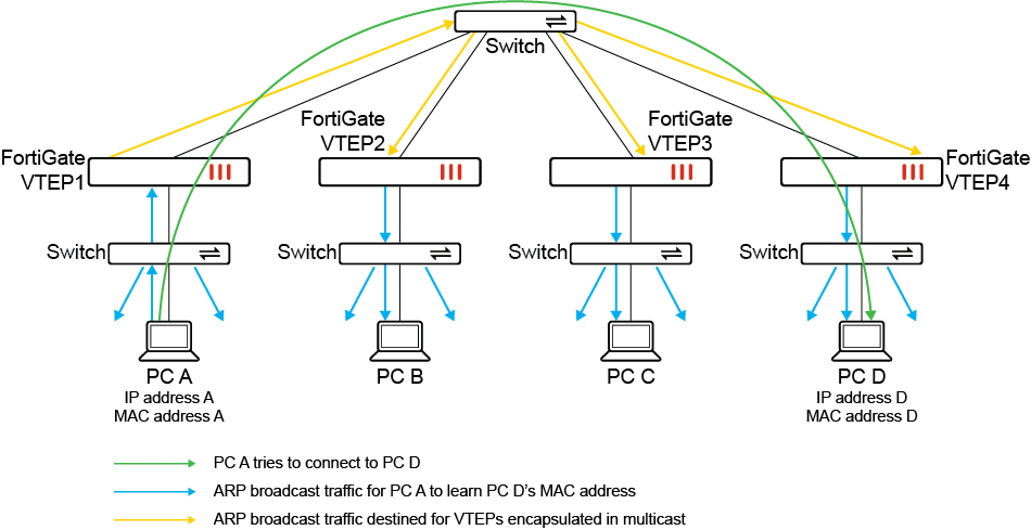

FortiOS supports VXLAN as implemented according to RFC 7348. Currently, VXLAN relies on determining the MAC address of the destination host by using address resolution protocol (ARP) broadcast frames encapsulated in multicast packets.
A multicast group is maintained with all the VXLAN tunnel endpoints (VTEPs) associated with the same VXLAN, namely, with the same VXLAN network identifier (VNI).
The multicast packets that encapsulate ARP broadcast frames are sent to this multicast group, and then the destination host replies to the source host using unicast IP packet encapsulated using VXLAN.
The source and destination FortiGates as VTEPs each maintain a mapping of MAC addresses to remote VTEPs.
As with non-VXLAN traffic, VXLAN relies on the preceding ARP process, commonly known as flood-and-learn that floods the network with broadcast frames encapsulated as multicast packets to learn MAC addresses. In the RFC 7348 implementation of VXLAN, the data plane is simultaneously used as a control plane.

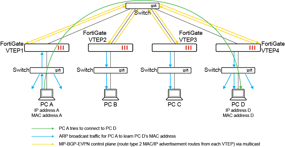

The following topology demonstrates how flood-and-learn uses ARP broadcast traffic flooded throughout the VXLAN for PC A to learn PC D's MAC address when PC A tries to connect to PC D.
Multiprotocol Border Gateway Protocol Ethernet Virtual Private Network (MP-BGP EVPN) support for VXLAN allows for learning MAC addresses in a way that is more suitable for large deployments than flood-and-learn.
MP-BGP EVPN is a standards-based control plane that supports the distribution of attached host MAC and IP addresses using MP-BGP, namely, using the EVPN address family and MAC addresses treated as routing entries in BGP. As a control plane that is separate from the data plane, MP-BGP EVPN avoids flood-and-learn in the network, and the wide use of BGP as an external gateway protocol on the internet proves its ability to scale well with large deployments. The following topology demonstrates how MP-BGP EVPN distributes route type 2 MAC/IP advertisement routes among VTEPs in the VXLAN, and minimizes ARP broadcast traffic required for PC A to learn PC D's MAC address when PC A tries to connect to PC D.

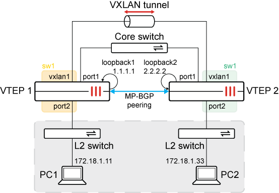

In this example, two FortiGates are configured as VXLAN tunnel endpoints (VTEPs). A VXLAN is configured to allow L2 connectivity between the networks behind each FortiGate. The VXLAN interface vxlan1 and port2 are placed on the same L2 network using a software switch (sw1). An L2 network is formed between PC1 and PC2. MP-BGP EVPN is used as the control plane to learn and distribute MAC address information within a single L2 domain identified using a specific VNI.
The VTEPs have the following MAC address tables:
Interface/endpoint |
VTEP1 |
VTEP2 |
vxlan1 |
82:51:d1:44:bf:93 |
d2:21:00:c9:e6:98 |
port2 |
50:00:00:03:00:01 |
50:00:00:04:00:01 |
sw1 |
50:00:00:03:00:01 |
50:00:00:04:00:01 |
The MAC address of PC1 is 00:50:00:00:06:00. The MAC address of PC2 is 00:50:00:00:07:00.
This example assumes that the WAN interface and default route settings have already been configured on the VTEP 1 and VTEP 2 FortiGates. These configurations are omitted from the example. All peers are configured for MP-BGP EVPN.
