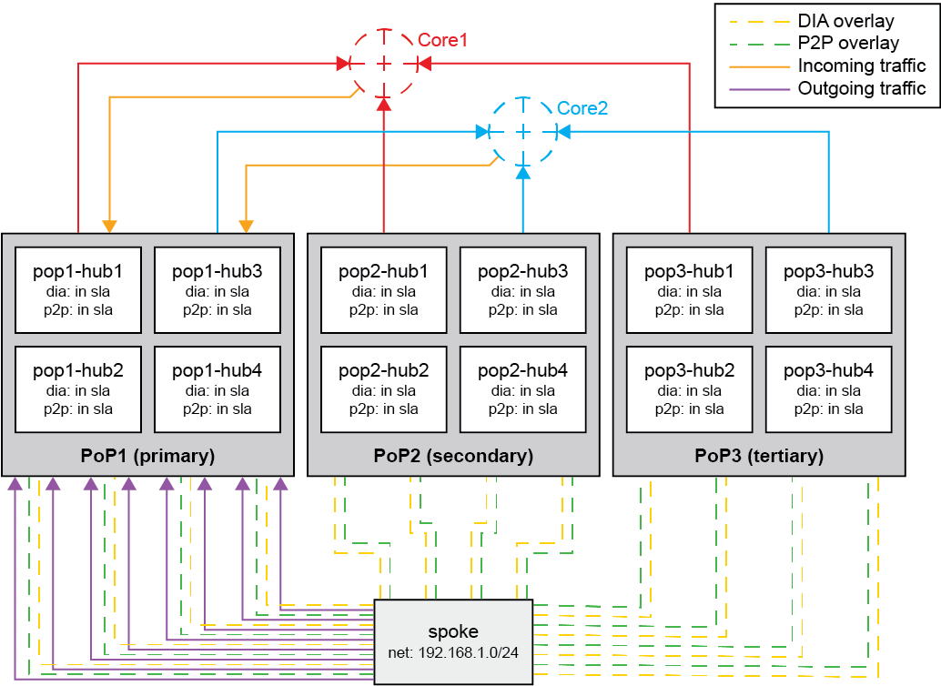

FortiOS 7.2.0 introduced a feature to define the minimum number of SD-WAN interface members that must meet SLA in order for the spoke to select a hub to process its SD-WAN traffic. This design is suitable for a single-PoP multi-hub architecture in order to achieve hub-to-hub failover. See Using multiple members per SD-WAN neighbor configuration.
In FortiOS 7.4.1 and later, the design is enhanced to support a multi-PoP multi-hub architecture in which incoming and outgoing traffic failover between PoPs is supported.
Based on the preceding diagram, incoming and outgoing traffic to the spoke is preferred over PoP1. If a single hub within PoP1 goes out of SLA, traffic will continue to flow through the PoP. If the minimum number of members to meet SLA in the PoP cannot be met, then traffic will fail over to PoP2.
The following enhancements have been made to support the multi-PoP failover scenario.

Outgoing path control
The outgoing path from spoke to hub operates as follows:
  1. Overlays to the primary and secondary PoP are assigned separately into an SD-WAN primary and secondary zone on the spoke.
  2. One SD-WAN service rule is defined to include these zones as SD-WAN members.
  3. When the primary zone is in SLA (minimum-sla-meet-members is met), the SD-WAN service rule steers traffic to the in SLA overlay members.
  4. When the primary zone is out of SLA (minimum-sla-meet-members is not met), the SD-WAN service rule steers traffic to the in SLA overlay members in the secondary zone.
  5. When the primary zone SLA is recovered:
    1. If sla-stickness is disabled on the SD-WAN service rule, then traffic will wait the duration of the hold-down-time before switching back to in SLA overlays in the primary zone.
    2. If sla-stickness is enabled on the SD-WAN service rule, then existing traffic will be kept on the in SLA overlays on the secondary zone, but new traffic will be steered to in SLA overlays in the primary zone.
Incoming path control
The incoming traffic from the core/external peers, to PoP, to spoke operates as follows:
  1. When the primary zone is in SLA, the spoke uses the preferable route map to advertise local routes with the in SLA community to hubs in the primary and secondary PoPs.
    1. Hubs in the primary PoP translate the in SLA community into a short AS path and advertise it to external peers to attract incoming traffic.
    2. Hubs in the secondary PoP translate the in SLA community into a longer AS path and advertise it to external peers to deflect incoming traffic.
  2. If the number of in SLA overlays in the primary zone is less than the minimum-sla-meet-members, then the spoke will use the default route map to advertise routes instead of with an out of SLA community to hubs in the primary PoP.
    1. Hubs in the primary PoP translate the out of SLA community into a longest AS path, and advertise it to external peers to deflect incoming traffic.
    2. As a result, inbound traffic is routed to hubs in the secondary PoP.
  3. When the primary zone SLA is recovered:
    1. The spoke will wait the duration of the predefined hold-down-time in the SD-WAN service rule to use the preferable route map again to advertise routes with the in SLA community to hubs in the primary PoP.
    2. As a result, inbound traffic will be routed back to hubs in the primary PoP.

SD-WAN multi-PoP multi-hub large scale design and failover
  • Add minimum-sla-meet-members setting in the SD-WAN zone configurations and zone-mode setting in the SD-WAN service configurations:
    config system sdwan
        config zone
            edit <name>
                set minimum-sla-meet-members <integer>
        config service
            edit <id>
                set mode sla
                set zone-mode {enable | disable}
    When zone-mode is enabled on an SD-WAN service rule, the traffic is steered based on the status of the zone.
    The state of the health check referenced in the SD-WAN service can be defined as follows:
    • If the number of in SLA members in a zone is less than the minimum-sla-meet-members, then the zone's state is out of SLA; otherwise, it is in SLA.
    • If a zone's state is out of SLA, then all members in the zone are out of SLA.
    • If a zone's state is in SLA, then the health check's state of individual members in the zone is determined by its own state.
  • Add service-id setting in the SD-WAN neighbor configurations:
    config system sdwan
        config neighbor
            edit <bgp_neighbor_ip>
                set member <member_id>
                set service-id <id>
    The SD-WAN neighbor’s behavior can be determined by SD-WAN service and naturally synchronizes with SD-WAN service.
    • The SD-WAN service defines priority zones, whose SLA state determines the advertised community preferable string.
    • The SD-WAN service defines the hold-down-time, which determines how long an advertised community preferable string can be kept when it is expected to be changed.
  • Add sla-stickness setting in the SD-WAN service configurations:
    config system sdwan
        config service
            edit <id>
                set mode sla
                set sla-stickiness {enable | disable}
    The switch-over of an existing session is determined as follows:
    • If the outgoing interface of the session is in SLA, then the session can keep its outgoing interface.
    • Otherwise, the session switches to a preferable path if one exists.
  • Allow the neighbor group to be configured in the SD-WAN neighbor configurations:
    config system sdwan
        config neighbor
            edit <bgp_neighbor_group>
                set health-check <name>
                set sla-id <id>
Neighbor group configuration
By configuring the neighbor group for spokes under the hub's SD-WAN neighbor configuration, if all paths from the hub to external peers are detected as out of SLA, then the hub will use the default route map to deny external routes to spokes that belong to this neighbor group defined on the hub. As a result, spokes will skip that specific hub and connect to external peers from other hubs.
This allows spokes to only measure overlay quality to each hub, and hubs to manage health checks to services by external peers. This significantly decreases the number of health check probes directly from the spoke to services and decreases the overall complexity. The complexity is further simplified by using multiple VRFs or segmentation where each spoke needs to send health check probes.
Example
This example configuration contains the following components:
  • Two PoPs:
    • The primary PoP has two hubs (Hub-1 and Hub-2).
    • The secondary PoP has one hub (Hub-3).
  • Spoke-1 has six overlays, with two overlay connections to each hub.
  • Spoke-1 has three BGP neighbors, with one BGP neighbor for each hub.
    • All BGP neighbors are established on loopback IPs.
  • Each hub has two paths to external peers.
Normally, outbound and inbound traffic go through hubs in the primary PoP. If the number of in SLA overlays to the primary PoP is less than the minimum-sla-meet-members (set to 2 in this example), bi-directional traffic needs to be switched to hubs in the secondary PoP. But when the primary PoP recovers and the minimum-sla-meet-members is met again, bi-directional traffic is forced back to hubs in the primary PoP after the predefined hold-down-time duration.
The hubs do not require SD-WAN configurations to the spokes. However, they use SD-WAN for connections to external peer routers.
