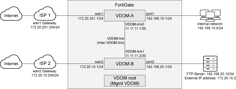

This example shows how to configure a FortiGate unit to use inter-VDOM routing to route traffic between an internal network and FTP server that are each behind separate VDOMs. See Inter-VDOM routing for more information.
The following example shows how to configure per-VDOM settings, such as operation mode, routing, and firewall policies, in a network that includes the following VDOMs:
VDOM-A: allows the internal network to access the Internet.
VDOM-B: allows external connections to an FTP server.
root: the management VDOM.
You can use VDOMs in either NAT or transparent mode on the same FortiGate. By default, VDOMs operate in NAT mode. In this example, both VDOM-A and VDOM-B use NAT mode. An inter-VDOM link is created and inter-VDOM routes configured to allow users on the internal network to access the FTP server.
This is an example of the partial-mesh VDOMs configuration since only VDOM-A is connected to VDOM-B but neither of those VDOMs are connected to the root VDOM. See Topologies for details.
This example assumes that the interfaces of the FortiGate have already been configured with the IP addresses depicted in the preceding diagram.

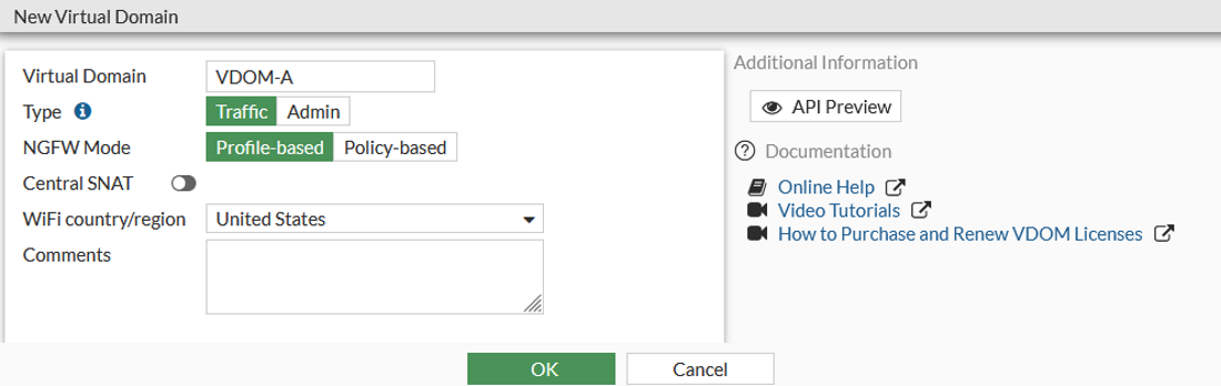

To create the VDOMs in the GUI:
In the Global VDOM, go to System > VDOM.
Click Create New.
In the Virtual Domain field, enter VDOM-A.
If required, set the NGFW Mode. If the NGFW Mode is Profile-based, Central SNAT can be enabled.
Click OK to create the VDOM.
Repeat the above steps for VDOM-B.

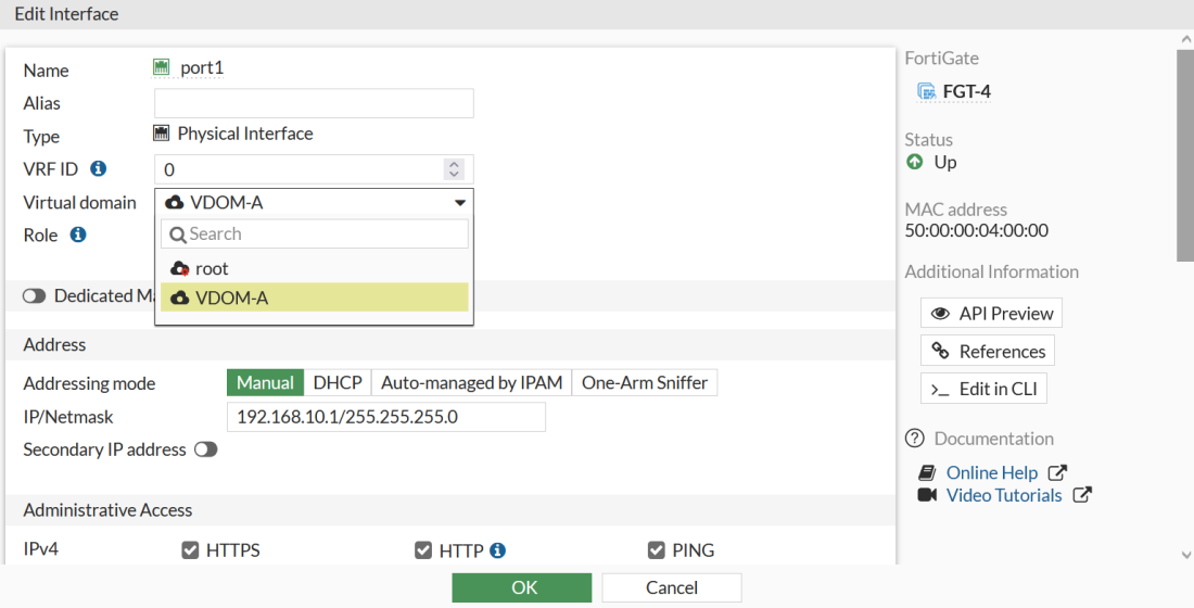

To assign interfaces to VDOMs in the GUI:
In the Global VDOM, go to Network > Interfaces.
Select port1 and click Edit.
From the Virtual domain list, select VDOM-A.
Click OK.
Repeat the preceding steps to assign port2 to VDOM-B.

Configure the VDOM link
The VDOM link allows connections from VDOM-A to VDOM-B. The VDOM link interface configured in this step will be used for inter-VDOM routing.
This step requires you to connect to the global VDOM using a global administrator account.
To add the VDOM link in the GUI:
Create New > VDOM link.
Enter the following information:
Name VDOM-link Interface 0 Virtual Domain VDOM-A IP/Netmask
11.11.11.1/255.255.255.252
Interface 1
Virtual Domain
VDOM-B
IP/Netmask
11.11.11.2/255.255.255.252
Click OK.
