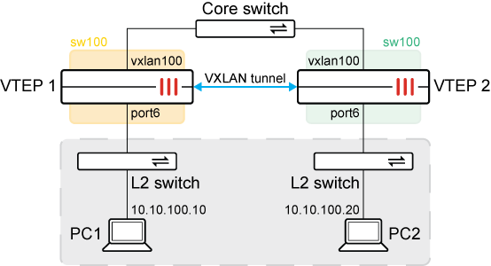

The following topology is used as an example configuration to demonstrate VXLAN troubleshooting steps.
In this example, two FortiGates are configured as VXLAN tunnel endpoints (VTEPs). A VXLAN is configured to allow L2 connectivity between the networks behind each FortiGate. The VXLAN interface and port6 are placed on the same L2 network using a software switch (sw100). An L2 network is formed between PC1 and PC2.

To configure the VTEP 1 FortiGate:
Configure the local interface:
config system vxlan edit "vxlan100" set interface "port2" set vni 100 set remote-ip "192.168.2.87" next end -
Configure the interface settings:
config system interface edit "port2" set vdom "root" set ip 192.168.2.86 255.255.255.0 set allowaccess ping https ssh http fabric next edit "vxlan100" set vdom "root" set type vxlan set interface "port2" next end -
Configure the software switch:
config system switch-interface edit "sw100" set vdom "root" set member "port6" "vxlan100" next end -
Configure the software switch interface settings:
config system interface edit "sw100" set vdom "root" set ip 10.10.100.86 255.255.255.0 set allowaccess ping set type switch set device-identification enable set lldp-transmission enable set role lan next end
To configure the VTEP 2 FortiGate:
config system vxlan edit "vxlan100" set interface "port2" set vni 100 set remote-ip "192.168.2.86" next end -
config system interface edit "port2" set vdom "root" set ip 192.168.2.87 255.255.255.0 set allowaccess ping https ssh snmp http next edit "vxlan100" set vdom "root" set type vxlan set interface "port2" next end -
config system interface edit "sw100" set vdom "root" set ip 10.10.100.87 255.255.255.0 set allowaccess ping set type switch set device-identification enable set lldp-transmission enable set role lan set snmp-index 42 next end

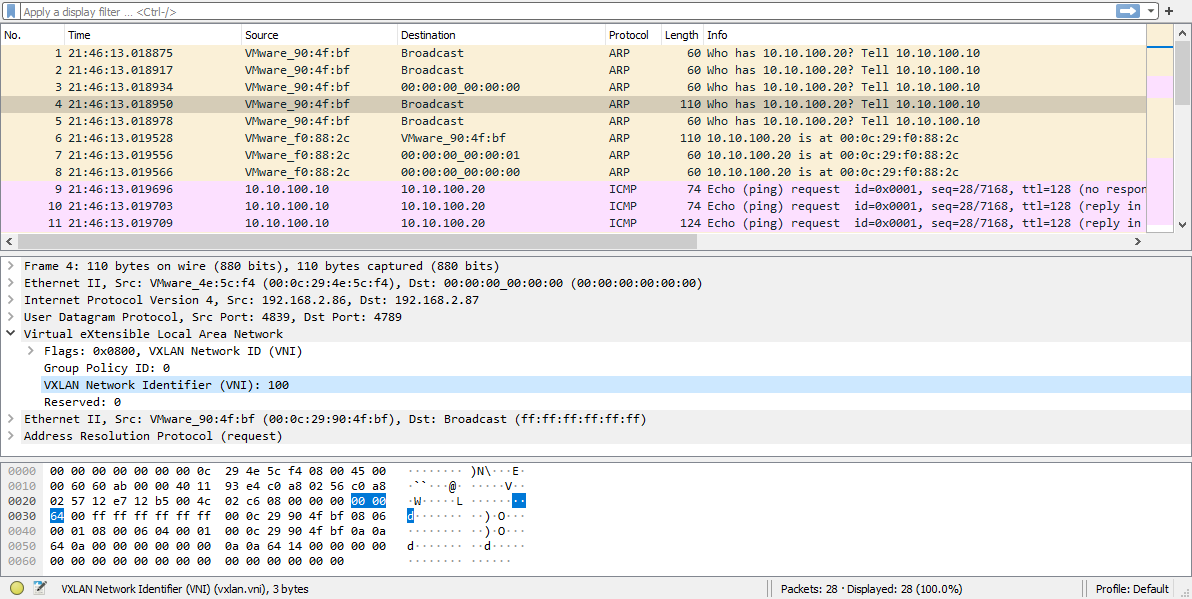

Perform a sniffer trace on the VTEP 1 FortiGate to view the life of the packets as they pass through the FortiGate:
# diagnose sniffer packet any 'host 10.10.100.20 or (udp and host 192.168.2.87)' 4 0 l Using Original Sniffing Mode interfaces=[any] filters=[host 10.10.100.20 or (udp and host 192.168.2.87)] 2022-11-04 14:35:18.567602 port6 in arp who-has 10.10.100.20 tell 10.10.100.10 2022-11-04 14:35:18.567629 vxlan100 out arp who-has 10.10.100.20 tell 10.10.100.10 2022-11-04 14:35:18.567642 port2 out 192.168.2.86.4804 -> 192.168.2.87.4789: udp 68 2022-11-04 14:35:18.567658 sw100 in arp who-has 10.10.100.20 tell 10.10.100.10 2022-11-04 14:35:18.568239 port2 in 192.168.2.87.4789 -> 192.168.2.86.4789: udp 68 2022-11-04 14:35:18.568263 vxlan100 in arp reply 10.10.100.20 is-at 00:0c:29:f0:88:2c 2022-11-04 14:35:18.568272 port6 out arp reply 10.10.100.20 is-at 00:0c:29:f0:88:2c 2022-11-04 14:35:18.568425 port6 in 10.10.100.10 -> 10.10.100.20: icmp: echo request 2022-11-04 14:35:18.568435 vxlan100 out 10.10.100.10 -> 10.10.100.20: icmp: echo request 2022-11-04 14:35:18.568443 port2 out 192.168.2.86.4805 -> 192.168.2.87.4789: udp 82 2022-11-04 14:35:18.568912 port2 in 192.168.2.87.4789 -> 192.168.2.86.4789: udp 68 2022-11-04 14:35:18.568925 vxlan100 in arp who-has 10.10.100.10 tell 10.10.100.20 2022-11-04 14:35:18.568935 port6 out arp who-has 10.10.100.10 tell 10.10.100.20 2022-11-04 14:35:18.568945 sw100 in arp who-has 10.10.100.10 tell 10.10.100.20 2022-11-04 14:35:18.569070 port6 in arp reply 10.10.100.10 is-at 00:0c:29:90:4f:bf 2022-11-04 14:35:18.569076 vxlan100 out arp reply 10.10.100.10 is-at 00:0c:29:90:4f:bf 2022-11-04 14:35:18.569081 port2 out 192.168.2.86.4806 -> 192.168.2.87.4789: udp 68 2022-11-04 14:35:18.569417 port2 in 192.168.2.87.4789 -> 192.168.2.86.4789: udp 82 2022-11-04 14:35:18.569427 vxlan100 in 10.10.100.20 -> 10.10.100.10: icmp: echo reply 2022-11-04 14:35:18.569431 port6 out 10.10.100.20 -> 10.10.100.10: icmp: echo reply
In the output, the following packet sequence is seen on the FortiGate:
The FortiGate receives an ARP request from PC1 10.10.100.10 on port6.
The ARP request is forwarded to vxlan100 on the same software switch, where it gets encapsulated and sent out as a UDP port 4789 packet on port2.
A reply is received on port2 from the remote VTEP with the ARP response encapsulated in UDP port 4789 again.
The ARP reply is forwarded back out of port6 to PC1.
PC1 sends the ICMP request using the same steps.
Perform the same sniffer trace filter with a level 6 verbose level. In this example, the packet capture is converted into a Wireshark file.
The packet that leaves the physical port2 is encapsulated in UDP and has a VXLAN header with VNI 100 as the identifier. There is an additional 50 B overhead of the UDP encapsulated VXLAN packets as opposed to the unencapsulated packets (for example, packet 4 versus packets 1 and 2).
