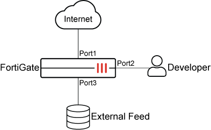

Exact Data Matching (EDM) enables precise matching of patterns or keywords from a predefined dataset, ensuring high accuracy. FortiGate can be configured to reference external resources containing lists of sensitive tokens, such as AWS Access Keys, JWTs (JSON Web Tokens), OAuth tokens, or other application secrets, that are used in your organization. These resources are dynamically synchronized and periodically updated, so any changes are automatically imported by FortiOS.
This configuration helps prevent accidental or intentional leakage of API keys, authentication tokens, or other secrets by blocking any code snippet containing these values when users attempt to upload files to external platforms such as GitHub, GitLab, or cloud storage services.
In this example, a file containing an AWS access token is being uploaded to an external GitHub repository using the HTTP POST method. FortiGate intercepts the traffic through deep inspection and blocks the upload because it matches the DLP profile configured on the device. This ensures that sensitive credentials, such as AWS Access Tokens, are not accidentally or intentionally leaked outside the organization.

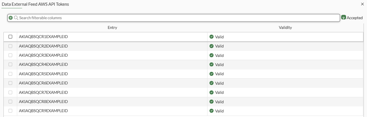

    6. Edit the DLP EDM template and click View Entries to view the data entries in the field.

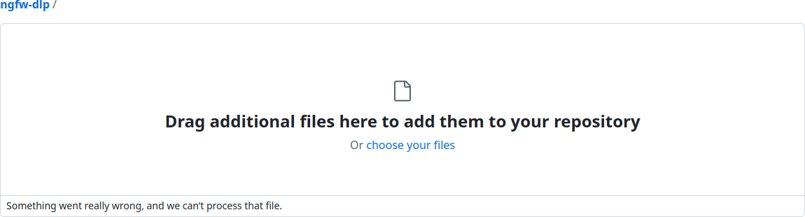

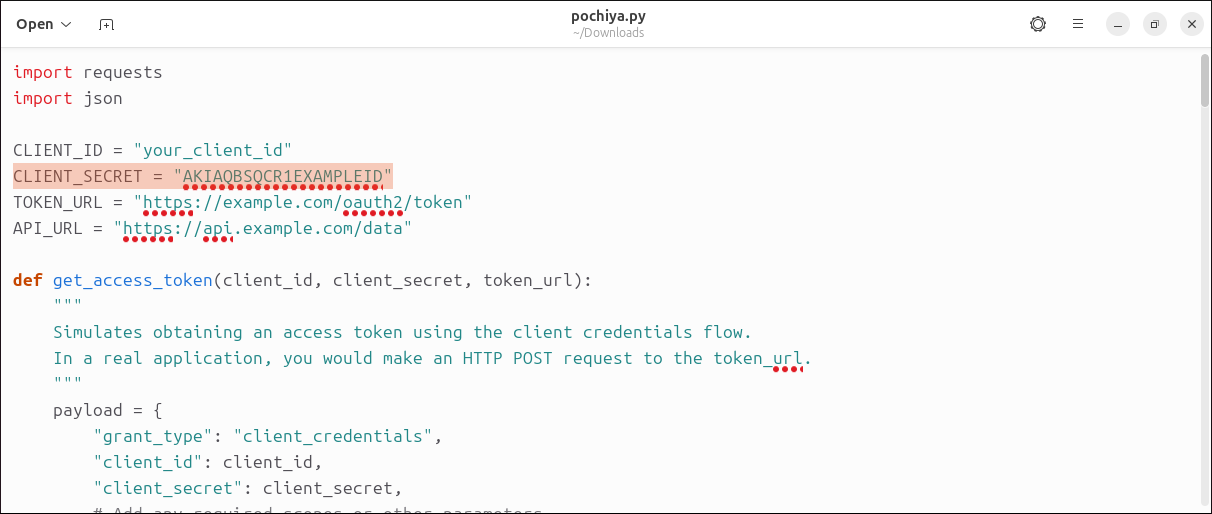

  1. A developer attempts to upload a file containing AWS access tokens through HTTPS to github.com, and the file content matches the EDM template.
  2. FortiGate blocks the user's attempt and displays an error message:

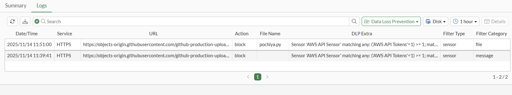

  3. FortiGate generates a DLP log:
    1: date=2025-11-14 time=11:51:00 eventtime=1763077860331286861 tz="+1200" logid="0954024576" type="utm" subtype="dlp" eventtype="dlp" level="warning" vd="root" ruleid=1 rulename="AWS API Profile" dlpextra="Sensor 'AWS API Sensor' matching any: ('AWS API Tokens'=1) >= 1; match." filtertype="sensor" filtercat="file" severity="critical" policyid=1 poluuid="3c57da8c-c0de-51f0-6f4a-95b898d269b3" policytype="policy" sessionid=28834 epoch=834063557 eventid=1 srcip=10.10.10.10 srcport=53912 srccountry="United States" srcintf="port2" srcintfrole="undefined" srcuuid="d2f06fda-15e7-51ee-0d22-faaf5170dad2" dstip=140.82.113.21 dstport=443 dstcountry="United States" dstintf="port1" dstintfrole="undefined" dstuuid="d2f06fda-15e7-51ee-0d22-faaf5170dad2" proto=6 service="HTTPS" filetype="python" direction="outgoing" action="block" hostname="objects-origin.githubusercontent.com" url="https://objects-origin.githubusercontent.com/github-production-upload-manifest-file-7fdce7" agent="Mozilla/5.0 (X11; Ubuntu; Linux x86_64; rv:135.0) Gecko/20100101 Firefox/135.0" httpmethod="POST" referralurl="https://github.com/" filename="pochiya.py" filesize=2338 profile="AWS API Profile"
