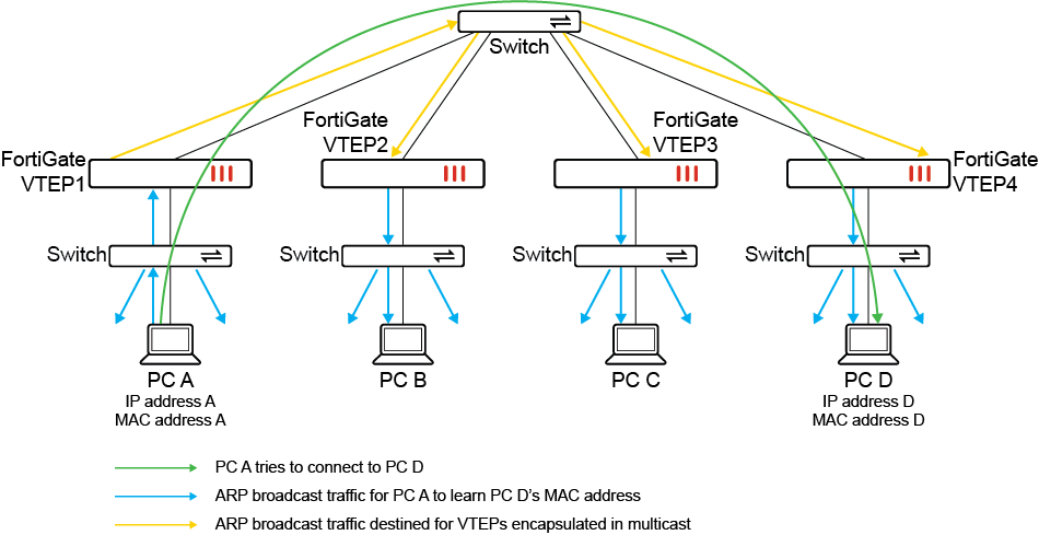

FortiOS supports VXLAN as implemented according to RFC 7348. Currently, VXLAN relies on determining the MAC address of the destination host by using address resolution protocol (ARP) broadcast frames encapsulated in multicast packets.
  • A multicast group is maintained with all the VXLAN tunnel endpoints (VTEPs) associated with the same VXLAN, namely, with the same VXLAN network identifier (VNI).
  • The multicast packets that encapsulate ARP broadcast frames are sent to this multicast group, and then the destination host replies to the source host using unicast IP packet encapsulated using VXLAN.
  • The source and destination FortiGates as VTEPs each maintain a mapping of MAC addresses to remote VTEPs.
As with non-VXLAN traffic, VXLAN relies on the preceding ARP process, commonly known as flood-and-learn that floods the network with broadcast frames encapsulated as multicast packets to learn MAC addresses. In the RFC 7348 implementation of VXLAN, the data plane is simultaneously used as a control plane.
The following topology demonstrates how flood-and-learn uses ARP broadcast traffic flooded throughout the VXLAN for PC A to learn PC D's MAC address when PC A tries to connect to PC D.

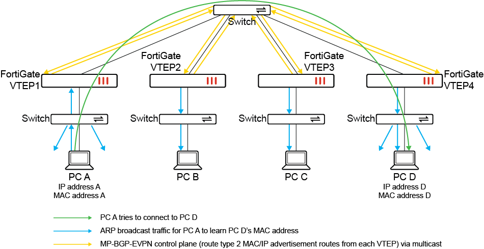

Multiprotocol Border Gateway Protocol Ethernet Virtual Private Network (MP-BGP EVPN) support for VXLAN allows for learning MAC addresses in a way that is more suitable for large deployments than flood-and-learn.
MP-BGP EVPN is a standards-based control plane that supports the distribution of attached host MAC and IP addresses using MP-BGP, namely, using the EVPN address family and MAC addresses treated as routing entries in BGP. As a control plane that is separate from the data plane, MP-BGP EVPN avoids flood-and-learn in the network, and the wide use of BGP as an external gateway protocol on the internet proves its ability to scale well with large deployments. The following topology demonstrates how MP-BGP EVPN distributes route type 2 MAC/IP advertisement routes among VTEPs in the VXLAN, and minimizes ARP broadcast traffic required for PC A to learn PC D's MAC address when PC A tries to connect to PC D.
MP-BGP EVPN supports the following features:
  • Route type 2 (MAC/IP advertisement route) and route type 3 (inclusive multicast Ethernet tag route)
  • Intra-subnet communication
  • Single-homing use cases
  • VLAN-based service, namely, there is only one broadcast domain per EVPN instance (EVI). This is due to the current VXLAN design that supports a single VNI for a VXLAN interface.
  • EVPN running on IPv4 unicast VXLAN
  • Egress replication for broadcast, unknown unicast, and multicast (BUM) traffic
  • VXLAN MAC learning from traffic
  • IP address local learning
  • ARP suppression
For more information about MP-BGP EVPN, see RFC 7432. For more information about EVPN and VXLAN, see RFC 8365.
Currently, MP-BGP EVPN supports only VRF 0.

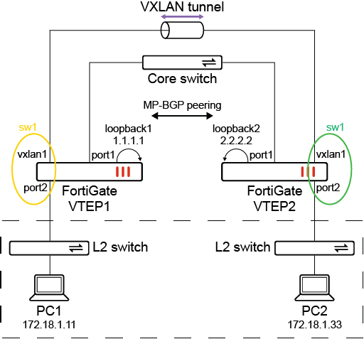

In this example, two FortiGates are configured as VXLAN tunnel endpoints (VTEPs). A VXLAN is configured to allow L2 connectivity between the networks behind each FortiGate. The VXLAN interface vxlan1 and port2 are placed on the same L2 network using a software switch (sw1). An L2 network is formed between PC1 and PC2. MP-BGP EVPN is used as the control plane to learn and distribute MAC address information within a single L2 domain identified using a specific VNI.
The VTEPs have the following MAC address tables:
Interface/endpoint
VTEP1
VTEP2
vxlan1
82:51:d1:44:bf:93
d2:21:00:c9:e6:98
port2
50:00:00:03:00:01
50:00:00:04:00:01
sw1
50:00:00:03:00:01
50:00:00:04:00:01
The MAC address of PC1 is 00:50:00:00:06:00. The MAC address of PC2 is 00:50:00:00:07:00.

To verify the MP-BGP EVPN status on the VTEP1 FortiGate:
  1. From a host computer with IP address 172.18.1.11, perform the following.
    1. Check the ARP cache:
      # arp
      Address                  HWtype  HWaddress           Flags Mask            Iface
      172.18.1.253             ether   50:00:00:03:00:01   C                     ens3
    2. Ping the host computer with IP address 172.18.1.33:
      # ping 172.18.1.33 -c 4
      PING 172.18.1.33 (172.18.1.33) 56(84) bytes of data.
      64 bytes from 172.18.1.33: icmp_seq=1 ttl=64 time=1325 ms
      64 bytes from 172.18.1.33: icmp_seq=2 ttl=64 time=319 ms
      64 bytes from 172.18.1.33: icmp_seq=3 ttl=64 time=3.96 ms
      64 bytes from 172.18.1.33: icmp_seq=4 ttl=64 time=1.66 ms
      --- 172.18.1.33 ping statistics ---
      4 packets transmitted, 4 received, 0% packet loss, time 3007ms
      rtt min/avg/max/mdev = 1.660/412.614/1325.209/542.530 ms
    3. Check the ARP cache again:
      # arp
      172.18.1.33              ether   00:50:00:00:07:00   C                     ens3
  2. On the VTEP1 FortiGate, run the switch and VXLAN debug commands.
    1. Verify the forwarding database for vxlan1:
      # diagnose sys vxlan fdb list vxlan1
      mac=00:00:00:00:00:00 state=0x0082 remote_ip=2.2.2.2 port=4789 vni=1000 ifindex0
      mac=00:50:00:00:07:00 state=0x0082 remote_ip=2.2.2.2 port=4789 vni=1000 ifindex0
      total fdb num: 2
    2. Verify the forwarding database statistics for vxlan1:
      # diagnose sys vxlan fdb stat vxlan1
      fdb_table_size=256 fdb_table_used=2 fdb_entry=2 fdb_max_depth=1 cleanup_idx=0 c2
    3. Verify the bridging information for sw1:
      # diagnose netlink brctl name host sw1
      show bridge control interface sw1 host.
      fdb: hash size=32768, used=5, num=5, depth=1, gc_time=4, ageing_time=3, arp-sups
      Bridge sw1 host table
      port no device  devname mac addr                ttl     attributes
        2     15      vxlan1  00:00:00:00:00:00       28       Hit(28)
        2     15      vxlan1  00:50:00:00:07:00       18       Hit(18)
        2     15      vxlan1  82:51:d1:44:bf:93       0       Local Static
        1     4       port2   00:50:00:00:06:00       14       Hit(14)
        1     4       port2   50:00:00:03:00:01       0       Local Static
  3. Run the BGP EVPN commands and observe the route type 2 (MAC/IP advertisement route) and route type 3 (inclusive multicast Ethernet tag route).
    1. Verify the BGP L2 VPN EVPN summary information:
      # get router info bgp evpn summary
      VRF 0 BGP router identifier 1.1.1.1, local AS number 65001
      BGP table version is 2
      1 BGP AS-PATH entries
      0 BGP community entries
      Neighbor       V         AS MsgRcvd MsgSent   TblVer  InQ OutQ Up/Down  State/Pd
      172.25.160.101 4      65001       9       9        1    0    0 00:04:02        3
      Total number of neighbors 1
    2. Verify the BGP L2 VPN EVPN network information:
      # get router info bgp evpn network
         Network          Next Hop            Metric     LocPrf Weight RouteTag Path
      Route Distinguisher: 100:100 (Default for VRF 0)
      *> [2][0][48][00:50:00:00:06:00][0]/72
                          1.1.1.1             0             100  32768        0 i <-/>
      *> [2][0][48][00:50:00:00:06:00][32][172.18.1.11]/104
      *>i[2][0][48][00:50:00:00:07:00][0]/72
                          2.2.2.2             0             100      0        0 i <-/>
Interface/endpoint
VTEP1
VTEP2
vxlan1
82:51:d1:44:bf:93
d2:21:00:c9:e6:98
port2
50:00:00:03:00:01
50:00:00:04:00:01
sw1
50:00:00:03:00:01
50:00:00:04:00:01
This example assumes that the WAN interface and default route settings have already been configured on the VTEP 1 and VTEP 2 FortiGates. These configurations are omitted from the example. All peers are configured for MP-BGP EVPN.

  3. Configure the local interface and EVPN settings within the VXLAN settings:
    config system vxlan
        edit "vxlan1"
            set interface "loopback2"
            set vni 1000
            set evpn-id 100
  4. Configure the EVPN settings within the BGP settings:
    config router bgp
        set as 65001
        set router-id 2.2.2.2
        set ibgp-multipath enable
        set recursive-next-hop enable
        set graceful-restart enable
        config neighbor
            edit "172.25.160.100"
                set ebgp-enforce-multihop enable
                set next-hop-self enable
                set next-hop-self-vpnv4 enable
                set soft-reconfiguration enable
                set soft-reconfiguration-evpn enable
                set remote-as 65001
        config network
                set prefix 2.2.2.2 255.255.255.255
    172.27.16.236 is the WAN IP address of the VTEP1 FortiGate.
  5. Configure the software switch:
    config system switch-interface
        edit "sw1"
            set vdom "root"
            set member "port2" "vxlan1"
            set intra-switch-policy explicit
  6. Configure the software switch interface settings:
    config system interface
        edit "sw1"
            set vdom "root"
            set ip 172.18.1.254 255.255.255.0
            set allowaccess ping
            set type switch
  7. Configure the firewall policies between the member interfaces in the software switch:
    config firewall policy
             set srcintf "port2"
             set dstintf "vxlan1"
             set srcaddr "all"
             set dstaddr "all"
             set service "ALL"
             set srcintf "vxlan1"
             set dstintf "port2"
             set srcaddr "all"
             set dstaddr "all"
             set service "ALL"
