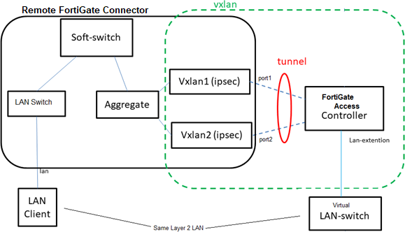

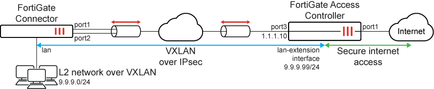

Example CLI configuration
In this example, the Controller provides secure internet access to the remote network behind the Connector. The Controller has two WAN connections: an inbound backhaul connection and an outbound internet connection. The Connector has two wired WAN/uplink ports that are connected to the internet.
After the Connector discovers the Controller and is authorized by the Controller, the Controller pushes a FortiGate LAN extension profile to the Connector. The Connector uses the profile configurations to form two IPsec tunnels back to the Controller. Additional VXLAN aggregate interfaces are automatically configured to create an L2 network between the Connector LAN port and a virtual LAN extension interface on the Controller. Clients behind the Connector can then connect to the internet through the Controller that is securing the internet connection.

  3. On the FortiGate Controller:
    1. Extension controller configurations are automatically initialized:
      config extension-controller fortigate-profile
          edit "FGCONN-lanext-default"
              set id 0
              config lan-extension
                  set ipsec-tunnel "fg-ipsec-XdSpij"
                  set backhaul-interface "port3"
          edit "FGT60F0000000001"
              set id "FG5H1E0000000001"
              set device-id 0
              set profile "FGCONN-lanext-default"
    2. Authorize the Connector:
              set authorized enable
  4. After the FortiGate Connector has been authorized, the Controller pushes the IPsec tunnel configuration to the Connector, forcing it to establish the tunnel and form the VXLAN mechanism.
    The VXLANs are built on the IPsec tunnels between the Connector and Controller. The VXLAN interfaces are aggregated for load balancing and redundancy. A softswitch combines the aggregate interface with the local LAN ports, allowing the LAN ports to be part of the VXLAN. This combines the local LAN ports with the virtual LAN extension interface on the FortiGate Controller.
    1. The Connector receives the IPsec configurations from the Controller, and automatically creates tunnels for each uplink:

    2. VXLAN interfaces are automatically configured and formed over each tunnel:
      config system vxlan
          edit "vx-port1"
              set interface "ul-port1"
              set vni 1
              set dstport 9999
              set remote-ip "10.252.0.1"
          edit "vx-port2"
              set interface "ul-port2"
              set vni 1
              set dstport 9999
    3. An aggregate interface is automatically configured to load balance between the two VXLAN interfaces, using the source MAC and providing link redundancy:
      config system interface
          edit "le-agg-link"
              set vdom "lan-ext"
              set type aggregate
              set member "vx-port1" "vx-port2"
              set snmp-index 35
              set lacp-mode static
              set algorithm Source-MAC
    4. The softswitch is automatically configured and bridges the aggregate interface and the local LAN to connect the LAN to the VXLAN bridged L2 network that goes to the FortiGate LAN extension interface:
      config system switch-interface
          edit "le-switch"
              set vdom "lan-ext"
              set member "le-agg-link" "lan"
To configure the LAN extension interface and firewall policy on the FortiGate Controller:
  1. After the IPsec tunnel is setup and the VXLAN is created over the tunnel, the LAN extension interface is automatically created on the Controller:
            set vdom "root"
            set ip 192.168.0.254 255.255.255.0
            set allowaccess ping ssh
            set type lan-extension
            set role lan
            set snmp-index 27
            set ip-managed-by-fortiipam enable
            set interface "fg-ipsec-XdSpij"
    Devices on the remote LAN network will use this IP address as their gateway.
  2. Observe that with IPAM enabled on the Controller that the DHCP server settings have been automatically configured:
    config system dhcp server
        edit 3
            set dns-service default
            set default-gateway 9.9.9.99
            set netmask 255.255.255.0
            set interface "FGT60F0000000001"
            config ip-range
                    set start-ip 9.9.9.100
                    set end-ip 9.9.9.254
            set dhcp-settings-from-fortiipam enable
            config exclude-range
                    set start-ip 9.9.9.254
  3. Configure the firewall policy to allow traffic from the LAN extension interface to the WAN interface (port1):
    config firewall policy
        edit "2"
            set name "lan-ext"
            set srcintf "FGT60F0000000001"
            set dstintf "port1"
            set srcaddr "all"
            set dstaddr "all"
            set service "ALL"
            set nat enable
    Optionally, security profiles and other settings can be configured.
    The policy allows remote LAN clients to access the internet through the backhaul channel. Clients in the remote LAN behind the Connector receive an IP address over DHCP and access the internet securely through the Controller.
      config system vxlan
          edit "vx-port1"
              set vni 1
              set dstport 9999
          edit "vx-port2"
              set vni 1
              set dstport 9999
          edit "le-agg-link"
              set vdom "lan-ext"
              set type aggregate
              set snmp-index 35
          edit "le-switch"
              set vdom "lan-ext"
            set vdom "root"
            set role lan
            set snmp-index 27
        edit 3
            config ip-range
        edit "2"
            set name "lan-ext"
            set dstintf "port1"
            set srcaddr "all"
            set dstaddr "all"
            set service "ALL"
            set nat enable
