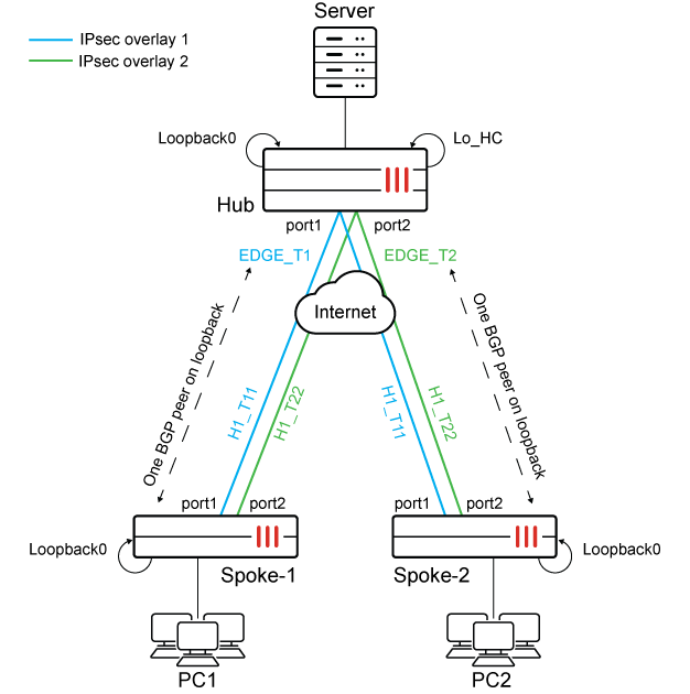

In this example, spokes are configured to embed the SLA priority in ICMP probes, and the hub is configured to use the information. With this configuration:
  • The spoke's overlay priority on each overlay is embedded in the ICMP probes and transported to the hub.
  • The hub sets priorities on IKE routes over different overlays based on the received overlay priorities.
  • On the hub, BGP routes, which are used to guide hub-to-spoke traffic, rely on IKE routes to be resolved to tunnels and inherit the priorities from the IKE routes.
  • The hub can steer traffic to spokes by resolved BGP routes with different inherited priorities.

      • EDGE_T1_0 is to H1_T11 on Spoke-1, and EDGE_T1_1 is to H1_T11 on Spoke-2.
      • EDGE_T2_1 is to H1_T22 on Spoke-1, and EDGE_T1_0 is to H1_T22 on Spoke-2.

Path selection based on embedded SLA priorities

      The following example shows:
      • rmt_ver=2 indicates that SLA information, SLA status, and overlay priority have been received.
      • rmt_sla=out indicates that received SLA status is out of SLA.
      • rmt_sla=in indicates that received SLA status is in SLA.
      • rmt_prio indicates the received overlay priority value.

Speed test rerouting based on embedded SLA priorities
When spoke-initiated speed tests are enabled for this configuration, the out-of SLA priority is used by the hub to choose other routes during the speed test.

  2. On Spoke-1, schedule speed tests:
    config system speed-test-schedule edit "H1_T11" set mode TCP set schedules "speed-test" set dynamic-server enable set ctrl-port 6000 set server-port 7000 set update-shaper remote next edit "H1_T22" set mode UDP set schedules "speed-test" set dynamic-server enable set ctrl-port 6000 set server-port 7000 set update-shaper remote next end
Before starting the speed test on Spoke-1, route priorities are based on the received overlay priorities on both H1_T11 and H1_T22
DC1_A_FGT (root) (Interim)# get router info routing-table bgp
Routing table for VRF=0
B       10.0.3.0/24 [200/0] via 172.31.0.65 (recursive via EDGE_T1 tunnel 10.0.0.20 [10]), 00:11:56
                                            (recursive via EDGE_T2 tunnel 172.31.0.65 [15]), 00:11:56, [1/0]
While the speed test is running on H1_T11 of Spoke-1, Spoke-1 will constantly embed out-of SLA overlay priority into probes on H1_T11 and send them to the hub. Then the Hub updates route priorities accordingly and detours hub-to-spoke traffic to H1_T22 to avoid the impact on speed test of H1_T11. EDGE_T2 is preferred, and the EDGE_T1 priority changed from 10 to 20.
Routing table for VRF=0Routing table for VRF=0
B       10.0.3.0/24 [200/0] via 172.31.0.65 (recursive via EDGE_T2 tunnel 172.31.0.65 [15]), 00:03:49
                                            (recursive via EDGE_T1 tunnel 10.0.0.20 [20]), 00:03:49, [1/0]
During the speed test on H1_T22 of Spoke-1, Spoke-1 constantly embeds out-of SLA overlay priority into probes on H1_T22 and sends them to the hub. Then the Hub updates route priorities accordingly and detours hub-to-spoke traffic to H1_T11 to avoid the impact on speed test of H1_T22. EDGE_T1 is preferred, and the EDGE_T2 priority changed from 15 to 25.
B       10.0.3.0/24 [200/0] via 172.31.0.65 (recursive via EDGE_T1 tunnel 10.0.0.20 [10]), 00:04:06
                                                                  (recursive via EDGE_T2 tunnel 172.31.0.65 [25]), 00:04:06, [1/0]
