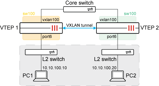

Topology
The following topology is used as an example configuration to demonstrate VXLAN troubleshooting steps.
In this example, two FortiGates are configured as VXLAN tunnel endpoints (VTEPs). A VXLAN is configured to allow L2 connectivity between the networks behind each FortiGate. The VXLAN interface and port6 are placed on the same L2 network using a software switch (sw100). An L2 network is formed between PC1 and PC2.
The VTEPs have the following MAC address tables:
Interface/endpoint
VTEP 1
VTEP 2
vxlan100
7e:f2:d1:84:75:0f
ca:fa:31:23:8d:c1
port6
00:0c:29:4e:5c:1c
00:0c:29:d0:3e:0d
sw100
00:0c:29:4e:5c:1c
00:0c:29:d0:3e:0d
The MAC address of PC1 is 00:0c:29:90:4f:bf. The MAC address of PC2 is 00:0c:29:f0:88:2c.

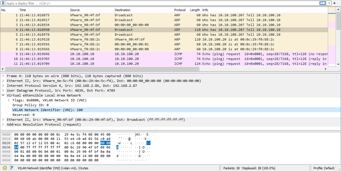

  5. Perform a sniffer trace on the VTEP 1 FortiGate to view the life of the packets as they pass through the FortiGate:
    # diagnose sniffer packet any 'host 10.10.100.20 or (udp and host 192.168.2.87)' 4 0 l
    Using Original Sniffing Mode
    interfaces=[any]
    filters=[host 10.10.100.20 or (udp and host 192.168.2.87)]
    2022-11-04 14:35:18.567602 port6 in arp who-has 10.10.100.20 tell 10.10.100.10
    2022-11-04 14:35:18.567629 vxlan100 out arp who-has 10.10.100.20 tell 10.10.100.10
    2022-11-04 14:35:18.567642 port2 out 192.168.2.86.4804 -> 192.168.2.87.4789: udp 68
    2022-11-04 14:35:18.567658 sw100 in arp who-has 10.10.100.20 tell 10.10.100.10
    2022-11-04 14:35:18.568239 port2 in 192.168.2.87.4789 -> 192.168.2.86.4789: udp 68
    2022-11-04 14:35:18.568263 vxlan100 in arp reply 10.10.100.20 is-at 00:0c:29:f0:88:2c
    2022-11-04 14:35:18.568272 port6 out arp reply 10.10.100.20 is-at 00:0c:29:f0:88:2c
    2022-11-04 14:35:18.568425 port6 in 10.10.100.10 -> 10.10.100.20: icmp: echo request
    2022-11-04 14:35:18.568435 vxlan100 out 10.10.100.10 -> 10.10.100.20: icmp: echo request
    2022-11-04 14:35:18.568443 port2 out 192.168.2.86.4805 -> 192.168.2.87.4789: udp 82
    2022-11-04 14:35:18.568912 port2 in 192.168.2.87.4789 -> 192.168.2.86.4789: udp 68
    2022-11-04 14:35:18.568925 vxlan100 in arp who-has 10.10.100.10 tell 10.10.100.20
    2022-11-04 14:35:18.568935 port6 out arp who-has 10.10.100.10 tell 10.10.100.20
    2022-11-04 14:35:18.568945 sw100 in arp who-has 10.10.100.10 tell 10.10.100.20
    2022-11-04 14:35:18.569070 port6 in arp reply 10.10.100.10 is-at 00:0c:29:90:4f:bf
    2022-11-04 14:35:18.569076 vxlan100 out arp reply 10.10.100.10 is-at 00:0c:29:90:4f:bf
    2022-11-04 14:35:18.569081 port2 out 192.168.2.86.4806 -> 192.168.2.87.4789: udp 68
    2022-11-04 14:35:18.569417 port2 in 192.168.2.87.4789 -> 192.168.2.86.4789: udp 82
    2022-11-04 14:35:18.569427 vxlan100 in 10.10.100.20 -> 10.10.100.10: icmp: echo reply
    2022-11-04 14:35:18.569431 port6 out 10.10.100.20 -> 10.10.100.10: icmp: echo reply
    In the output, the following packet sequence is seen on the FortiGate:
    1. The FortiGate receives an ARP request from PC1 10.10.100.10 on port6.
    2. The ARP request is forwarded to vxlan100 on the same software switch, where it gets encapsulated and sent out as a UDP port 4789 packet on port2.
    3. A reply is received on port2 from the remote VTEP with the ARP response encapsulated in UDP port 4789 again.
    4. The ARP reply is forwarded back out of port6 to PC1.
    5. PC1 sends the ICMP request using the same steps.
  6. Perform the same sniffer trace filter with a level 6 verbose level. In this example, the packet capture is converted into a Wireshark file.
    The packet that leaves the physical port2 is encapsulated in UDP and has a VXLAN header with VNI 100 as the identifier. There is an additional 50 B overhead of the UDP encapsulated VXLAN packets as opposed to the unencapsulated packets (for example, packet 4 versus packets 1 and 2).

  1. Start a ping from PC1 10.10.100.10 to PC2 10.10.100.20:
