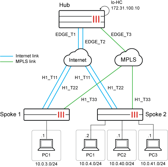

Network Topology
In this example, BGP per overlay was used for dynamic routing to distribute the LAN routes behind each spoke to the other spoke. However, this was a design choice. You can also use BGP on loopback for this example.
Spokes 1 and 2 have the following VPN overlays between themselves and the hub:
VPN Overlays |
IP address on Spoke 1 |
IP address on Spoke 2 |
H1_T11 |
172.31.80.1/32 |
172.31.80.2/32 |
H1_T22 |
172.31.81.1/32 |
172.31.81.2/32 |
H1_T33 |
172.31.82.1/32 |
172.31.82.2/32 |

From the diagnostic command on Spoke 1, we observe the newly selected shortcut paths in bold. (Note that the remote IP 172.31.80.2 matches Spoke 2 H1_T11, which is the VPN overlay over the Internet link with cost 100 in the corresponding table above.)
# diagnose sys sdwan advpn-session Session head(Branch2_FGT-0-overlay:3) (1) Service ID(1), last access(8293060), remote health check info(3) Selected path: local(H1_T11, port1) gw: 172.31.3.1 remote IP: 172.31.3.101(172.31.80.2) Remote information: 1: latency: 0.119500 jitter: 0.006067 pktloss: 0.000000 mos: 4.404329 sla: 0x1 cost: 0 transport_group: 2 bandwidth up: 999999 down: 999997 bidirection: 1999996 ipv4: 172.31.4.101(172.31.82.2) ipv6 180:adfb::d88a:93ee:7f00:0(d88a:93ee:7f00:0:d88a:93ee:7f00:0) 2: latency: 250.170761 jitter: 0.011500 pktloss: 0.000000 mos: 3.992655 sla: 0x0 cost: 0 transport_group: 1 bandwidth up: 999994 down: 999997 bidirection: 1999991 ipv4: 172.31.3.105(172.31.81.2) ipv6 2000:172:31:3::105(c010:4b02::788a:93ee:7f00:0) 3: latency: 0.182200 jitter: 0.012000 pktloss: 0.000000 mos: 4.404292 sla: 0x1 cost: 100 transport_group: 1 bandwidth up: 999999 down: 999997 bidirection: 1999996 ipv4: 172.31.3.101(172.31.80.2) ipv6 2000:172:31:3::101(::) (1) Service ID(2), last access(8293060), remote health check info(3) Selected path: local(H1_T22, port2) gw: 172.31.3.5 remote IP: 172.31.3.101(172.31.80.2) Remote information: 1: latency: 0.119500 jitter: 0.006067 pktloss: 0.000000 mos: 4.404329 sla: 0x1 cost: 0 transport_group: 2 bandwidth up: 999999 down: 999997 bidirection: 1999996 ipv4: 172.31.4.101(172.31.82.2) ipv6 180:adfb::d88a:93ee:7f00:0(d88a:93ee:7f00:0:d88a:93ee:7f00:0) 2: latency: 250.170761 jitter: 0.011500 pktloss: 0.000000 mos: 3.992655 sla: 0x0 cost: 0 transport_group: 1 bandwidth up: 999994 down: 999997 bidirection: 1999991 ipv4: 172.31.3.105(172.31.81.2) ipv6 2000:172:31:3::105(c010:4b02::788a:93ee:7f00:0) 3: latency: 0.182200 jitter: 0.012000 pktloss: 0.000000 mos: 4.404292 sla: 0x1 cost: 100 transport_group: 1 bandwidth up: 999999 down: 999997 bidirection: 1999996 ipv4: 172.31.3.101(172.31.80.2) ipv6 2000:172:31:3::101(::)
From the diagnostic command on Spoke 2, we observe the selected shortcuts in bold:
Branch2_FGT# diagnose sys sdwan health-check Health Check(HUB): Seq(3 H1_T33): state(alive), packet-loss(0.000%) latency(0.120), jitter(0.007), mos(4.404), bandwidth-up(999999), bandwidth-dw(999997), bandwidth-bi(1999996) sla_map=0x1 Seq(3 H1_T33_0): state(alive), packet-loss(0.000%) latency(0.128), jitter(0.003), mos(4.404), bandwidth-up(1000000), bandwidth-dw(1000000), bandwidth-bi(2000000) sla_map=0x1 Seq(1 H1_T11): state(alive), packet-loss(0.000%) latency(0.180), jitter(0.008), mos(4.404), bandwidth-up(999999), bandwidth-dw(999997), bandwidth-bi(1999996) sla_map=0x1 Seq(1 H1_T11_0): state(alive), packet-loss(0.000%) latency(0.259), jitter(0.023), mos(4.404), bandwidth-up(1000000), bandwidth-dw(1000000), bandwidth-bi(2000000) sla_map=0x1 Seq(1 H1_T11_1): state(alive), packet-loss(0.000%) latency(0.257), jitter(0.014), mos(4.404), bandwidth-up(1000000), bandwidth-dw(1000000), bandwidth-bi(2000000) sla_map=0x1 Seq(2 H1_T22): state(alive), packet-loss(0.000%) latency(250.169), jitter(0.009), mos(3.993), bandwidth-up(999994), bandwidth-dw(999997), bandwidth-bi(1999991) sla_map=0x0 Seq(2 H1_T22_1): state(alive), packet-loss(0.000%) latency(0.245), jitter(0.013), mos(4.404), bandwidth-up(1000000), bandwidth-dw(1000000), bandwidth-bi(2000000) sla_map=0x1 Seq(2 H1_T22_0): state(alive), packet-loss(0.000%) latency(0.223), jitter(0.005), mos(4.404), bandwidth-up(1000000), bandwidth-dw(1000000), bandwidth-bi(2000000) sla_map=0x1
Scenario 5: Traffic matching SD-WAN rule configured for load balancing
This example relies on the same Network Topology used above, except Spoke 1 has a single SD-WAN rule/service that uses the load balancing strategy with SLA targets. For details, see Load balancing strategy with SLA targets.
This section shows the SD-WAN configuration, selected IPsec configuration, and health check status on Spoke 1: and Spoke 2::

In this scenario, PC1 connected to Spoke 1 initiates an ICMP ping destined for PC1 connected to Spoke 2. Therefore, this user traffic matches SD-WAN rule 1 and triggers shortcut path selection and establishment.
On Spoke 1, in the IKE debug (diagnose debug application ike -1), debug messages indicate that multiple direct shortcut-query packets are being sent to Spoke 2:
ike :VWL_ADVPN_MSG_T_TRIGGER ike V=root:0 looking up shortcut by addr 172.31.80.2, resp-name:H1_T11, name H1_T22, peer-addr 172.31.3.101:0 ike V=root:0:H1_T22: send shortcut-query ... ike :VWL_ADVPN_MSG_T_TRIGGER ike V=root:0 looking up shortcut by addr 172.31.81.2, resp-name:H1_T22, name H1_T22, peer-addr 172.31.3.105:0 ike V=root:0:H1_T22: send shortcut-query ... ike :VWL_ADVPN_MSG_T_TRIGGER ike V=root:0 looking up shortcut by addr 172.31.82.2, resp-name:H1_T33, name H1_T33, peer-addr 172.31.4.101:0 ike V=root:0:H1_T33: send shortcut-query ...
From the diagnostic command on Spoke 1, observe that multiple shortcuts are triggered in bold based on the ADVPN 2.0 path management calculation where in-SLA overlays within the same transport group were selected.
