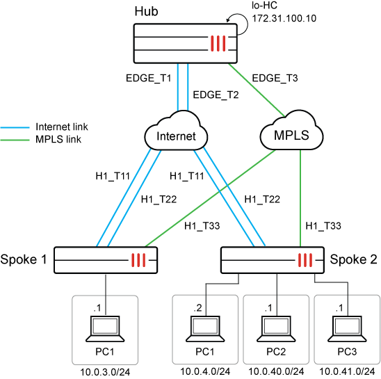

Network Topology
In this example, BGP per overlay was used for dynamic routing to distribute the LAN routes behind each spoke to the other spoke. However, this was a design choice. You can also use BGP on loopback for this example.
Spokes 1 and 2 have the following VPN overlays between themselves and the hub:
VPN Overlays
IP address on Spoke 1
IP address on Spoke 2
H1_T11
172.31.80.1/32
172.31.80.2/32
H1_T22
172.31.81.1/32
172.31.81.2/32
H1_T33
172.31.82.1/32
172.31.82.2/32

Throughout this example, transport group 1 is used for VPN overlays over Internet links while transport group 2 is used for the VPN overlay over an MPLS link.
In this example, user traffic is initiated behind Spoke 1 and destined to Spoke 2. Because of this, Spoke 1 is considered the local spoke, and Spoke 2 is considered the remote spoke.

Example SD-WAN configurations using ADVPN 2.0
The configuration example illustrates the edge discovery and path management processes for a typical hub and spoke topology. This example focuses on SD-WAN configuration for steering traffic and establishing shortcuts in the direction from Spoke 1 to Spoke 2.
Currently, ADVPN 2.0 only supports IPv4.
Network Topology
VPN Overlays
H1_T11
172.31.80.1/32
172.31.80.2/32
H1_T22
172.31.81.1/32
172.31.81.2/32
H1_T33
172.31.82.1/32
172.31.82.2/32
SD-WAN Rules/Services defined on Spoke 1:
SD-WAN Rule/Service 1
SD-WAN Rule/Service 2
SD-WAN Rule/Service 3
H1_T11
H1_T22
H1_T33
H1_T22
H1_T11
H1_T11
H1_T33
H1_T33
H1_T22
Strategy for choosing outgoing interfaces
Lowest cost (SLA)
Lowest cost (SLA)
Best quality, link cost factor: packet loss
SD-WAN configuration and health check status
SD-WAN configuration and health check status on Spoke 1:
