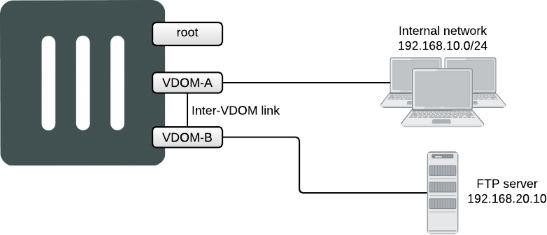

The following examples show how to configure per-VDOM settings, such as operation mode, routing, and security policies, in a network that includes the following VDOMs:
- VDOM-A: allows the internal network to access the Internet.
- VDOM-B: allows external connections to an FTP server.
- root: the management VDOM.

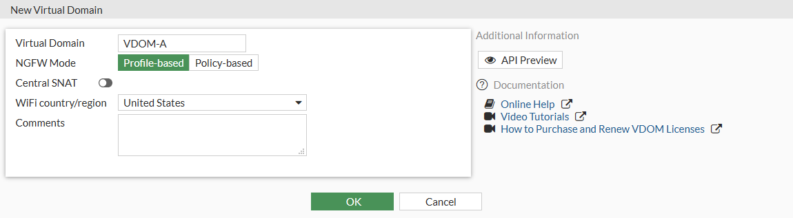

To create the VDOMs in the GUI:
- In the Global VDOM, go to System > VDOM and click Create New.
- In the Virtual Domain field, enter VDOM-A.
- If required, set the NGFW Mode. If the NGFW Mode is Profile-based, Central SNAT can be enabled.
- Click OK to create the VDOM.
- Repeat the above steps for VDOM-B.
