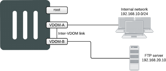

The following examples show how to configure per-VDOM settings, such as operation mode, routing, and security policies, in a network that includes the following VDOMs:
- VDOM-A: allows the internal network to access the Internet.
- VDOM-B: allows external connections to an FTP server.
- root: the management VDOM.
You can use VDOMs in either NAT or transparent mode on the same FortiGate. By default, VDOMs operate in NAT mode.
For both examples, multi VDOM mode must be enabled, and VDOM-A and VDOM-B must be created.
