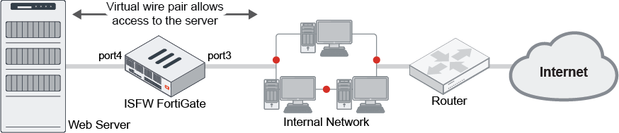

A virtual wire pair consists of two interfaces that do not have IP addressing and are treated like a transparent mode VDOM. All traffic received by one interface in the virtual wire pair can only be forwarded to the other interface, provided a virtual wire pair firewall policy allows this traffic. Traffic from other interfaces cannot be routed to the interfaces in a virtual wire pair. Redundant and 802.3ad aggregate (LACP) interfaces can be included in a virtual wire pair.
Virtual wire pairs are useful for a typical topology where MAC addresses do not behave normally. For example, port pairing can be used in a Direct Server Return (DSR) topology where the response MAC address pair may not match the request’s MAC address pair.
Example
In this example, a virtual wire pair (port3 and port4) makes it easier to protect a web server that is behind a FortiGate operating as an Internal Segmentation Firewall (ISFW). Users on the internal network access the web server through the ISFW over the virtual wire pair.
Interfaces used in a virtual wire pair cannot be used to access the ISFW FortiGate. Before creating a virtual wire pair, make sure you have a different port configured to allow admin access using your preferred protocol.

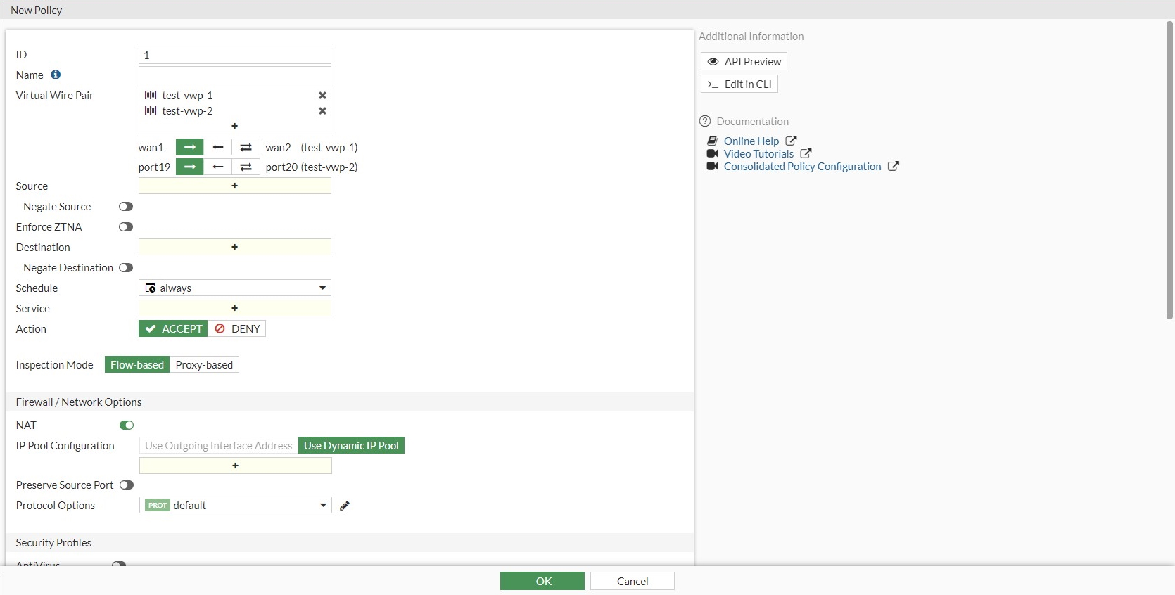

Configuring multiple virtual wire pairs in a virtual wire pair policy
You can create a virtual wire pair policy that includes different virtual wire pairs in NGFW profile and policy mode. This reduces overhead to create multiple similar policies for each VWP. In NGFW policy mode, multiple virtual wire pairs can be configured in a Security Virtual Wire Pair Policy and Virtual Wire Pair SSL Inspection & Authentication policy.
The virtual wire pair settings must have wildcard VLAN enabled. When configuring a policy in the CLI, the virtual wire pair members must be entered in srcintf and dstintf as pairs.
To configure multiple virtual wire pairs in a policy in the GUI:
  1. Configure the virtual wire pairs:
    1. Go to Network > Interfaces and click Create New > Virtual Wire Pair.
    2. Create a pair with the following settings:
      Name
      test-vwp-1
      Interface members
      wan1, wan2
      Wildcard VLAN
      Enable
    3. Click OK.
    4. Click Create New > Virtual Wire Pair and create another pair with the following settings:
      Name
      test-vwp-2
      Interface members
      port19, port20
      Wildcard VLAN
      Enable
    5. Click OK.
  2. Configure the policy:
    1. Go to Policy & Objects > Firewall Virtual Wire Pair Policy and click Create New.
    2. In the Virtual Wire Pair field, click the + to add test-vwp-1 and test-vwp-2. Select the direction for each of the selected virtual wire pairs.
    4. Click OK.
