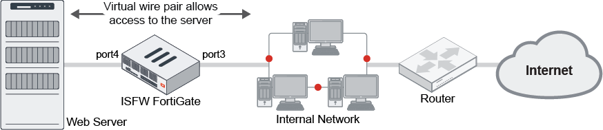

In this example, a virtual wire pair (port3 and port4) makes it easier to protect a web server that is behind a FortiGate operating as an Internal Segmentation Firewall (ISFW). Users on the internal network access the web server through the ISFW over the virtual wire pair.
Interfaces used in a virtual wire pair cannot be used to access the ISFW FortiGate. Before creating a virtual wire pair, make sure you have a different port configured to allow admin access using your preferred protocol. |

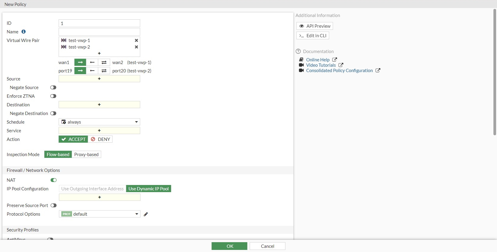

Configure the policy:
Go to Policy & Objects > Firewall Virtual Wire Pair Policy and click Create New.
In the Virtual Wire Pair field, click the + to add test-vwp-1 and test-vwp-2. Select the direction for each of the selected virtual wire pairs.
Configure the other settings as needed.
Click OK.
