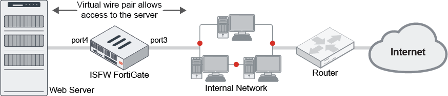

Example
In this example, a virtual wire pair (port3 and port4) makes it easier to protect a web server that is behind a FortiGate operating as an Internal Segmentation Firewall (ISFW). Users on the internal network access the web server through the ISFW over the virtual wire pair.
Interfaces used in a virtual wire pair cannot be used to access the ISFW FortiGate. Before creating a virtual wire pair, make sure you have a different port configured to allow admin access using your preferred protocol. |

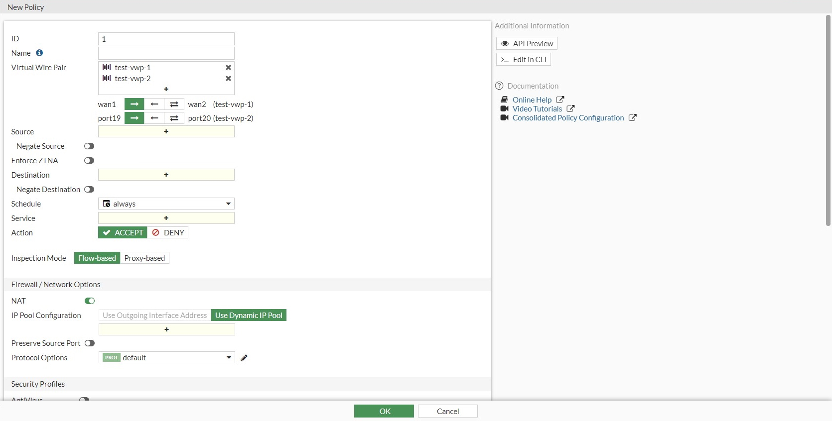

Configuring multiple virtual wire pairs in a virtual wire pair policy
You can create a virtual wire pair policy that includes different virtual wire pairs in NGFW profile and policy mode. This reduces overhead to create multiple similar policies for each VWP. In NGFW policy mode, multiple virtual wire pairs can be configured in a Security Virtual Wire Pair Policy and Virtual Wire Pair SSL Inspection & Authentication policy.
The virtual wire pair settings must have wildcard VLAN enabled. When configuring a policy in the CLI, the virtual wire pair members must be entered in srcintf and dstintf as pairs.

Configure the policy:
Go to Policy & Objects > Firewall Virtual Wire Pair Policy and click Create New.
In the Virtual Wire Pair field, click the + to add test-vwp-1 and test-vwp-2. Select the direction for each of the selected virtual wire pairs.
Configure the other settings as needed.
Click OK.
