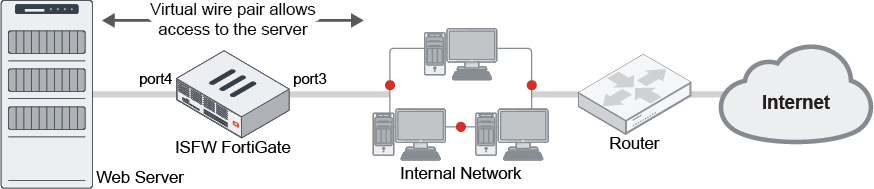

In this example, a virtual wire pair (port3 and port4) makes it easier to protect a web server that is behind a FortiGate operating as an Internal Segmentation Firewall (ISFW). Users on the internal network access the web server through the ISFW over the virtual wire pair.
Interfaces used in a virtual wire pair cannot be used to access the ISFW FortiGate. Before creating a virtual wire pair, make sure you have a different port configured to allow admin access using your preferred protocol.
