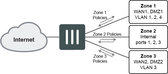

For example, in the sample configuration below, the network includes three separate groups of users representing different entities on the company network. While each group has its own set of ports and VLANs in each area, they can all use the same security policy and protection profiles to access the Internet. Rather than the administrator making nine separate security policies, he can make administration simpler by adding the required interfaces to a zone and creating three policies.
Sample configuration
You can configure policies for connections to and from a zone but not between interfaces in a zone. For this example, you can create a security policy to go between zone 1 and zone 3, but not between WAN2 and WAN1, or WAN1 and DMZ1.
