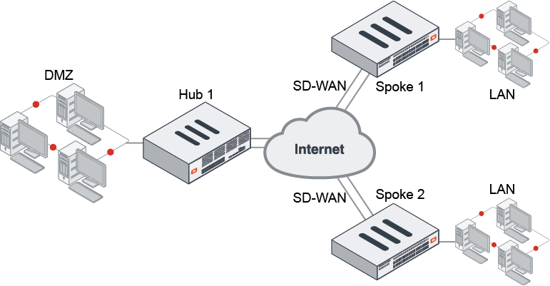

BGP multiple path support
BGP supports multiple paths, allowing an ADVPN to advertise multiple paths. This allows BGP to extend and keep additional network paths according to RFC 7911.
In this example, Spoke1 and Spoke2 each have four VPN tunnels that are connected to the Hub with ADVPN. The Spoke-Hub has established four BGP neighbors on all four tunnels.
Spoke 1 and Spoke 2 can learn four different routes from each other.
