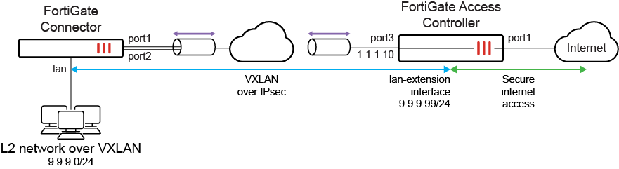

In this example, the Controller provides secure internet access to the remote network behind the Connector. The Controller has two WAN connections: an inbound backhaul connection and an outbound internet connection. The Connector has two wired WAN/uplink ports that are connected to the internet.
After the Connector discovers the Controller and is authorized by the Controller, the Controller pushes a FortiGate LAN extension profile to the Connector. The Connector uses the profile configurations to form two IPsec tunnels back to the Controller. Additional VXLAN aggregate interfaces are automatically configured to create an L2 network between the Connector LAN port and a virtual LAN extension interface on the Controller. Clients behind the Connector can then connect to the internet through the Controller that is securing the internet connection.

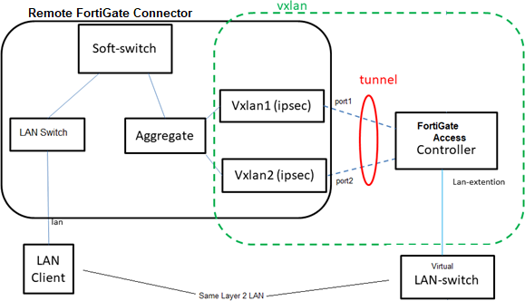

After the FortiGate Connector has been authorized, the Controller pushes the IPsec tunnel configuration to the Connector, forcing it to establish the tunnel and form the VXLAN mechanism.
The VXLANs are built on the IPsec tunnels between the Connector and Controller. The VXLAN interfaces are aggregated for load balancing and redundancy. A softswitch combines the aggregate interface with the local LAN ports, allowing the LAN ports to be part of the VXLAN. This combines the local LAN ports with the virtual LAN extension interface on the FortiGate Controller.
The Connector receives the IPsec configurations from the Controller, and automatically creates tunnels for each uplink:

An aggregate interface is automatically configured to load balance between the two VXLAN interfaces, using the source MAC and providing link redundancy:
config system interface edit "le-agg-link" set vdom "lan-ext" set type aggregate set member "vx-port1" "vx-port2" set snmp-index 35 set lacp-mode static set algorithm Source-MAC next end -
The softswitch is automatically configured and bridges the aggregate interface and the local LAN to connect the LAN to the VXLAN bridged L2 network that goes to the FortiGate LAN extension interface:
config system switch-interface edit "le-switch" set vdom "lan-ext" set member "le-agg-link" "lan" next end
To configure the LAN extension interface and firewall policy on the FortiGate Controller:
After the IPsec tunnel is setup and the VXLAN is created over the tunnel, the LAN extension interface is automatically created on the Controller:
config system interface edit "FGT60E0000000001" set vdom "root" set ip 192.168.0.254 255.255.255.0 set allowaccess ping ssh set type lan-extension set role lan set snmp-index 27 set ip-managed-by-fortiipam enable set interface "fg-ipsec-XdSpij" next endDevices on the remote LAN network will use this IP address as their gateway.
