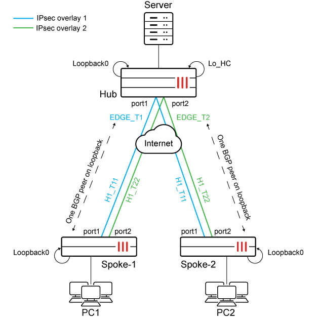

Path selection based on embedded SLA priorities
In this example, spokes are configured to embed the SLA priority in ICMP probes, and the hub is configured to use the information. With this configuration:
The spoke's overlay priority on each overlay is embedded in the ICMP probes and transported to the hub.
The hub sets priorities on IKE routes over different overlays based on the received overlay priorities.
On the hub, BGP routes, which are used to guide hub-to-spoke traffic, rely on IKE routes to be resolved to tunnels and inherit the priorities from the IKE routes.
The hub can steer traffic to spokes by resolved BGP routes with different inherited priorities.

After the spokes' overlay priorities are embedded in ICMP probes and transported to the hub, view the routing tables on the hub.
The hub sets overlay priorities on IKE routes over EDGE_T1 and EDGE_T2. Meanwhile, recursively resolved BGP routes inherit the priorities from those IKE routes.
