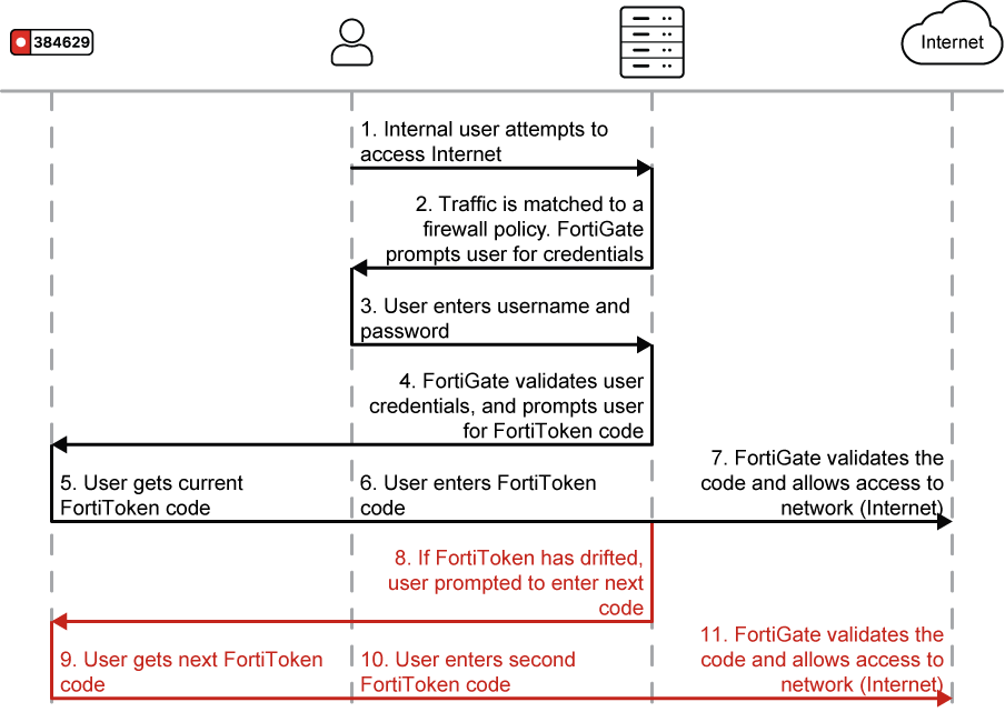

The following illustrates the FortiToken MFA process:
  1. The user attempts to access a network resource.
  2. FortiOS matches the traffic to an authentication security policy and prompts the user for their username and password.
  3. The user enters their username and password.
  4. FortiOS verifies their credentials. If valid, it prompts the user for the FortiToken code.
  5. The user views the current code on their FortiToken. They enter the code at the prompt.
  6. FortiOS verifies the FortiToken code. If valid, it allows the user access to network resources.
If the FortiToken has drifted, the following must take place for the FortiToken to resynchronize with FortiOS:
  1. FortiOS prompts the user to enter a second code to confirm.
  2. The user gets the next code from the FortiToken. They enter the code at the prompt.
  3. FortiOS uses both codes to update its clock to match the FortiToken.
