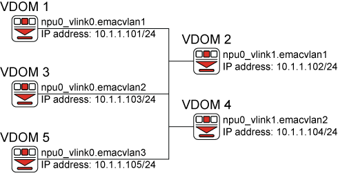

Example 2: Enhanced MAC VLAN configuration for shared VDOM links among multiple VDOMs
In this example, multiple VDOMs can connect to each other using enhanced MAC VLAN on network processing unit (NPU) virtual link (Vlink) interfaces.
FortiGate VDOM links (NPU-Vlink) are designed to be peer-to-peer connections and VLAN interfaces on NPU Vlink ports use the same MAC address. Connecting more than two VDOMs using NPU Vlinks and VLAN interfaces is not recommended as the VLAN interfaces share the same MAC address. To avoid overlapping MAC addresses on the same NPU Vlink, use EMAC VLANs instead.
To configure enhanced MAC VLAN for this example in the CLI:
config system interface
edit npu0_vlink0.emacvlan1
set vdom VDOM1
set type emac-vlan
set interface npu0_vlink0
edit npu0_vlink0.emacvlan2
set vdom VDOM3
set type emac-vlan
edit npu0_vlink1.emacvlan1
set vdom VDOM2
set type emac-vlan
set interface npu0_vlink1
