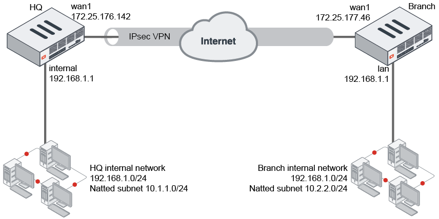

This is a sample configuration of IPsec VPN to allow transparent communication between two overlapping networks that are located behind different FortiGates using a route-based tunnel with source and destination NAT.
In the following topology, both FortiGates (HQ and Branch) use 192.168.1.0/24 as their internal network, but both networks need to be able to communicate to each other through the IPsec tunnel.
New virtual subnets of equal size must be configured and used for all communication between the two overlapping subnets. The devices on both local networks do not need to change their IP addresses. However, the devices and users must use the new subnet range of the remote network to communicate across the tunnel.

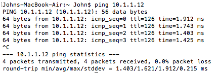

To verify the communication across the tunnel:
  1. Go to Dashboard > Network and click the IPsec widget to expand to full screen view. The tunnels should be up on both FortiGates. If you did not enable Auto-negotiate in the IPsec VPN settings, you may have to select the tunnel and click Bring Up.
  2. From a PC on the HQ network, ping a PC on the Branch network using the new IP for the Branch PC. The ping should be successful.
  3. From a PC on the Branch network, ping a PC on the HQ network using the new IP for the HQ PC. The ping should be successful.
