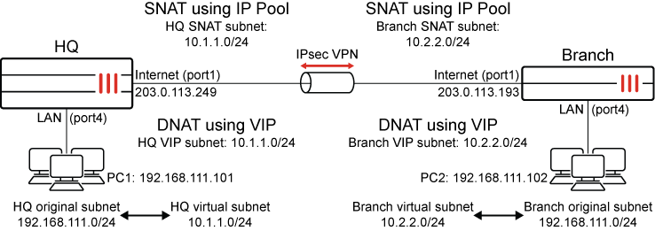

Overlapping subnets in IPsec occur when two or more networks involved in a VPN tunnel use the same or overlapping IP address ranges. This creates a conflict, as IPsec relies on unique network subnets to route traffic securely between them. Overlapping subnets often occur when two networks with the same IP ranges need to communicate, such as in mergers or acquisitions.
This example shows the configuration steps required to set up an IPsec VPN that enables communication between two overlapping networks located behind separate FortiGates using a route-based tunnel. Both source NAT (SNAT) and destination NAT (DNAT) are used to resolve IP conflicts.
Both the HQ and Branch FortiGates use the same overlapping internal subnet, 192.168.111.0/24. To establish communication between these networks over the IPsec tunnel, address translation is required to distinguish between the identical subnets. Without SNAT and DNAT, routing traffic between these overlapping networks would lead to conflicts, as networking devices cannot differentiate between identical IP addresses.
To resolve this issue, a unique and non-overlapping subnet is used on both FortiGates for address translation during transit.
  • On the HQ FortiGate, the IP addresses of the HQ original subnet are logically one-to-one mapped to IP address in the HQ virtual subnet of 10.1.1.0/24.
  • On the Branch FortiGate, the IP addresses of the Branch original subnet are logically one-to-one mapped to IP address in the Branch virtual subnet of 10.2.2.0/24.
The virtual subnets must be the same size as the overlapping subnet to cover the entire IP address range in the subnet and avoid network issues. The virtual subnets are used for SNAT using IP Pools and DNAT using virtual IP (VIP) configurations, ensuring that traffic originating from the overlapped subnets is translated according to the respective virtual subnets for communication.
After the configuration is complete, users that are in the HQ original subnet (192.168.111.0/24) are required to use the Branch virtual subnet (10.2.2.0/24) to communicate with users that are behind the Branch. Users that are in the Branch original subnet (192.168.111.0/24) are required to use the HQ virtual subnet (10.1.1.0/24) to communicate with users that are behind the HQ.
Source
Destination
Used subnet
HQ
Branch
Branch
HQ
This ensures seamless communication across the IPsec tunnel while resolving the challenges posed by overlapping subnets.

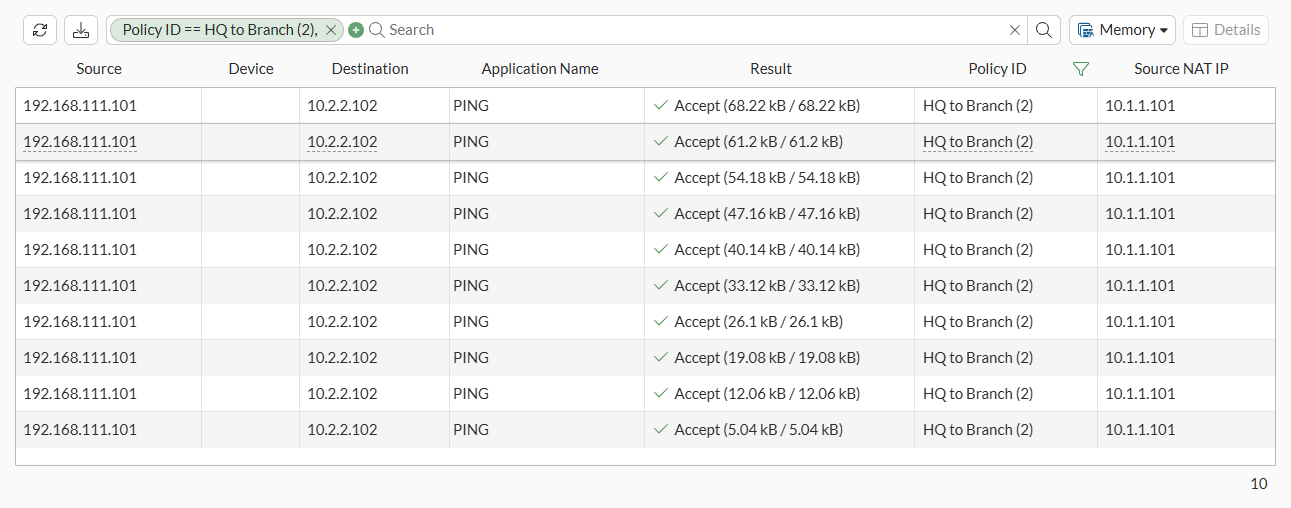

Verification
To verify the status of IPsec tunnel in the GUI:
  1. On either FortiGate, go to Dashboard > Network Monitor > VPN.
  2. The tunnels should be up on both FortiGates. If you did not enable Auto-negotiate in the IPsec VPN settings, you may have to select the tunnel and click Bring Up.
To verify the status of IPsec tunnel in the CLI:
  1. Verify the status of Phase 1:
    Branch # diagnose vpn ike gateway list name BranchtoHQVPN
    vd: root/0
    version: 2
    interface: port1 3
    addr: 203.0.113.193:4500 -> 203.0.113.249:4500
    tun_id: 203.0.113.249/::203.0.113.249
    remote_location: 0.0.0.0
    network-id: 0
    transport: UDP

To verify the traffic flow from PC1 to PC2 in the GUI:
  1. On either FortiGate, go to Log & Report > Forward Traffic.
  2. Filter the content using the search bar and add the required columns to see the logs.
To make sure that the logs are collected and shown under Forward Traffic, set Log Allowed Traffic to All Sessions in the corresponding firewall policy configured under Policy & Objects > Firewall Policy.

Site-to-site VPN with overlapping subnets
Source
Destination
Used subnet
HQ
Branch
Branch
HQ

To configure the address objects:
  1. Go to Policy & Objects > Addresses > Address.
  2. Click Create new and configure an address object for HQ original subnet:
    Field
    Value
    Name
    Interface
    Any
    Type
    Subnet
    IP/Netmask
    192.168.111.0/24
    Routing configuration
    Disable
  3. Click OK.
  4. Click Create new again and configure an address object for Branch virtual subnet:
    Field
    Value
    Name
    HQ virtual subnet
    Interface
    Any
    Type
    Subnet
    IP/Netmask
    10.1.1.0/24
    Disable
  5. Click OK
To configure the IP pool for SNAT:
  1. Go to Policy & Objects > IP Pools and click Create new.
  2. Configure the dynamic IP pool:
    Field
    Value
    Name
    Branch SNAT subnet
    Type
    Fixed Port Range
    External IP Range
    10.2.2.1-10.2.2.254
    Internal IP Range
    192.168.111.1-192.168.111.254
  3. Leave the remaining settings as their default values and click OK.
To configure the VIP for DNAT:
  1. Go to Policy & Objects > Virtual IPs > Virtual IP and click Create New.
  2. Configure the virtual IP:
    Field
    Value
    Name
    Branch VIP subnet
    Type
    Static NAT
    External IP address/range
    10.2.2.1-10.2.2.254
    Map to IPv4 address/range
    192.168.111.1
  3. Click OK.
To configure the firewall policies:
  2. Configure the policy to allow traffic to flow from the HQ original subnet to the Branch virtual subnet and to perform SNAT:
    Field
    Value
    Name
    Branch to HQ
    Incoming interface
    LAN (port4)
    Outgoing interface
    BranchtoHQVPN
    Source
    Destination
    HQ virtual subnet
    Service
    ALL
    NAT
    Enable
    IP pool configuration
    Use Dynamic IP Pool
    Branch SNAT subnet IP
  3. Configure the remaining settings as needed, then click OK.
  4. Click Create New again and configure the policy to allow traffic to flow from the Branch virtual subnet to the HQ original subnet and to perform DNAT:
    Field
    Value
    Name
    HQ to Branch
    Incoming interface
    BranchtoHQVPN
    Outgoing interface
    LAN (port4)
    Source
    HQ virtual subnet
    Destination
    Branch VIP subnet (the virtual IP/server to perform DNAT)
    Service
    ALL
    NAT
    Disable
  5. Configure the remaining settings as needed, then click OK.
