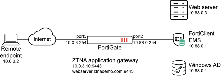

This example expands on the previous example (ZTNA HTTPS access proxy example), adding LDAP authentication to the ZTNA rule. Users are allowed based on passing the client certificate authentication check, user authentication, and security posture check.
Users that are in the AD security group ALLOWED-VPN are allowed access to the access proxy. Users that are not part of this security group are not allowed access.
This example assumes that the FortiGate EMS fabric connector is already successfully connected.

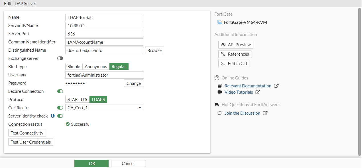

To configure a secure connection to the LDAP server in the GUI:
  1. Go to User & Authentication > LDAP Servers and click Create New.
  2. Configure the following settings:
    Name
    LDAP-fortiad
    Server IP/Name
    10.88.0.1
    Server Port
    636
    Common Name Identifier
    sAMAccountName
    Distinguished Name
    dc=fortiad,dc=info
    Exchange server
    Disabled
    Bind Type
    Regular
    Enter the Username and Password for LDAP binding and lookup.
    Secure Connection
    Enabled
    • Set Protocol to LDAPS
    • Enable Certificate and select the CA certificate to validate the server certificate.
    Server identity check
    Optionally, enable to verify the domain name or IP address against the server certificate.
  3. Click Test Connectivity to verify the connection to the server.
  4. Click OK.
To configure a secure connection to the LDAP server in the CLI:
config user ldap
    edit "LDAP-fortiad"
        set server "10.88.0.1"
        set cnid "sAMAccountName"
        set dn "dc=fortiad,dc=info"
        set type regular
        set username "fortiad\\Administrator"
        set password <password>
        set secure ldaps
        set ca-cert "CA_Cert_1"
        set port 636

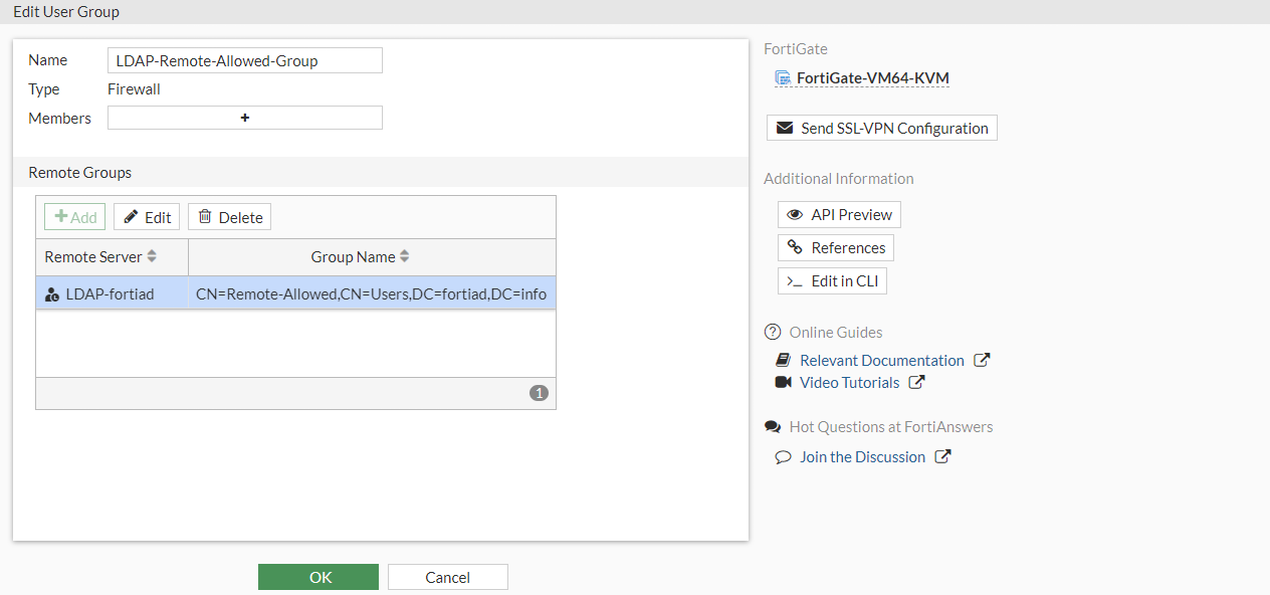

To configure a remote user group from the LDAP server in the GUI:
  1. Go to User & Authentication > User Groups and click Create New.
  2. Set the name to LDAP-Remote-Allowed-Group.
  3. Set Type to Firewall.
  4. In the Remote Groups table click Add:
    1. Set Remote Server to LDAP-fortiad.
    2. Locate the Remote-Allowed group, right-click on it, and click Add Selected.
    3. Click OK.
  5. Click OK.
To configure a remote user group from the LDAP server in the CLI:
config user group
    edit "LDAP-Remote-Allowed-Group"
        set member "LDAP-fortiad"
        config match
                set server-name "LDAP-fortiad"
                set group-name "CN=Remote-Allowed,CN=Users,DC=fortiad,DC=info"

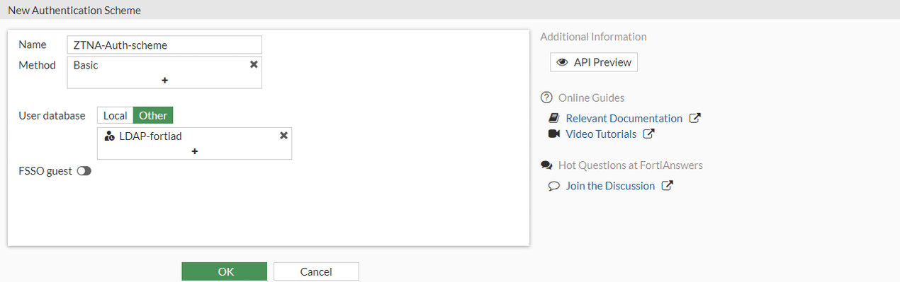

Authentication scheme
The authentication scheme defines the method of authentication that is applied. In this example, basic HTTP authentication is used so that users are prompted for a username and password the first time that they connect to a website through the HTTPS access proxy.
To configure an authentication scheme in the GUI:
  1. Go to Policy & Objects > Authentication Rules and click Create New > Authentication Scheme.
  2. Set the name to ZTNA-Auth-scheme.
  3. Set Method to Basic.
  4. Set User database to Other and select LDAP-fortiad as the LDAP server.
  5. Click OK.
To configure an authentication scheme in the CLI:
config authentication scheme
    edit "ZTNA-Auth-scheme"
        set method basic
        set user-database "LDAP-fortiad"
  5. Click OK.

Applying the user group to a ZTNA policy
A user or user group must be applied to the ZTNA policy that you need to control user access to. The authenticated user from the authentication scheme and rule must match the user or user group in the ZTNA policy.
In this example, the user group is applied to the two simple ZTNA policies that were configured in ZTNA HTTPS access proxy example.
To apply a user group to the simple ZTNA policies in the GUI:
  2. Edit the ZTNA-Deny-malicious rule.
  3. Click in the Source field, select the User tab, select the LDAP-Remote-Allowed-Group group, then click Close.
  4. Click OK.
  5. Edit the ZTNA-Allow-Simple rule.
  6. Click in the Source field, select the User tab, select the LDAP-Remote-ALlowed-Group group, then click Close.
  7. Click OK.
