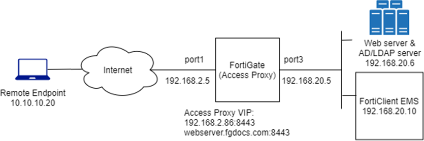

This example expands on the previous example (ZTNA HTTPS access proxy example), adding LDAP authentication to the ZTNA rule. Users are allowed based on passing the client certificate authentication check, user authentication, and security posture check.
Users that are in the AD security group ALLOWED-VPN are allowed access to the access proxy. Users that are not part of this security group are not allowed access.
This example assumes that the FortiGate EMS fabric connector is already successfully connected.

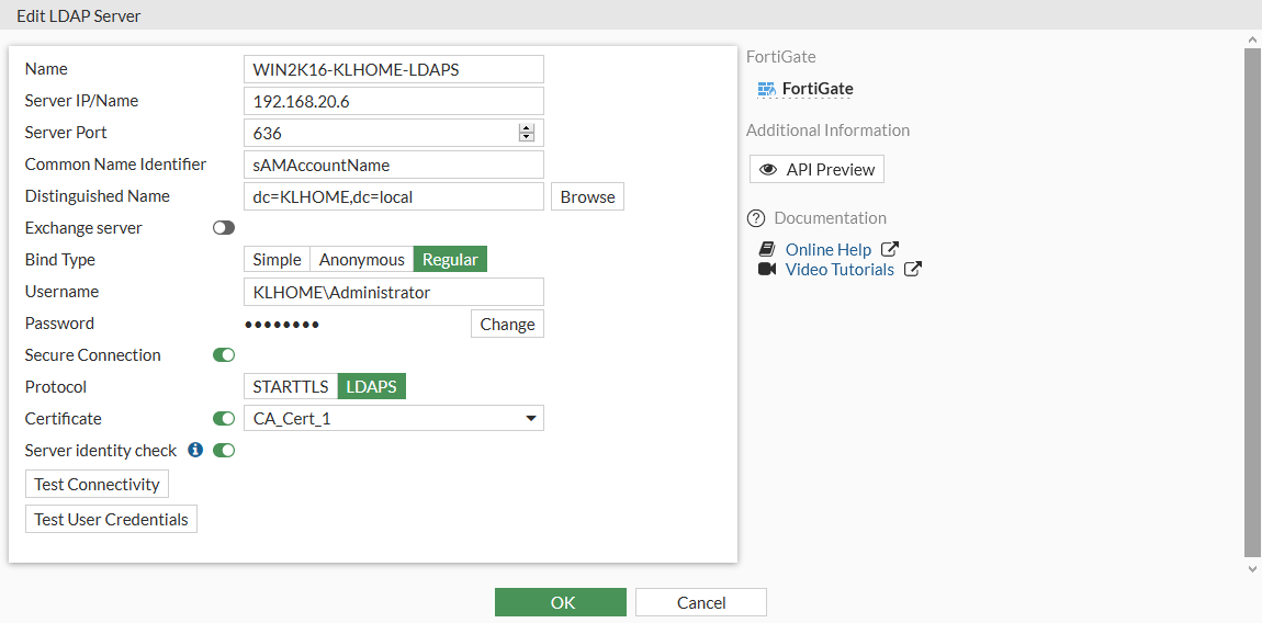

To configure a secure connection to the LDAP server in the GUI:
  1. Go to User & Authentication > LDAP Servers and click Create New.
  2. Configure the following settings:
    Name
    WIN2K16-KLHOME-LDAPS
    Server IP/Name
    192.168.20.6
    Server Port
    636
    Common Name Identifier
    sAMAccountName
    Distinguished Name
    dc=KLHOME,dc=local
    Exchange server
    Disabled
    Bind Type
    Regular
    Enter the Username and Password for LDAP binding and lookup.
    Secure Connection
    Enabled
    • Set Protocol to LDAPS
    • Enable Certificate and select the CA certificate to validate the server certificate.
    Server identity check
    Optionally, enable to verify the domain name or IP address against the server certificate.
  3. Click Test Connectivity to verify the connection to the server.
  4. Click OK.
To configure a secure connection to the LDAP server in the CLI:
config user ldap
    edit "WIN2K16-KLHOME-LDAPS"
        set server "192.168.20.6"
        set cnid "sAMAccountName"
        set dn "dc=KLHOME,dc=local"
        set type regular
        set username "KLHOME\\Administrator"
        set password <password>
        set secure ldaps
        set ca-cert "CA_Cert_1"
        set port 636

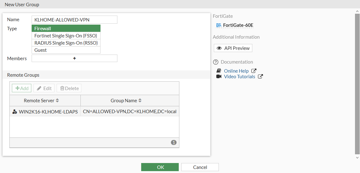

To configure a remote user group from the LDAP server in the GUI:
  1. Go to User & Authentication > User Groups and click Create New.
  2. Set the name to KLHOME-ALLOWED-VPN.
  3. Set Type to Firewall.
  4. In the Remote Groups table click Add:
    1. Set Remote Server to WIN2K16-KLHOME-LDAPS.
    2. Locate the ALLOWED-VPN group, right-click on it, and click Add Selected.
    3. Click OK.
  5. Click OK.
To configure a remote user group from the LDAP server in the CLI:
config user group
    edit "KLHOME-ALLOWED-VPN"
        set member "WIN2K16-KLHOME-LDAPS"
        config match
                set server-name "WIN2K16-KLHOME-LDAPS"
                set group-name "CN=ALLOWED-VPN,DC=KLHOME,DC=local"

Applying the user group to a ZTNA rule
A user or user group must be applied to the ZTNA rule that you need to control user access to. The authenticated user from the authentication scheme and rule must match the user or user group in the ZTNA rule.
In this example, the user group is applied to the two ZTNA rules that were configured in ZTNA HTTPS access proxy example.
To apply a user group to the ZTNA rules in the GUI:
  1. Go to Policy & Objects > ZTNA and select the ZTNA Rules tab.
  2. Edit the ZTNA-Deny-malicious rule.
  3. Click in the Source field, select the User tab, select the KLHOME-ALLOWED-VPN group, then click Close.
  4. Click OK.
  5. Edit the proxy-WIN2K16-P1 rule.
  6. Click in the Source field, select the User tab, select the KLHOME-ALLOWED-VPN group, then click Close.
  7. Click OK.

Testing remote access to the HTTPS access proxy with user authentication
Scenario 1: access allowed - user radCurtis
  1. On a remote Windows PC, open the FortiClient app, select the Zero Trust Telemetry tab, and confirm that you are connected to the EMS server.
    It is not necessary to configure a ZTNA Destination on the FortiClient for the HTTPS access proxy use case. In fact, configuring a ZTNA Destination rule for the website may interfere with its operation.
  2. In a browser, enter the address of the server and the access port.
    If entering an FQDN, make sure that DNS can resolve the address to the IP address of the FortiGate. In this example, winserver.fgdocs.com resolves to 192.168.2.86.
  3. When the browser asks for the client certificate to use, select the EMS signed certificate, then click OK.
    The client certificate is verified by the FortiGate to authenticate your identity.
  4. When prompted, enter the username radCurtis and the password, and click Sign in.
    As radCurtis is a member of the ALLOWED-VPN group in Active Directory, it will match the KLHOME-ALLOWED-VPN user group. After the user authentication passes, the FortiGate performs a posture check on the ZTNA group. When that passes, you are allowed access to the website.
