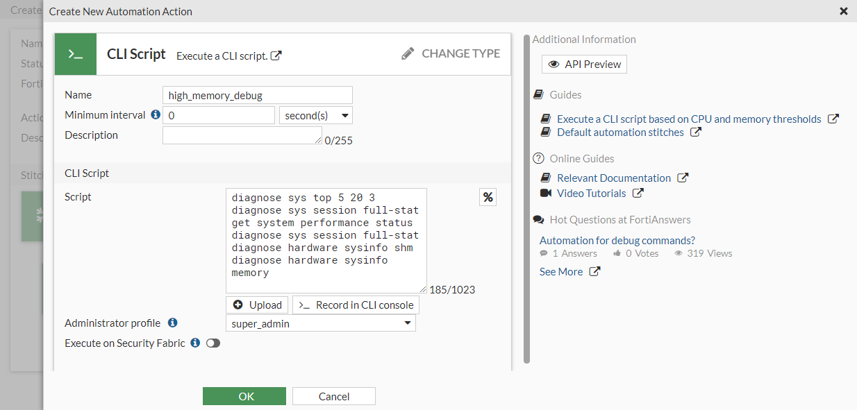

- Configure the CLI Script action:
- Click Add Action.
- Click Create and select CLI Script.
- Enter the following:
Name
high_memory_debug
Script
diagnose sys top 5 20 3 diagnose sys session full-stat get system performance status diagnose sys session full-stat diagnose hardware sysinfo shm diagnose hardware sysinfo memory
Administrator profile
Select a profile
- Click OK.

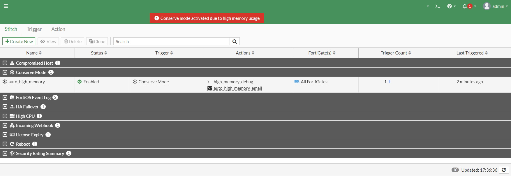

Results
When the FortiGate enters conserve mode due to the memory-use-threshold-red
being exceeded, the GUI displays a notice, and the auto_high_memory automation stitch is triggered. This causes the CLI script to run and the script results are emailed to the specified address.
Here is sample text from the email message:
CSF stitch alert: high_memory DoNotReply@notification.fortinet.net Tue 05/16/2023 5:34 PM ########## script name: autod.0 ########## ========== #1, 2023-05-16 17:34:17 ========== Client_Fgt $ diagnose sys top 5 20 3 Run Time: 0 days, 0 hours and 0 minutes 61U, 0N, 6S, 33I, 0WA, 0HI, 0SI, 0ST; 1356T, 129F ipshelper 2601 S < 61.6 8.0 0 ipsengine 2745 S < 4.9 8.5 0 cmdbsvr 2528 S N 0.0 7.9 0 cmdbsvr 2529 S 0.0 5.0 0 scanunitd 2610 S < 0.0 3.8 0 miglogd 2603 S 0.0 3.6 0 cw_acd 2634 S 0.0 3.4 0 node 2574 S 0.0 3.3 0 forticron 2584 S 0.0 2.9 0 miglogd 2693 S 0.0 2.8 0 reportd 2604 S 0.0 2.5 0 httpsd 2573 S 0.0 2.4 0 ...
