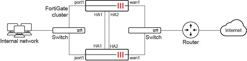

The FortiGate Clustering Protocol (FGCP) is a proprietary HA solution whereby FortiGates can find other member FortiGates to negotiate and create a cluster. A FortiGate HA cluster consists of at least two FortiGates (members) configured for HA operation. All FortiGates in the cluster must be the same model and have the same firmware installed. Cluster members must also have the same hardware configuration (such as the same number of hard disks). All cluster members share the same configurations except for their host name and priority in the HA settings. The cluster works like a device but always has a hot backup device.

- Identical heartbeat connections and interfaces: members will use this to communicate with each other. In general, a two-member cluster is most common. We recommend double back-to-back heartbeat connections (as demonstrated in the topology).
- Identical connections for internal and external interfaces: we recommend similar connections from each member to the switches for the cluster to function properly (as demonstrated in the topology).
The HA heartbeat interface communicates with each unit in the cluster using the same heartbeat interface for each member. For example, if port1 and port2 are the heartbeat interfaces for the HA cluster, then in a cluster consisting of two members:
