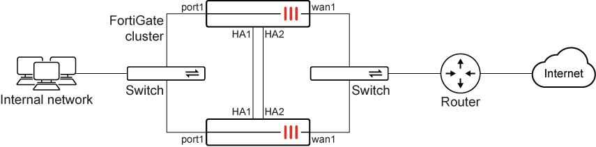

  • Identical heartbeat connections and interfaces: members will use this to communicate with each other. In general, a two-member cluster is most common. We recommend double back-to-back heartbeat connections (as demonstrated in the topology).
  • Identical connections for internal and external interfaces: we recommend similar connections from each member to the switches for the cluster to function properly (as demonstrated in the topology).
The HA heartbeat interface communicates with each unit in the cluster using the same heartbeat interface for each member.
For example, if port1 and port2 are the heartbeat interfaces for the HA cluster, then in a cluster consisting of two members:
  • port1 of the primary FortiGate should be connected to port1 of the secondary FortiGate.
  • port2 of the primary FortiGate should be connected to port2 of the secondary FortiGate.
