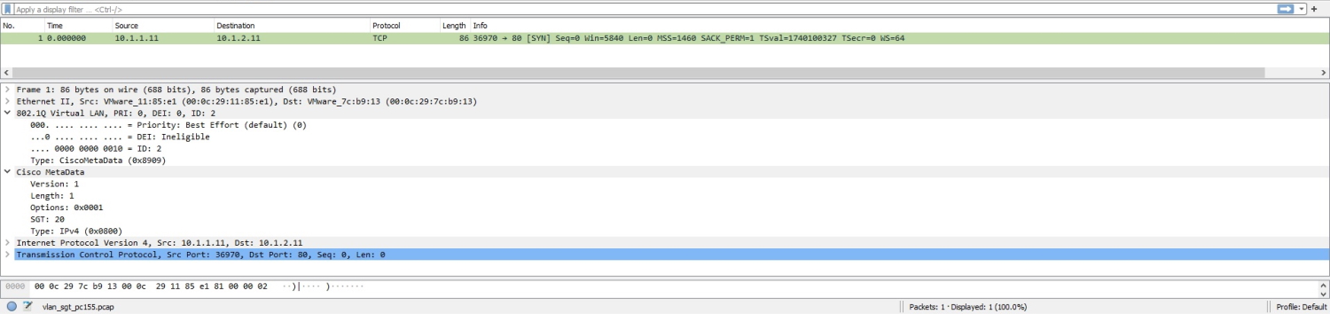

Processing Ethernet frames with a Cisco Security Group Tag and VLAN tag
The FortiGate has the ability to process Ethernet frames with both the Cisco Security Group Tag and VLAN tag.
In this example, PC02 is connected to a switch port configured for VLAN 2. An Ethernet frame is sent from PC02 with an SGT tag (ID 20) and VLAN ID (2), which can pass through to PC05 based on any of the firewall policies in the previous examples.
To verify the configuration:
Check the session list:
# diagnose sys session list session info: proto=6 proto_state=01 duration=2007 expire=3482 timeout=3600 flags=00000000 socktype=0 sockport=0 av_idx=0 use=3 origin-shaper= reply-shaper= per_ip_shaper= class_id=0 ha_id=0 policy_dir=0 tunnel=/ vlan_cos=0/0 state=may_dirty br statistic(bytes/packets/allow_err): org=164/3/1 reply=120/2/1 tuples=2 tx speed(Bps/kbps): 0/0 rx speed(Bps/kbps): 0/0 orgin->sink: org pre->post, reply pre->post dev=8->7/7->8 gwy=0.0.0.0/0.0.0.0 hook=pre dir=org act=noop 10.1.1.11:36970->10.1.2.11:80(0.0.0.0:0) hook=post dir=reply act=noop 10.1.2.11:80->10.1.1.11:36970(0.0.0.0:0) pos/(before,after) 0/(0,0), 0/(0,0) misc=0 policy_id=1 pol_uuid_idx=572 auth_info=0 chk_client_info=0 vd=0 serial=0432fb8f tos=ff/ff app_list=0 app=0 url_cat=0 rpdb_link_id=00000000 ngfwid=n/a vlanid=2 npu_state=0x4000001 no_offload no_ofld_reason: disabled-by-policy ext_header_type=0xc5:0xc5 -
Perform a packet capture on PC05 (Wireshark is used in this example) and check that the packet includes the VLAN ID and Cisco SGT fields.
