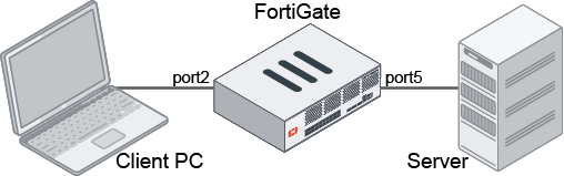

In these examples, port2 and port5 are in a virtual wire pair. Firewall policies are created that pass traffic with SGTs with a specific ID number, any ID number, or either of two specific ID numbers.
To configure the virtual wire pair:
config system virtual-wire-pair
edit "test-vwp-1"
set member "port5" "port2"
set wildcard-vlan enable
