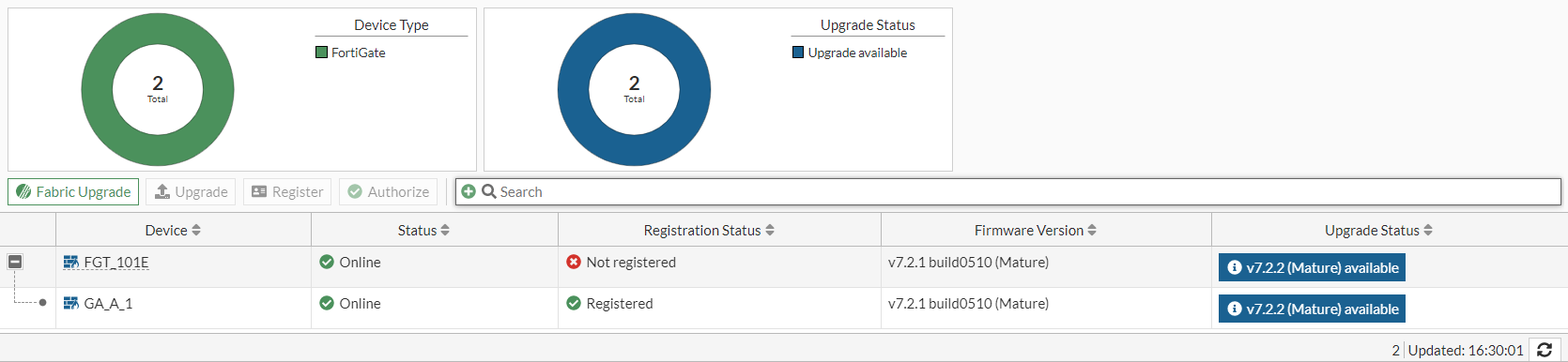

In this example, the Security Fabric consists of a root FortiGate (FGT_101E) and a downstream FortiGate (GA_A_1). The FortiGates are currently running FortiOS 7.2.1 (build 0510). The administrator wants to upgrade the firmware to version 7.4.0 (build 0810). When upgrading the firmware on the Firmware & Registration page, the FortiGate is able to display the upgrade path, 7.2.1 > 7.2.2 > 7.4.0, and perform all of the upgrades in sequence (with multiple reboots).

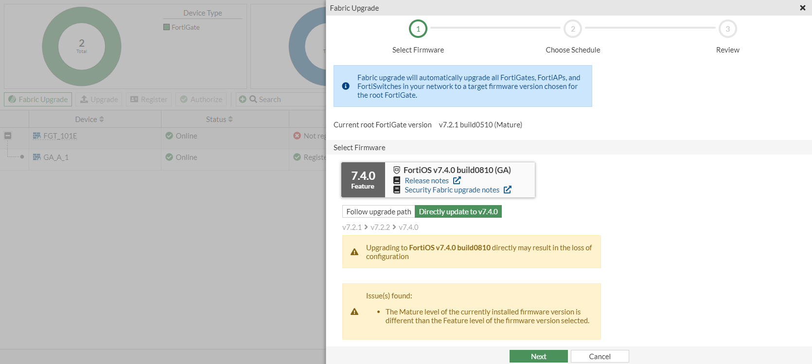

- Select the 7.4.0 version. Upgrade options appear.

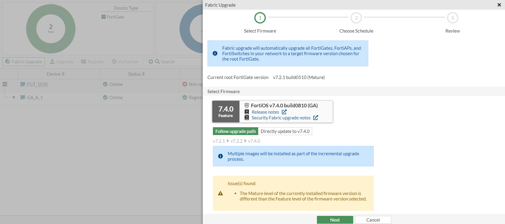

- Select Follow upgrade path. The upgrade path is displayed: v7.2.1 > v7.2.2 > v7.4.0.
- If Directly upgrade to v7.4.0 is selected, a warning message appears that this may result in the loss of configuration.

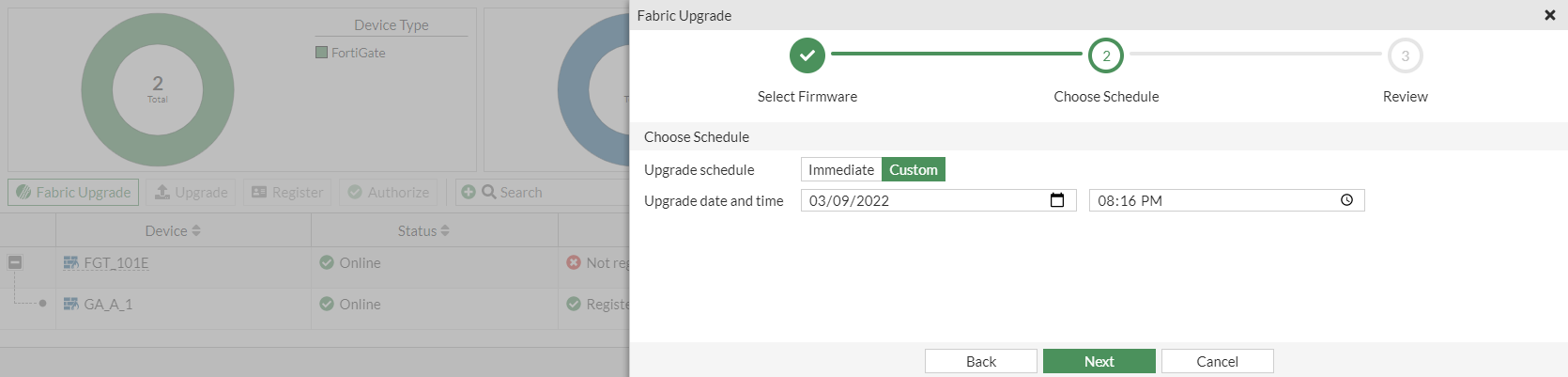

Select an upgrade schedule, either Immediate or Custom. If using Custom, enter an upgrade date and time. (Custom is used in this example.)

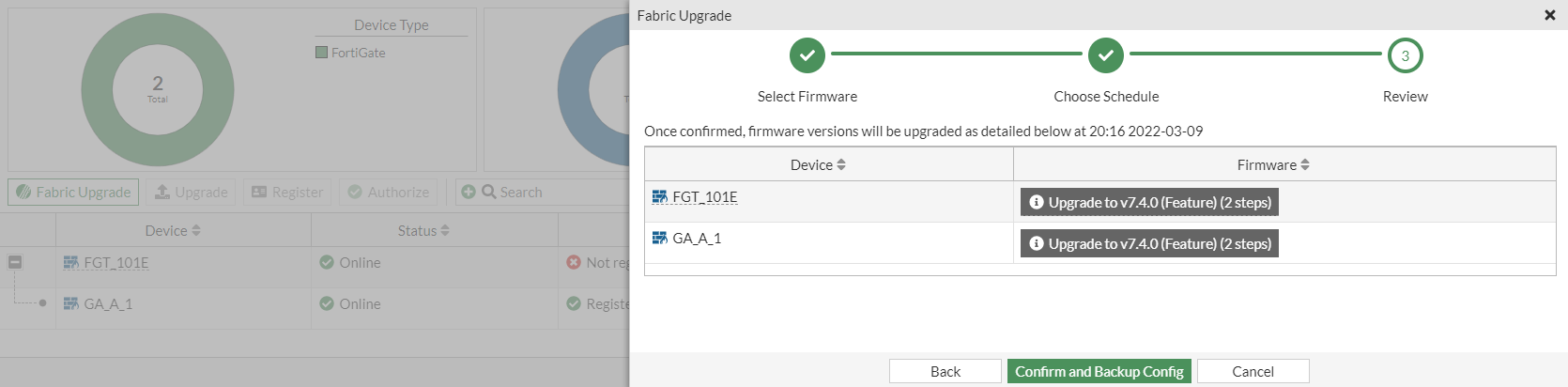

Click Next and review the update schedule.
Click Confirm and Backup Config.

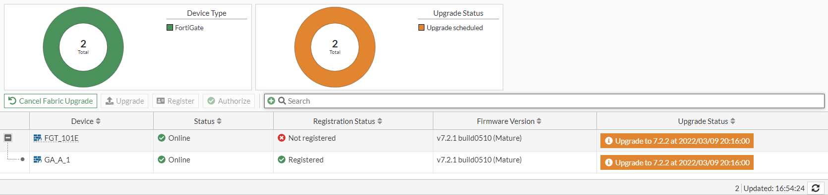

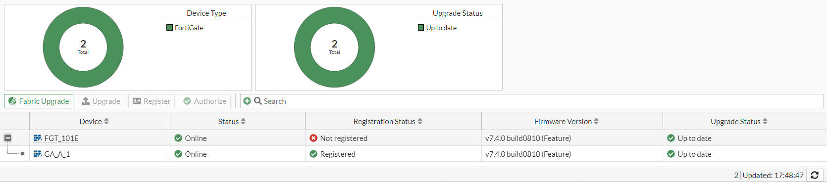

The Upgrade Status for both FortiGates indicated when the scheduled upgrade will take place. In this example, the first upgrade in the path is to version 7.2.2. The FortiGates will reboot and then upgrade to 7.4.0 as per the upgrade path.
Once the upgrades are complete and both FortiGates are running the desired firmware (7.4.0), the Upgrade Status changes to Up to date.
