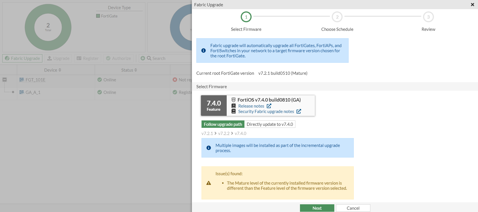

  1. Go to System > Fabric Management and click Fabric Upgrade. The Fabric Upgrade pane opens.
  2. In the Select Firmware section, select All Upgrades.
  3. Select the 7.4.0 version. Upgrade options appear.
  4. Select Follow upgrade path. The upgrade path is displayed: v7.2.1 > v7.2.2 > v7.4.0.
    • If Directly upgrade to v7.4.0 is selected, a warning message appears that this may result in the loss of configuration.
  5. Click Next.

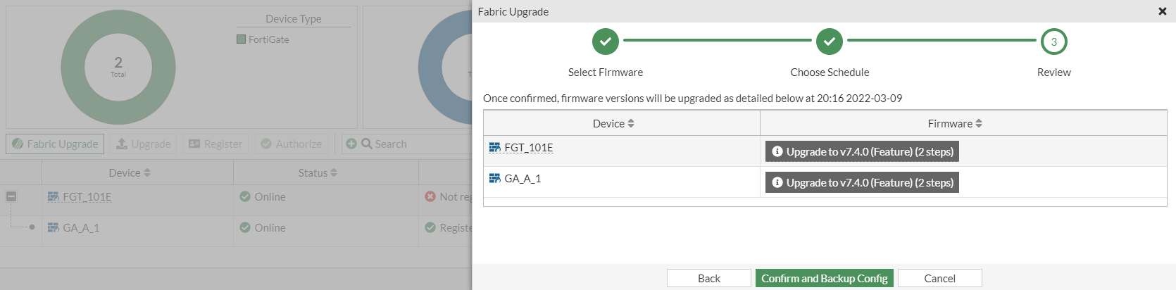

  6. Select an upgrade schedule, either Immediate or Custom. If using Custom, enter an upgrade date and time. (Custom is used in this example.)
  7. Click Next and review the update schedule.
  8. Click Confirm and Backup Config.

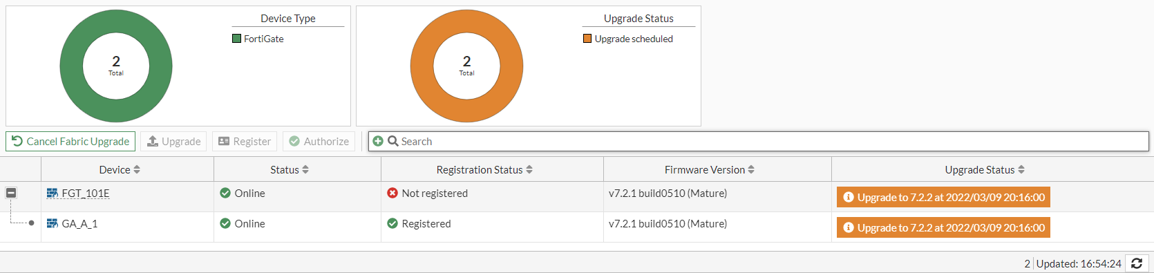

    The Upgrade Status for both FortiGates indicated when the scheduled upgrade will take place. In this example, the first upgrade in the path is to version 7.2.2. The FortiGates will reboot and then upgrade to 7.4.0 as per the upgrade path.

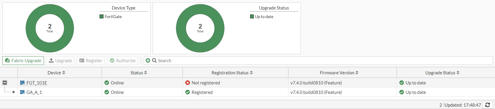

    Once the upgrades are complete and both FortiGates are running the desired firmware (7.4.0), the Upgrade Status changes to Up to date.
  5. Click Next.
