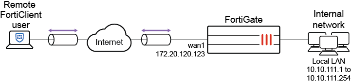

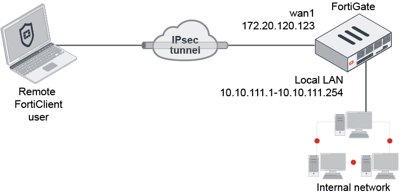

This is a sample configuration of dialup IPsec VPN with FortiClient as the dialup client.
You can configure dialup IPsec VPN with FortiClient as the dialup client using the GUI or CLI.
If multiple dialup IPsec VPNs are defined for the same dialup server interface, each phase1 configuration must define a unique peer ID to distinguish the tunnel that the remote client is connecting to. When a client connects, the first IKE message that is in aggressive mode contains the client's local ID. FortiGate matches the local ID to the dialup tunnel referencing the same Peer ID, and the connection continues with that tunnel.
