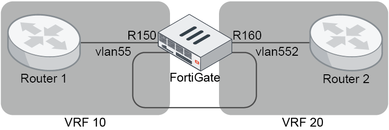

Using a VRF leak on BGP
In this example, the route 2000:5:5:5::/64 learned from Router 1 is leaked to VRF 20 through the interface vlan552. Conversely, the route 2009:3:3:3::/64 learned from Router 2 is leaked to VRF 10 through interface vlan55.
To configure VRF leaking in BGP:
- Configure the BGP neighbors:
config router bgp set as 65412 config neighbor edit "2000:10:100:1::1" set activate disable set remote-as 20 set update-source "R150" next edit "2000:10:100:1::5" set activate disable set soft-reconfiguration enable set interface "R160" set remote-as 20 next end end - Configure the VLAN interfaces:
config system interface edit "vlan55" set vdom "root" set vrf 10 set ip 55.1.1.1 255.255.255.0 set device-identification enable set role lan set snmp-index 51 config ipv6 set ip6-address 2000:55::1/64 end set interface "npu0_vlink0" set vlanid 55 next edit "vlan552" set vdom "root" set vrf 20 set ip 55.1.1.2 255.255.255.0 set device-identification enable set role lan set snmp-index 53 config ipv6 set ip6-address 2000:55::2/64 end set interface "npu0_vlink1" set vlanid 55 next end - Configure the IPv6 prefixes:
config router prefix-list6 edit "1" config rule edit 1 set prefix6 2000:5:5:5::/64 unset ge unset le next end next edit "2" config rule edit 1 set prefix6 2009:3:3:3::/64 unset ge unset le next end next end - Configure the route maps:
config router route-map edit "from106" config rule edit 1 set match-ip6-address "1" next end next edit "from206" config rule edit 1 set match-ip6-address "2" next end next end - Configure the IPv6 route leaking (leak route 2000:5:5:5::/64 learned from Router 1 to VRF 20, then leak route 2009:3:3:3::/64 learned from Router 2 to VRF 10):
config router bgp config vrf6 edit "10" config leak-target edit "20" set route-map "from106" set interface "vlan55" next end next edit "20" config leak-target edit "10" set route-map "from206" set interface "vlan552" next end next end end
