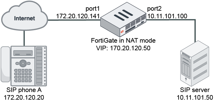

VIP
A FortiGate with SIP Application Layer Gateway (ALG) or SIP session helper protects the SIP server from the internet, while SIP phones from the internet need to register to the SIP server and establish calls through it.
A VIP needs to be configured for the SIP server, and the VIP must be applied in a firewall policy for the phones to send REGISTER messages through the FortiGate from port1 to port2.
Only one firewall policy needs to be configured for all SIP phones on both the internet and private network to register to the SIP server through port1 and set up SIP calls. This example assumes either SIP ALG or SIP session helper is enabled.
To configure the VIP for the SIP server:
config firewall vip
    edit "VIP_for_SIP_Server"
        set extip 172.20.120.50
        set extintf "port1"
        set mappedip "10.11.101.50"
To configure the firewall policy:
config firewall policy
        set srcintf "port1"
        set dstintf "port2"
        set srcaddr "all"
        set dstaddr "VIP_for_SIP_Server"
        set service "SIP"
Tooltip
Setting service to SIP and not all in the firewall policy can improve protection by restricting the data traffic passing through the FortiGate to the SIP call traffic only.

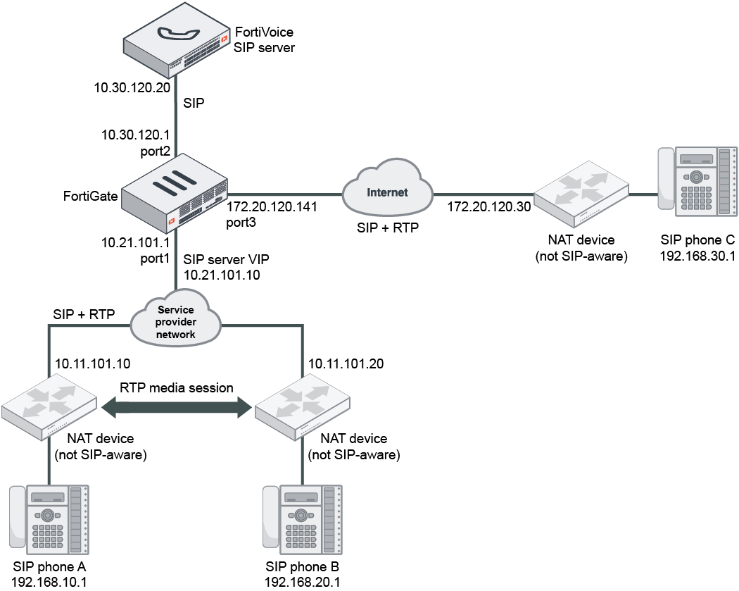

HNT
A FortiGate with SIP ALG protects the SIP server from the internet, while SIP phones are in remote private networks behind NAT devices that are not aware of the SIP application.
In this example, the SIP server is located in an ISP's service cloud that is protected by the FortiGate SIP ALG, and the SIP phones are installed in the home networks of the ISP's customers.
The SIP messages traversing the remote NAT devices might have their IP addresses translated by the NAT device at the network layer, but untranslated at the SIP application layer because those NAT devices are not aware of the SIP applications. This causes problems in a SIP session initiated process. Special configurations for the hosted NAT traversal (HNT) are required to resolve this issue.
To configure the FortiGate with HNT support for SIP phones A and B to set up calls with each other:
  1. Identify port1 as the external interface:
    config system interface
        edit "port1"
            set external enable
  2. Configure the VIP for the SIP server:
    config firewall vip
            set extip 10.21.101.10
            set extintf "port1"
            set mappedip "10.30.120.20"
  3. Configure a VoIP profile with HNT enabled:
    config voip profile
        edit "hnt"
            config sip
                set hosted-nat-traversal enable
                set hnt-restrict-source-ip enable
    hosted-nat-traversal must be enabled. hnt-restrict-source-ip does not have to be enabled, but can be enabled to restrict the RTP packets’ source IP to be the same as the SIP packets’ source IP.
  4. Apply the VoIP profile and VIP in a firewall policy for phone A and B to register and set up SIP calls through the FortiGate and SIP server:
            set srcintf "port1"
            set dstintf "port2"
            set srcaddr "all"
            set service "SIP"
            set utm-status enable
            set voip-profile "hnt"
            set nat enable
    nat must be enabled in the firewall policy.

VIP
config firewall vip
        set extintf "port1"
        set srcintf "port1"
        set dstintf "port2"
        set srcaddr "all"
        set service "SIP"
Tooltip

HNT
        edit "port1"
            set external enable
    config firewall vip
            set extintf "port1"
    config voip profile
        edit "hnt"
            config sip
            set srcintf "port1"
            set dstintf "port2"
            set srcaddr "all"
            set service "SIP"
            set nat enable
