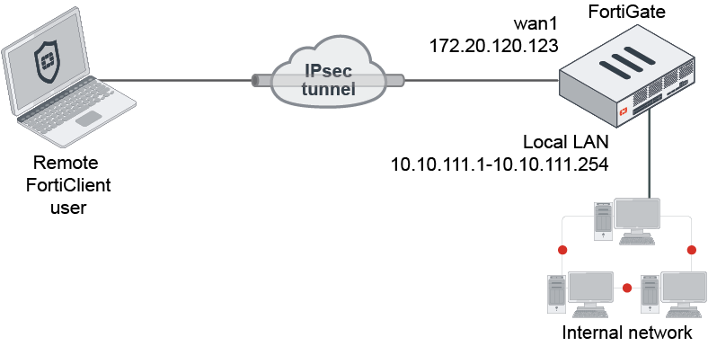

This is a sample configuration of dialup IPsec VPN with FortiClient as the dialup client.
You can configure dialup IPsec VPN with FortiClient as the dialup client using the GUI or CLI.

config user local edit "vpnuser1" set type password set passwd your-password next end config user group edit "vpngroup" set member "vpnuser1" next end - Configure the internal interface. The LAN interface connects to the corporate internal network. Traffic from this interface routes out the IPsec VPN tunnel. Creating an address group for the protected network behind this FortiGate causes traffic to this network group to go through the IPsec tunnel.
config system interface edit "lan" set vdom "root" set ip 10.10.111.1 255.255.255.0 next end config firewall address edit "local_subnet_1" set subnet 10.10.111.0 255.255.255.0 next edit "local_subnet_2" set subnet 10.10.112.0 255.255.255.0 next end config firewall addrgrp edit "local_network" set member "local_subnet_1" "local_subnet_2" next end - Configure the WAN interface. The WAN interface is the interface connected to the ISP. It can work in static mode (as shown in this example), DHCP, or PPPoE mode. The IPsec tunnel is established over the WAN interface.
config system interface edit "wan1" set vdom "root" set ip 172.20.120.123 255.255.255.0 next end - Configure the client address pool. You must create a firewall address to assign an IP address to a client from the address pool.
